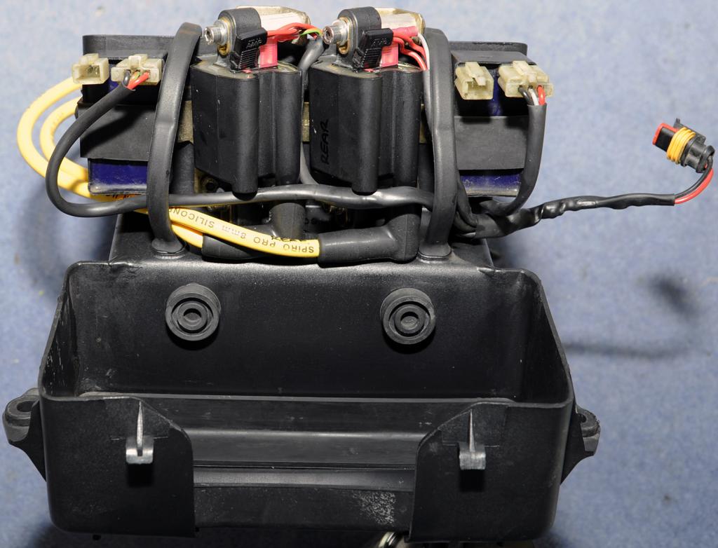

  7. Heres what I did with mine, Dyna Mini coils from SPR racing , Taylor HT leads from Ebay, all fit very neatly on std coil mounts :) Dyna Coils 72dpi.jpg
  8. nice one si, are they the single output .3 or .5 ohm coils?
    oh and how much did they sting you for? :upyeah:
  9. They are DC3-2 3 Ohm Miniature Single Output , I cant find the invoice but they were very reasonable at SPR £130-150 from Memory
