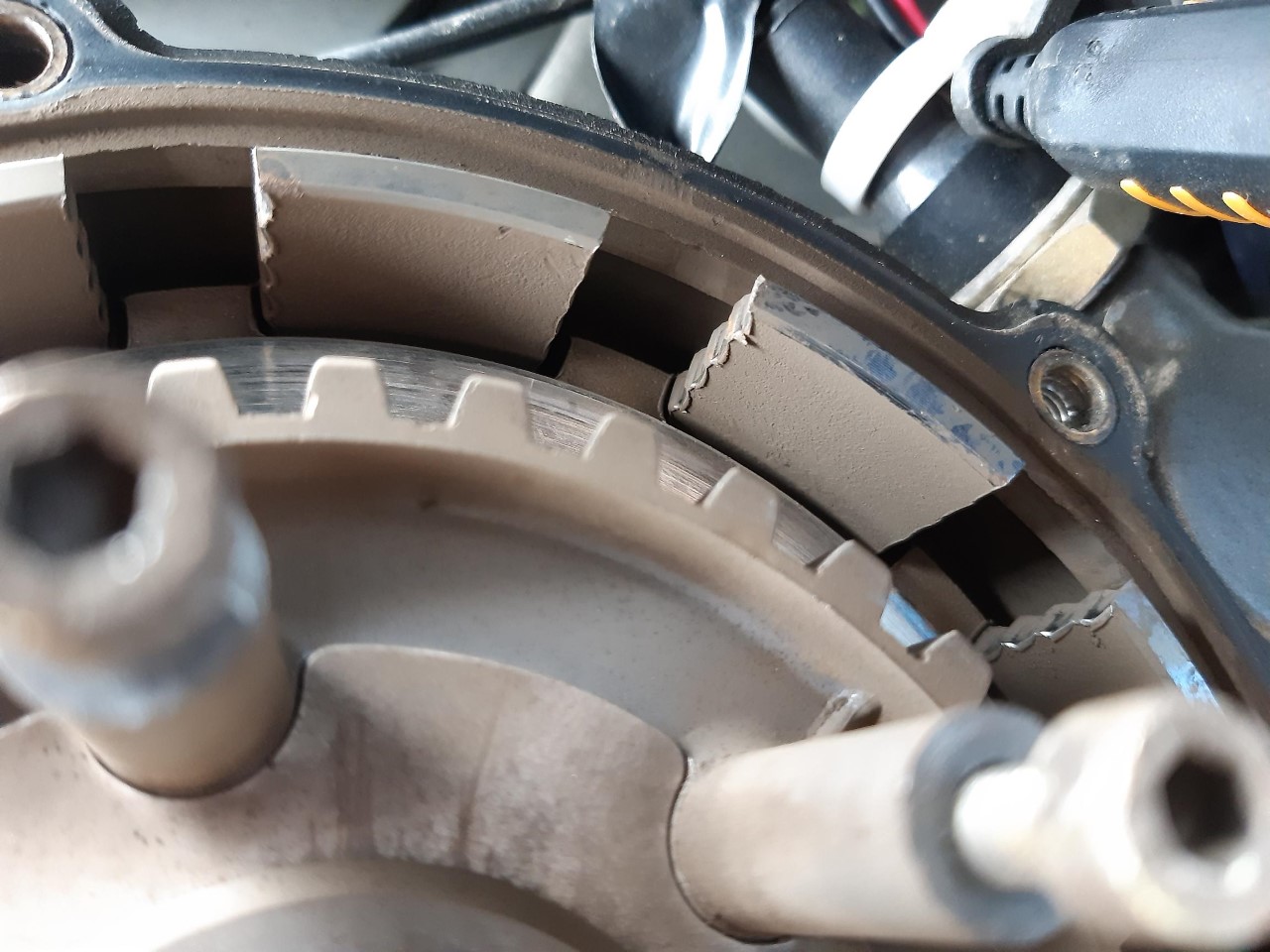

  1. It's been suggested that I can clean up the plates and remove burs on the basket (pics attached) and that should result in a few more miles, which I might do - if only to familiarise myself with the bike. However, the aim is to replace the clutch (plates and basket) within a couple of months - any advice on sources of clutch parts that won't sting me too much?
    Thanks.
  2. Removing the burrs will do nothing imho. That is a pretty worn clutch basket. Difficult to clean the scallops out accurately without machining, which would be expensive, and then you'd have some really loud dry clutch rattle unless you fitted plates with oversize tangs.
    In all honesty, I think your only solution is to replace.

  19. Hi Geoffrey, you were right. I stripped the clutch cleaned up all the plates/basket and reassembled which made absolutely no difference (but I am now so much more familiar with my clutch!). Pack height was 35mm so 1mm below the minimum, which is my problem. New clutch now ordered... do you happen to know torque setting on central 32mm nut?
