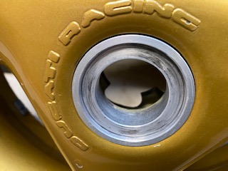

    I went to fit the new rear, and the odd thing is that the conical spacer - doesn't seem to sit right in the wheel. Now maybe its the fact that the wheel has powder coating on the seating face (which @900theginge said I should probably remove).
    A) Is it OK to use this spacer or do I need a different one? it wont go flush into the wheel like it does on the Brembo wheel.
    B) If I need to remove the powder coating, what's the best way to do it and avoid marking or chipping the rest?
    Thanks.

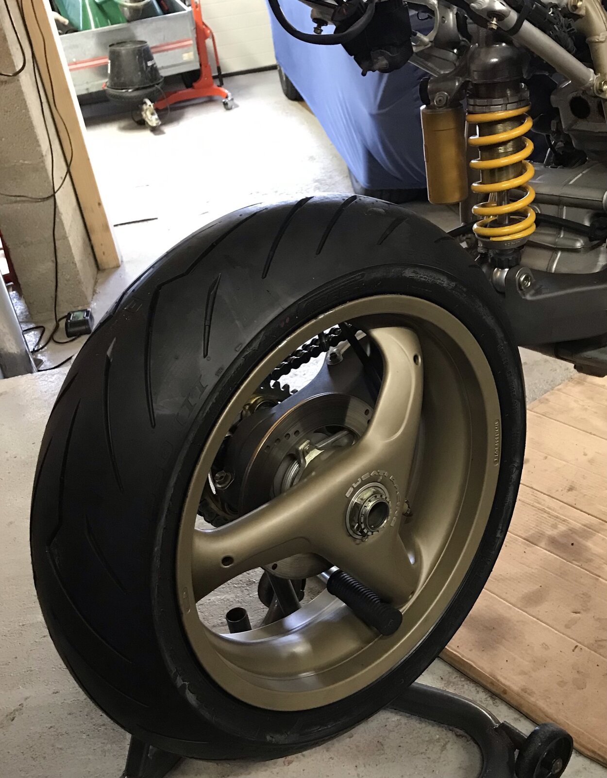

  3. I had 5 spoke magnesium Marchesinis on my 748 and 916. The rear wheel conical spacer was exactly as you have in your picture i.e. it did not sit flush in the wheel.
    I ran these bikes for approx 15 years in total with the spacer as shown. Not a problem.

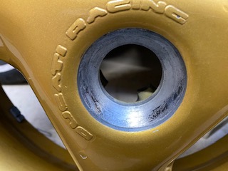

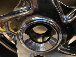

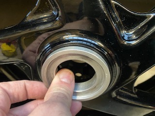

  14. I had to get the powder coating off my Marchesini Mags in the exact same spot not long ago. I did it because as Ricky mentioned, I didn’t want the coat to crack when torquing things up (190 n.m). I used a wire brush (plastic wires, not metal) on a driller, and worked slowly with extreme carefulness. Took me about 30 minutes and I got a perfect result.
    Before: A42A4EBC-8A51-4FAD-BC15-B6418119D1C7.jpeg
    After:

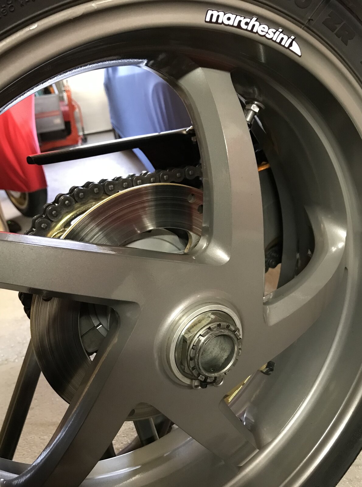

    As far as the conical washer/spacer position is concerned, just like you, it sits flush on the 3-spokes Brembos, and not so flush on the 5 spokes Mags, even with the coating removed from the contact area. Not a problem at all as it sits tight in the wheel well.
    With coating still on:
    With coating removed: 5D0E0D0F-10F1-40F0-A474-901D99F376AF.jpeg
    OEM Brembos:

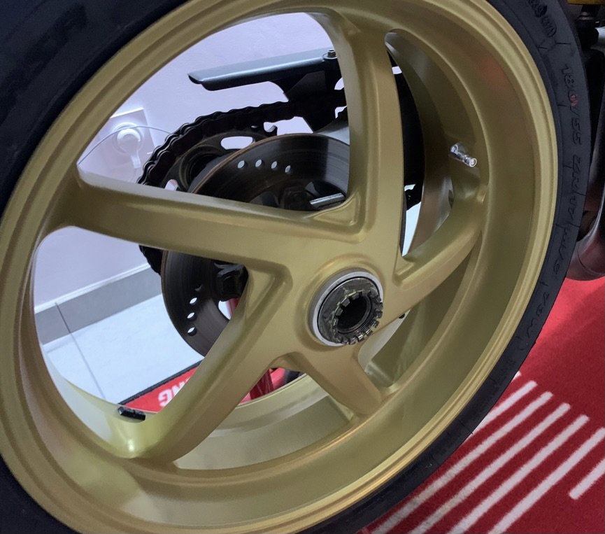

    Finally, and to make you feel completely at peace with this, here’s a picture of my 998 OEM 5-spokes forged Marchesini. It does not sit flush. ;)

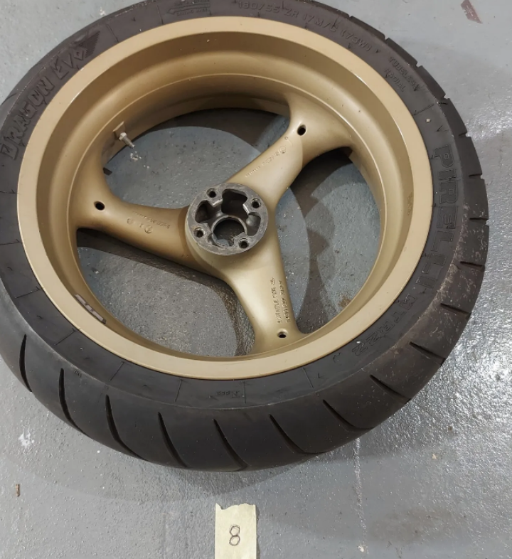

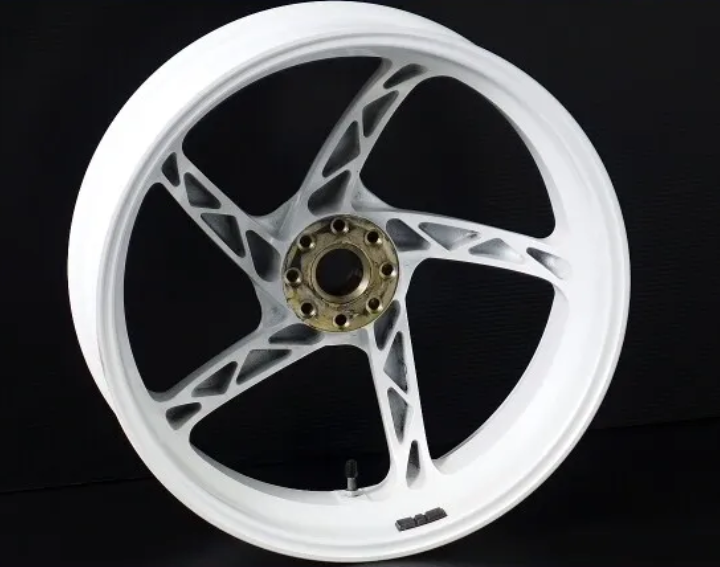

  15. If it's magnesium, the rear has 8 holes for the 4 drive pegs i.e. 2 positions. The aluminium ones only have 4 holes, 1 position.
    Aluminium, I know this isn't the marchesini wheel but the centre hub looks the same on the Ali wheel.
  17. Definitely have 8 peg holes.
