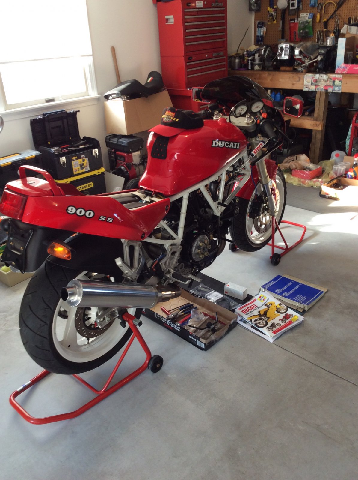

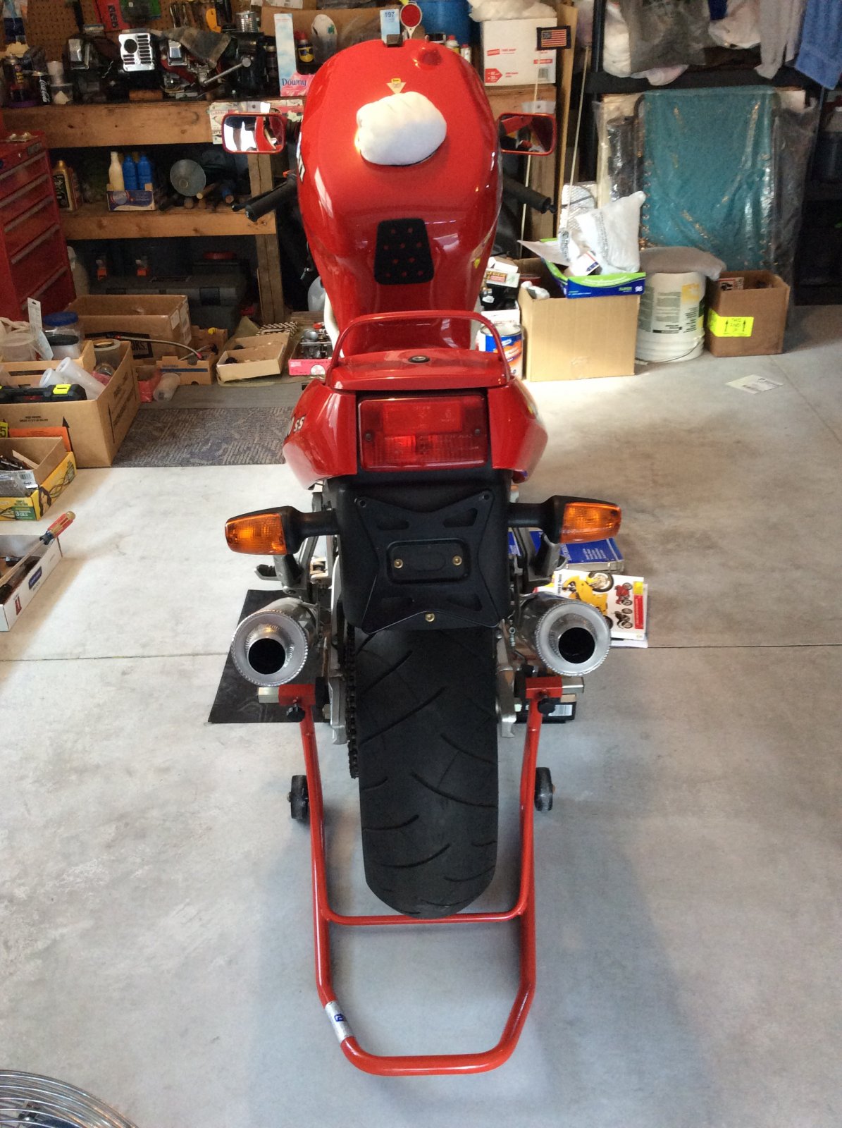

  1. I am new to this forum but not new to restorations. It has however been a while but latest project I restoring a ('91) 900SS that has been in storage for 15 yrs and only has 3,750 miles! I actually owned this bike new and sold it to a collector and now have it back. I have begun the front-to-rear disassembly starting with draining the oil, removing the OEM Mikuni (frozen up) carbs (disassembled and deep cleaned), fuel tank was drained and absent of rust, cam/timing belts, etc. if anyone has any advice or insights on these early 90's 900SS specific issues I should be especially looking for please let me know as I am open to all suggestions. This will not hopefully end up being an off-frame restoration (at least initially) as I want to get this beast running well enough to see just how everything does after all these years unattended. Thanks! -MacBulldog

  7. Welcome Dog :upyeah:

    Pics please it's the law :)

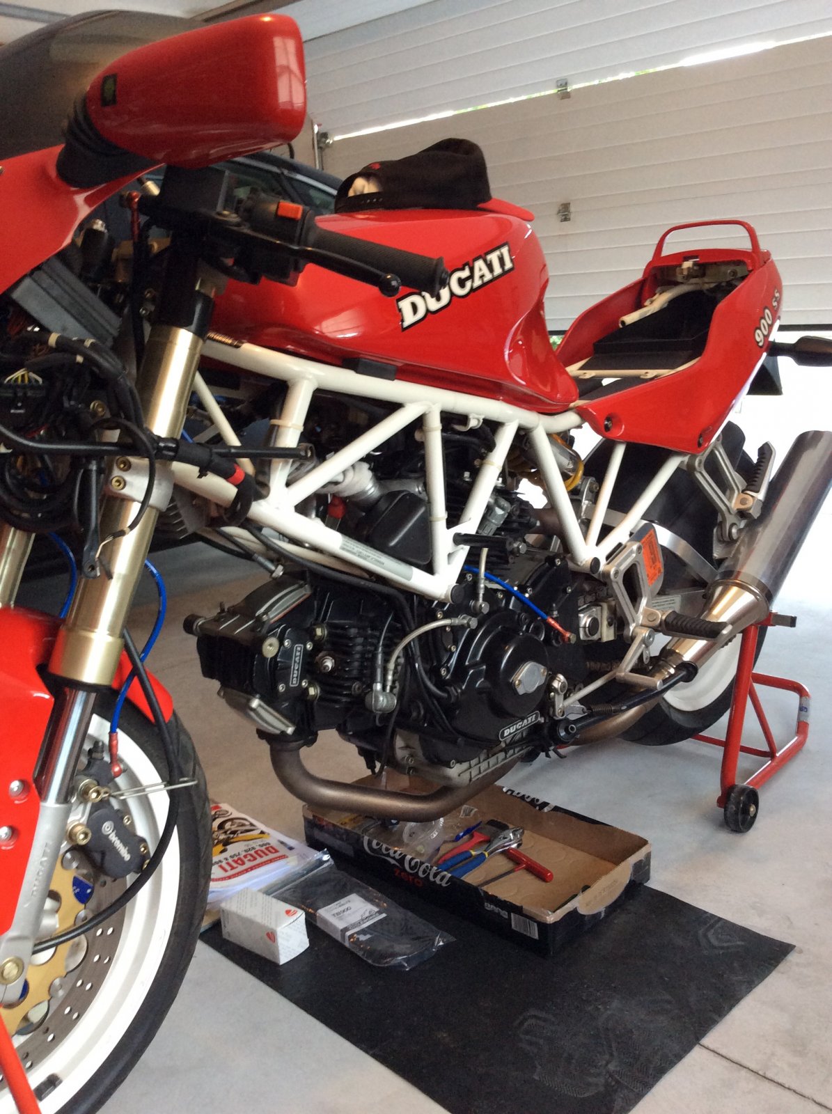

  11. The pic to the left and above my New Member name is a solo pic of my '91 900 SS project bike being stripped down for the restoration process...more to come.

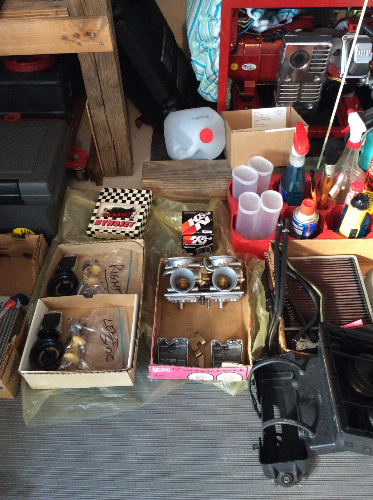

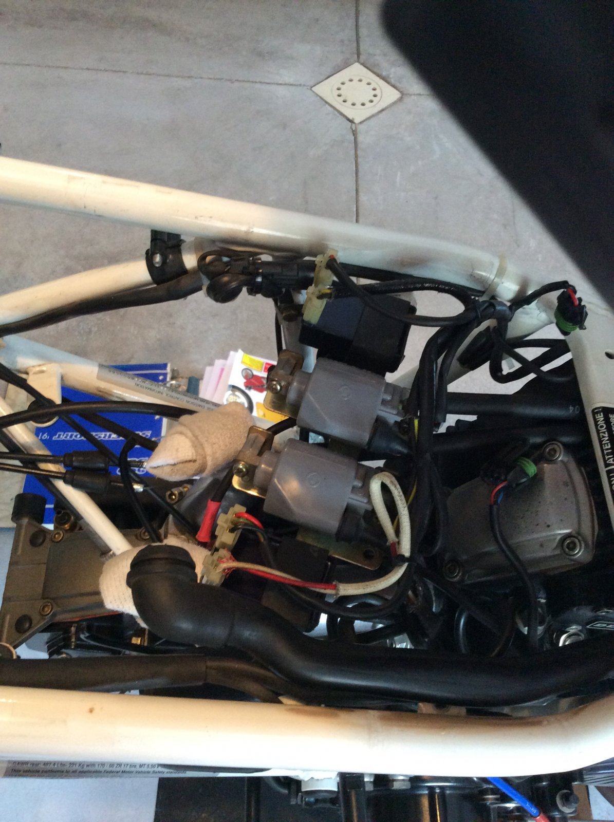

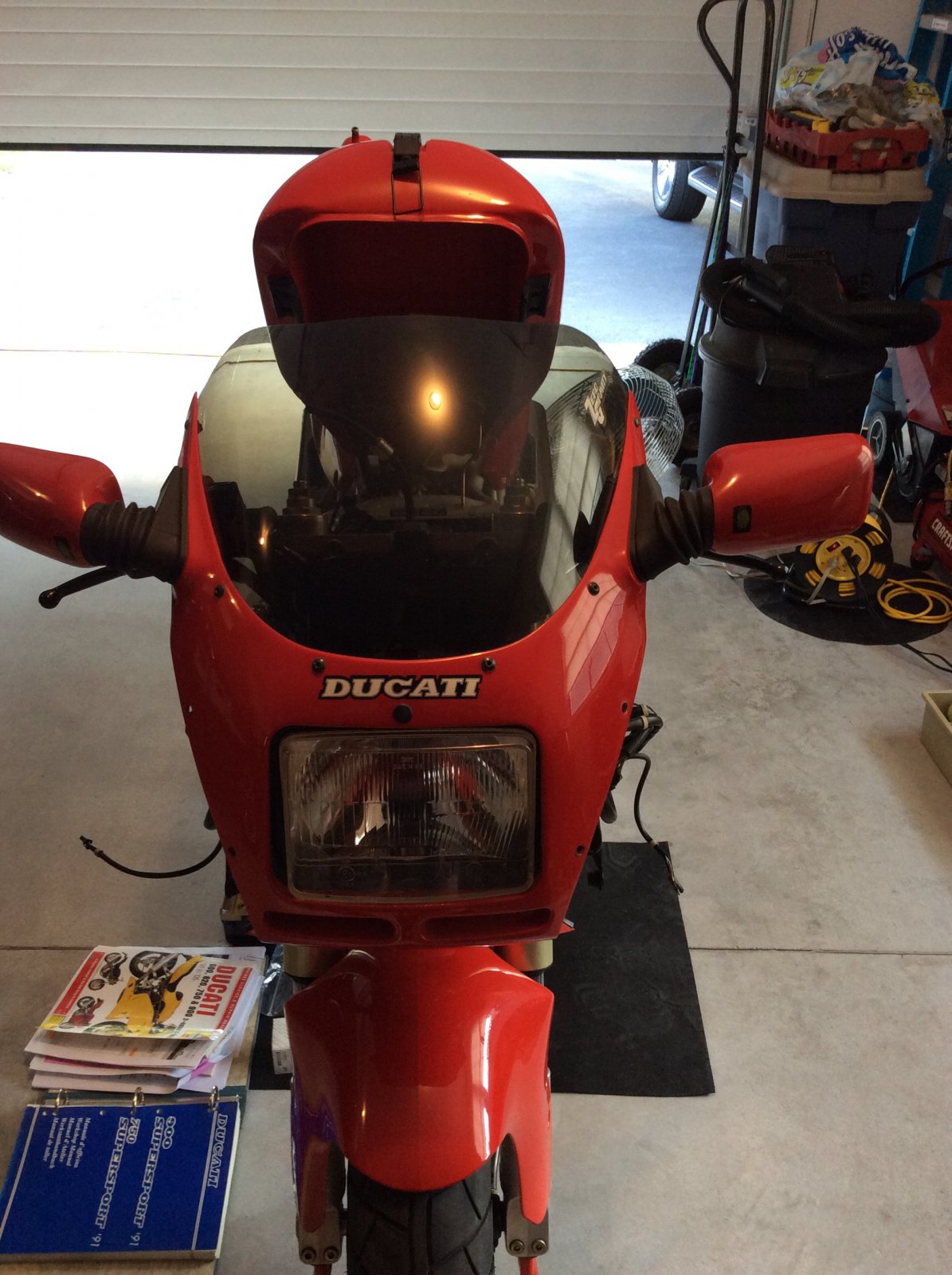

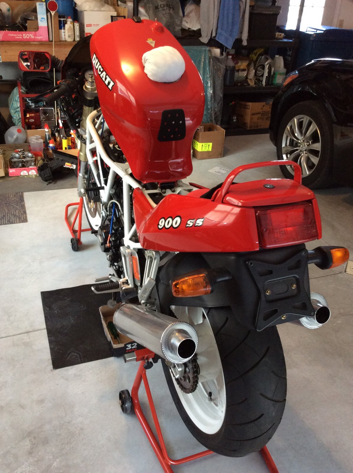

  12. Here are more pics of my '91 900 SS project bike. OEM carbs deep cleaned & ready for all new o-ring and jet kits; timing/cam belts ready for install; new fuel filter; replacement of all fuel lines; bleeding clutch & brakes; full fairings being restored (small stress fracture on upper and lower left faring); new plugs; more pics as I make progress. Tomorrow, I plan on continuing getting the OEM carbs back together (setting the float at 14 and doing a basic bench sync). I am not sure the rebuild effort on the OEM Mikunis will be fruitful so I am saving up for a pair of FCR's...experiences and suggestions on either the OEM Makunis and/or the FCR kits welcomed.

  15. Wow that's clean. Doesn't look like it needs much doing to it. I found the standard Mikunis to be a pain as they had been standing idle for a long time. Once I got them sorted out though they work well enough. I'm sure fcrs would improve the feel but I'm actually quite happy with the oem carbs. I've got a stage 2 dynojet kit in mine and it goes well enough. I'm not sure that with standard pistons that I would feel the cost of the fcrs was justified.
