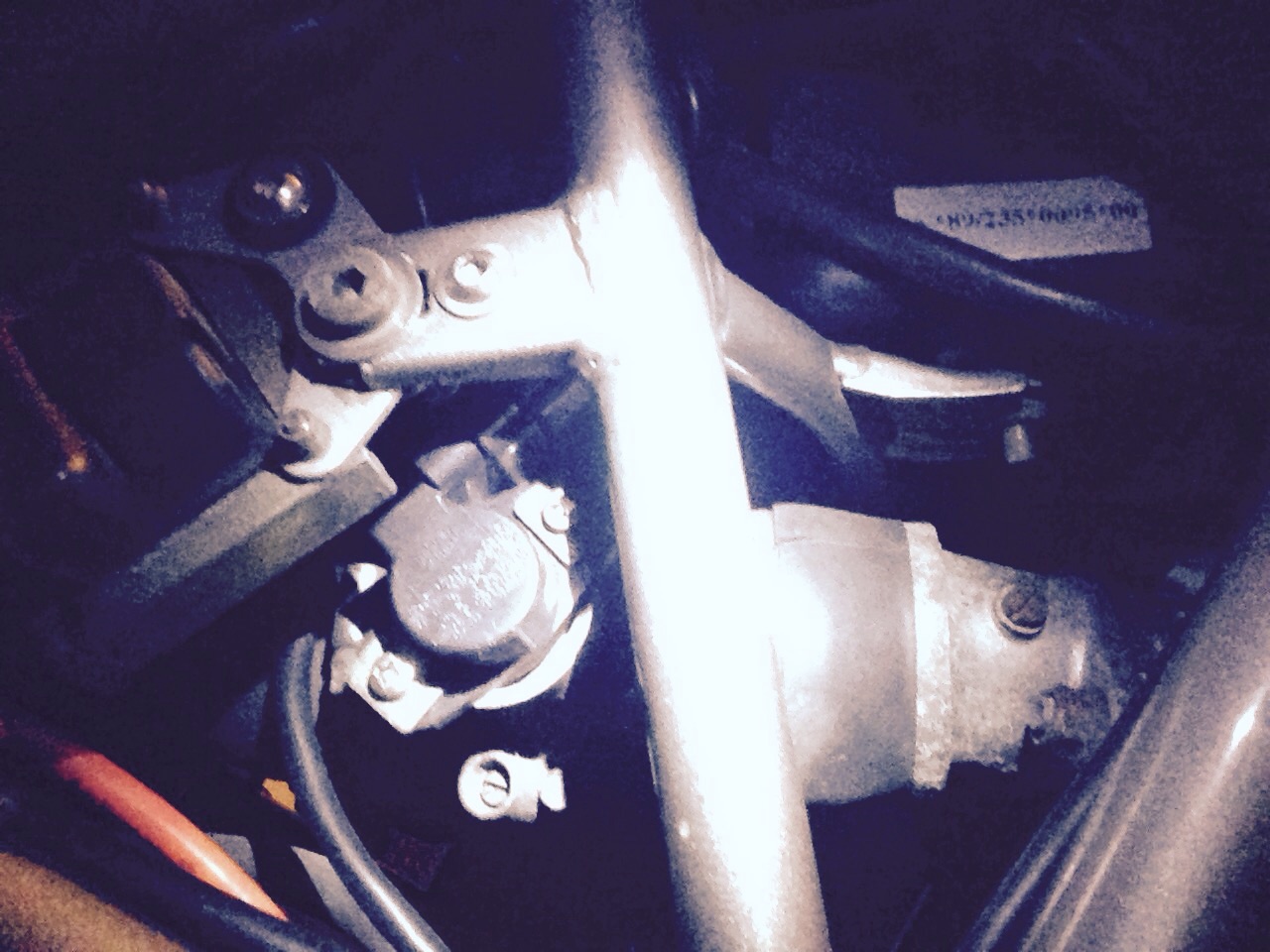

    Tps is LHS between cylinders. Just check its tight or hasnt broken. Once you move it you might have an extra problem.

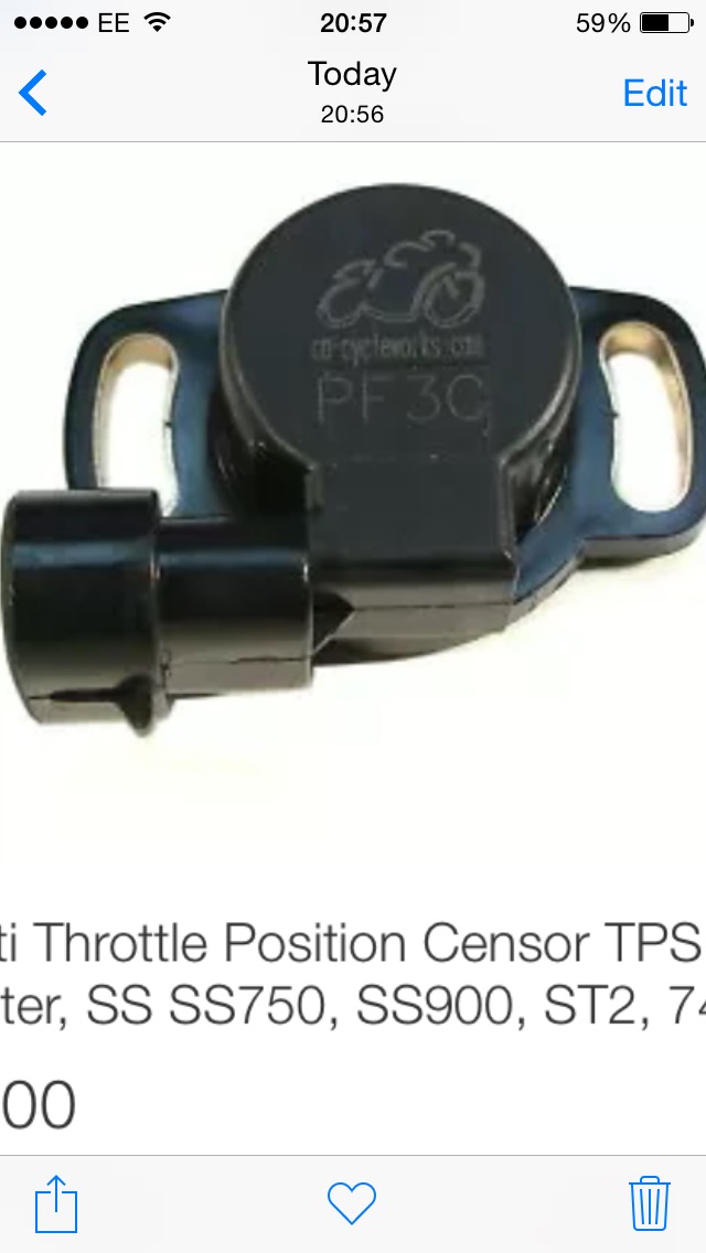

  16. Thank you Keith - damn, got nothing like it if that is how std unit looks - cycleworks - is that aftermarket type though? Mine look more like this
  17. A dying regulator would cause rough running too. Have you got 13.5ish volts at the battery motor running 2000rpm.
  18. Think original has magneti marelli on it but identical. ie has to have slotted screw hole type as they cant be adjusted by laptop.
  19. Mmmm, I wonder where you can get the California Cycleworks ones :Hilarious: they are the improved ones so I am led to believe - in fact I have sold a few to UK Ducati dealers over the last 2 months :Facepalm:
  20. well
    so come on then?!.. how much are you going to charge a fellow forum memba? :Facepalm:
