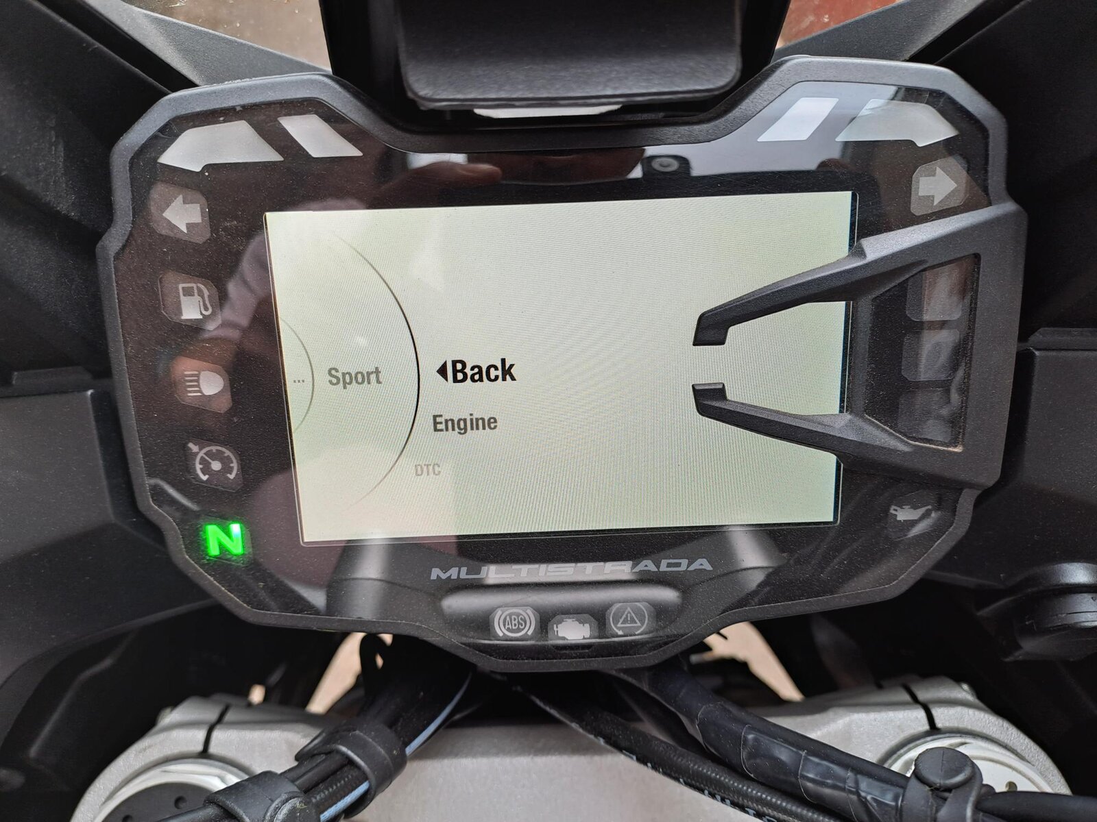

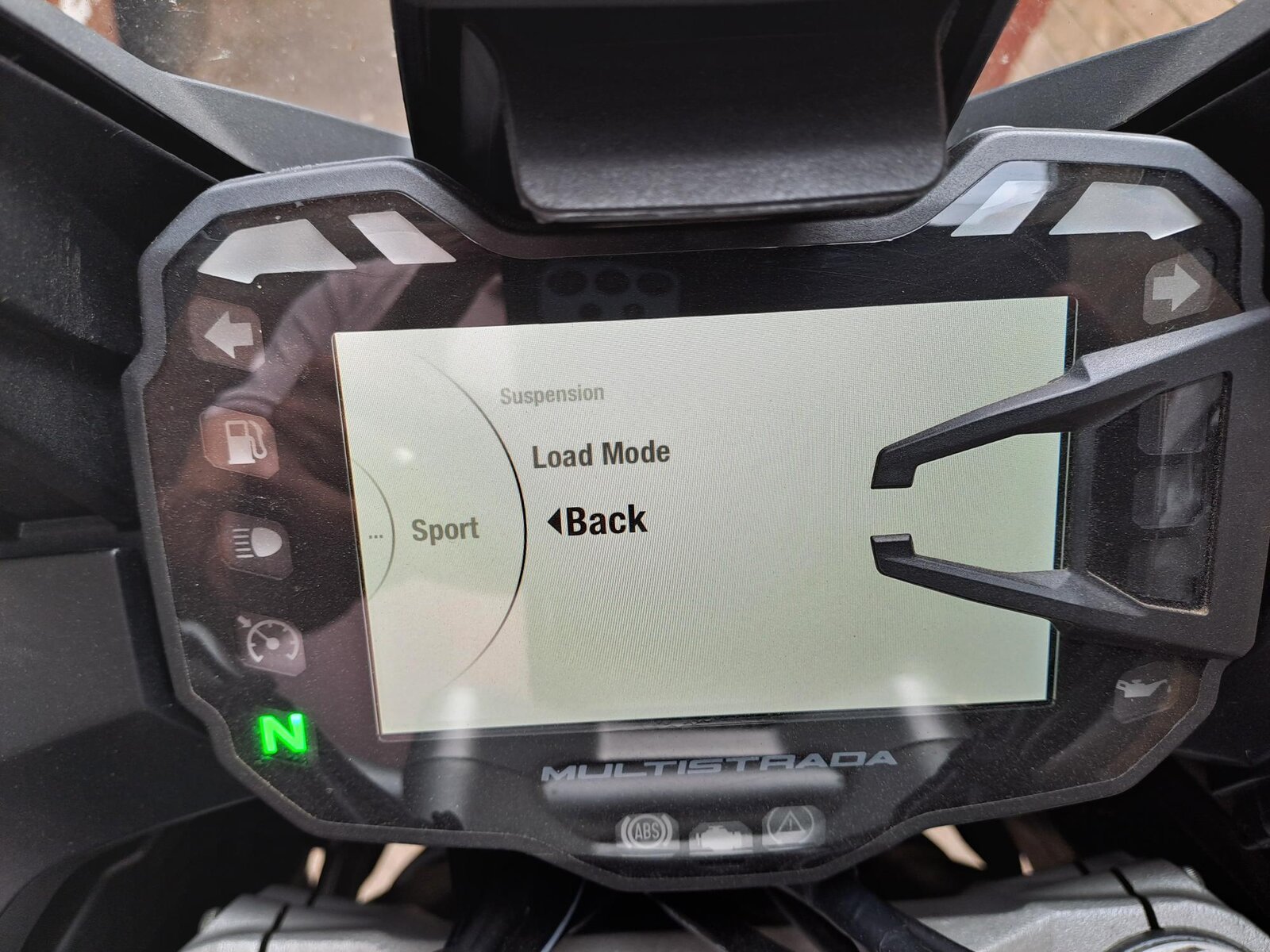

  14. Revisiting this Thread as I have just bought a Multistrada 1260S. I previously had a Hypermotard 1100 for 12 years. The Hypermotard didn't have any riding modes etc. Like the initial Thread starter I cannot get the riding mode to change.
    I have followed all the instructions in the manual and tried everything recommended on here previously.
    Once I'm in the Riding Mode menu and click on Sport when I scroll through the different options I only ever have the "Back" option at the top and bottom of the menu but no "Exit" as described in the manual. Therefore it just reverts back to Touring.
    PS: I have been riding on the roads for over 25 years and I am not a danger to myself or other road users.
  15. I think I know what you need to do which isn't immediately obvious - You can't change this whilst the bottom left of the dash shows settings. Scroll through to temp or something else - then go to menu using the left hand switch gear - scroll to the setting you want and then hold - then exit. It should stick . I found it on youtube .

  17. Thanks Mick.
    Eventually changed to SPORT.
    If anyone else reading this thread for a similar reason to me, to save you wasting time it has nothing to do with the indicator switch.
    All other settings are easy to adjust - Riding Mode is a different ball game.
