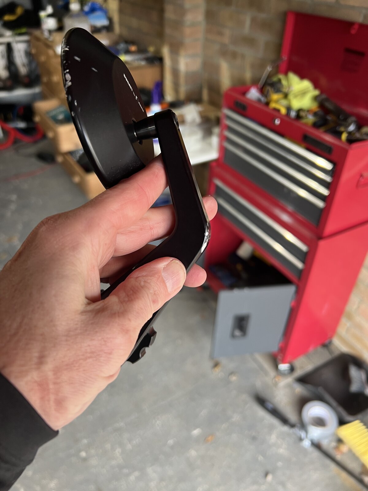

  1. Long story short, one of my Rizoma bar end mirrors fell off my bike today while out riding, got scratched up while bouncing down the road :mad: , anyone successfully repair scratches on these?

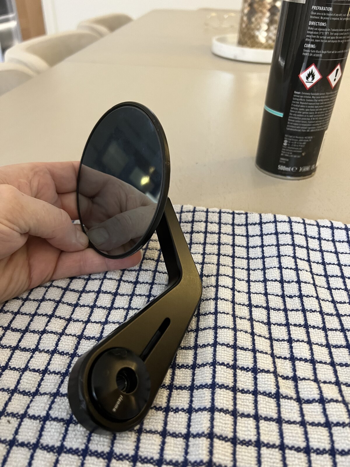

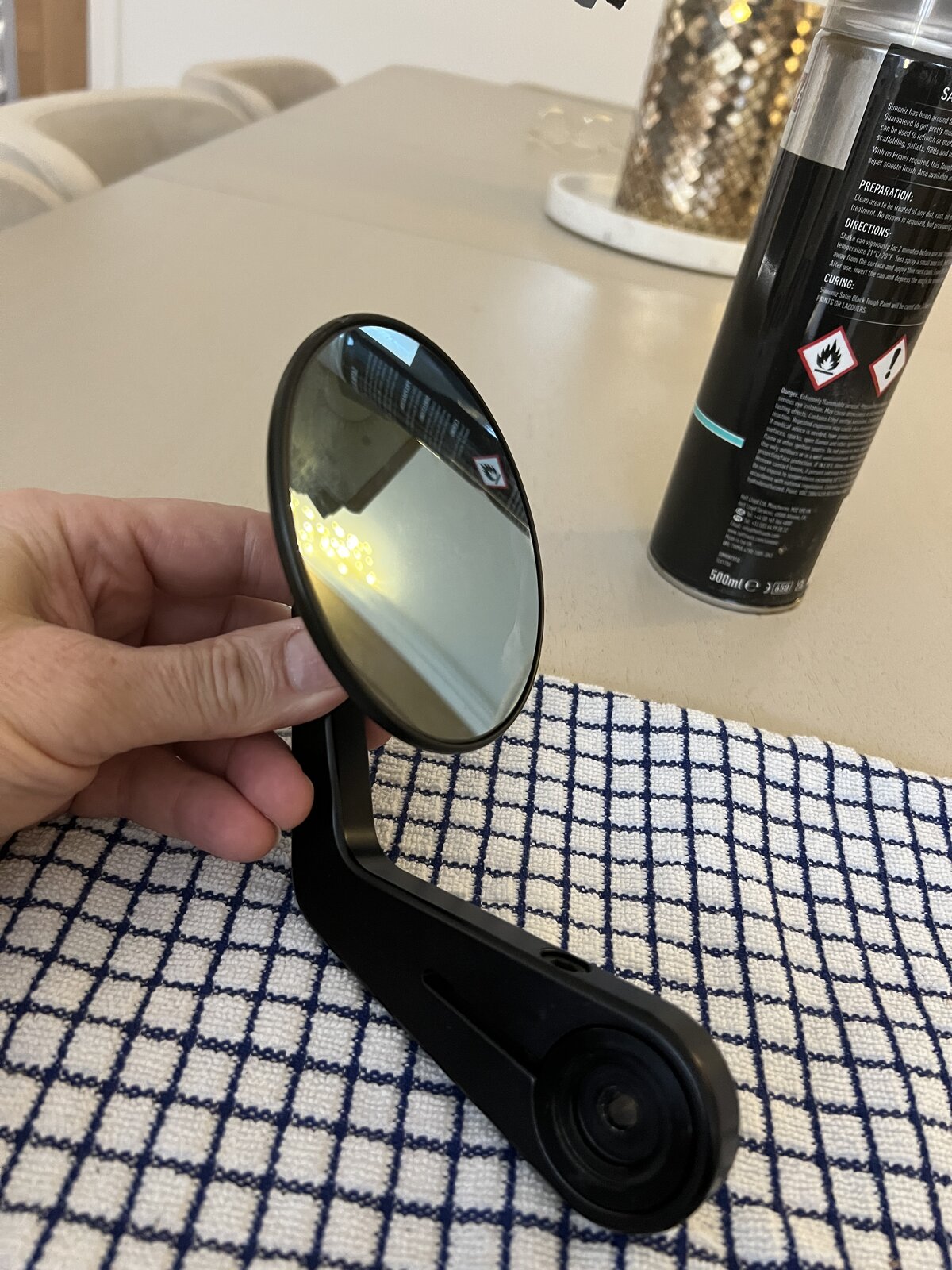

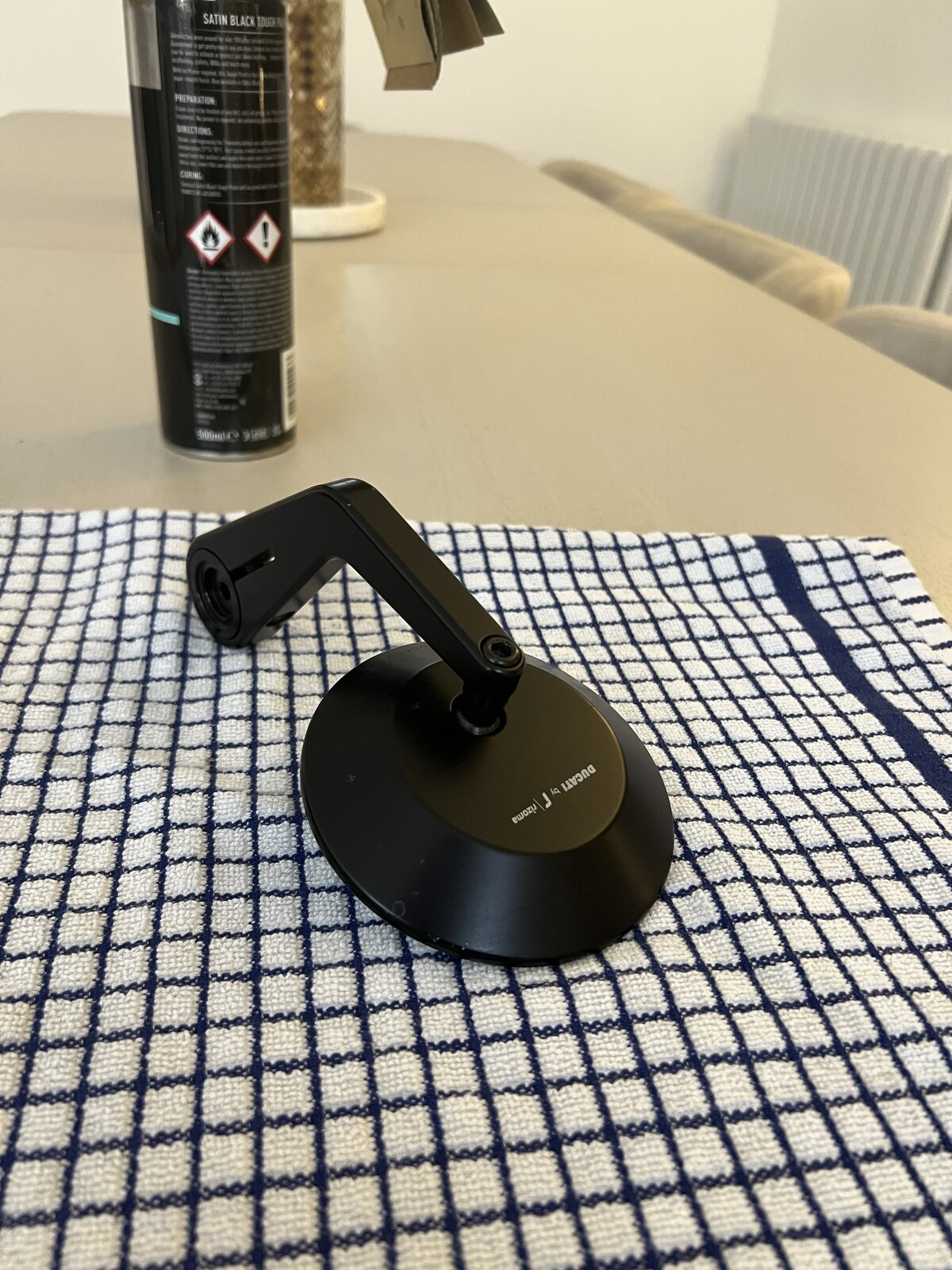

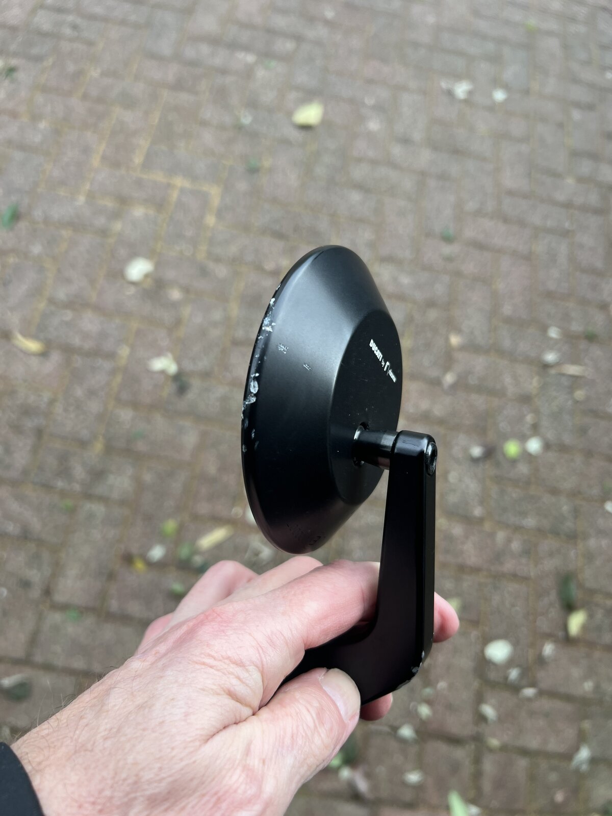

  8. They won’t come out well with paint as the surface is damaged. The only thing you can do is touch them up with paint or a marker. The only way to bring them back to new would be to get them machine polished once the anodising has been removed then to get them re anodised. Probs cheaper to buy new.
