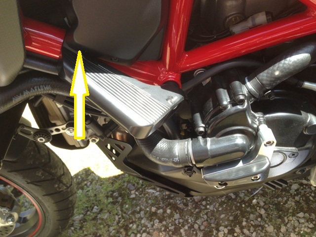

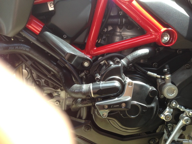

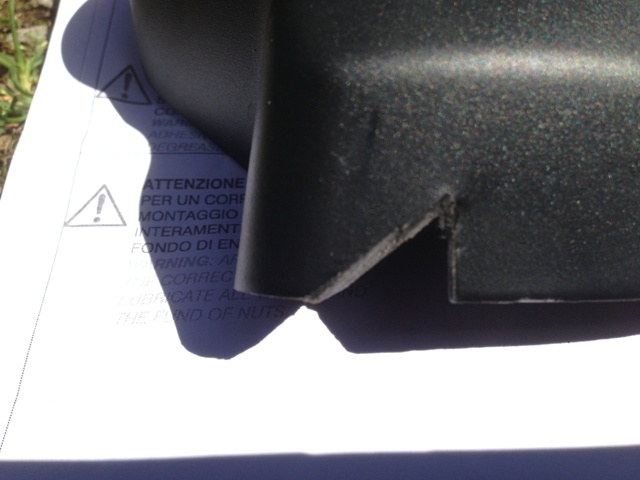

  1. Just fitted the Rizoma Engine Protectors and had to modify the coil cover as arrowed below otherwise the left hand protector wouldnt have gone on so be warned. Just need to nick out the bottom left hand corner of the coil cover, can't see it from above when fitted. IMG_1280a.jpg IMG_1283a.jpg IMG_1285a.jpg
  2. I was going to get these, are they any better than the R&G or other brands. They don't look like they come out very far.
  3. Had R&G's in the past and look just as good, will take a pic from the top tomorrow and post
  4. Jim, would they protect the gear selector in the event of a slow off? Ta! D.

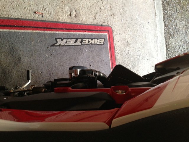

  5. Taken some pics from the top and tbh I doubt they would save anything! other than a topple over? lol Ah well they are fitted now. IMG_1300a.jpg IMG_1301a.jpg
  6. Im not convinced these will protect the tank? Would the tank be safe if this feel over whilst stopped?
  7. I doubt they will protect the tank even if it toppled over.
  8. Look good! But not very practical if it goes down...?
  9. Expensive piece of tat that. Plus you hacked lumps out of a perfectly good bike to enable it to fit.
  10. Yup on both counts but hey ho thats life :wink:
