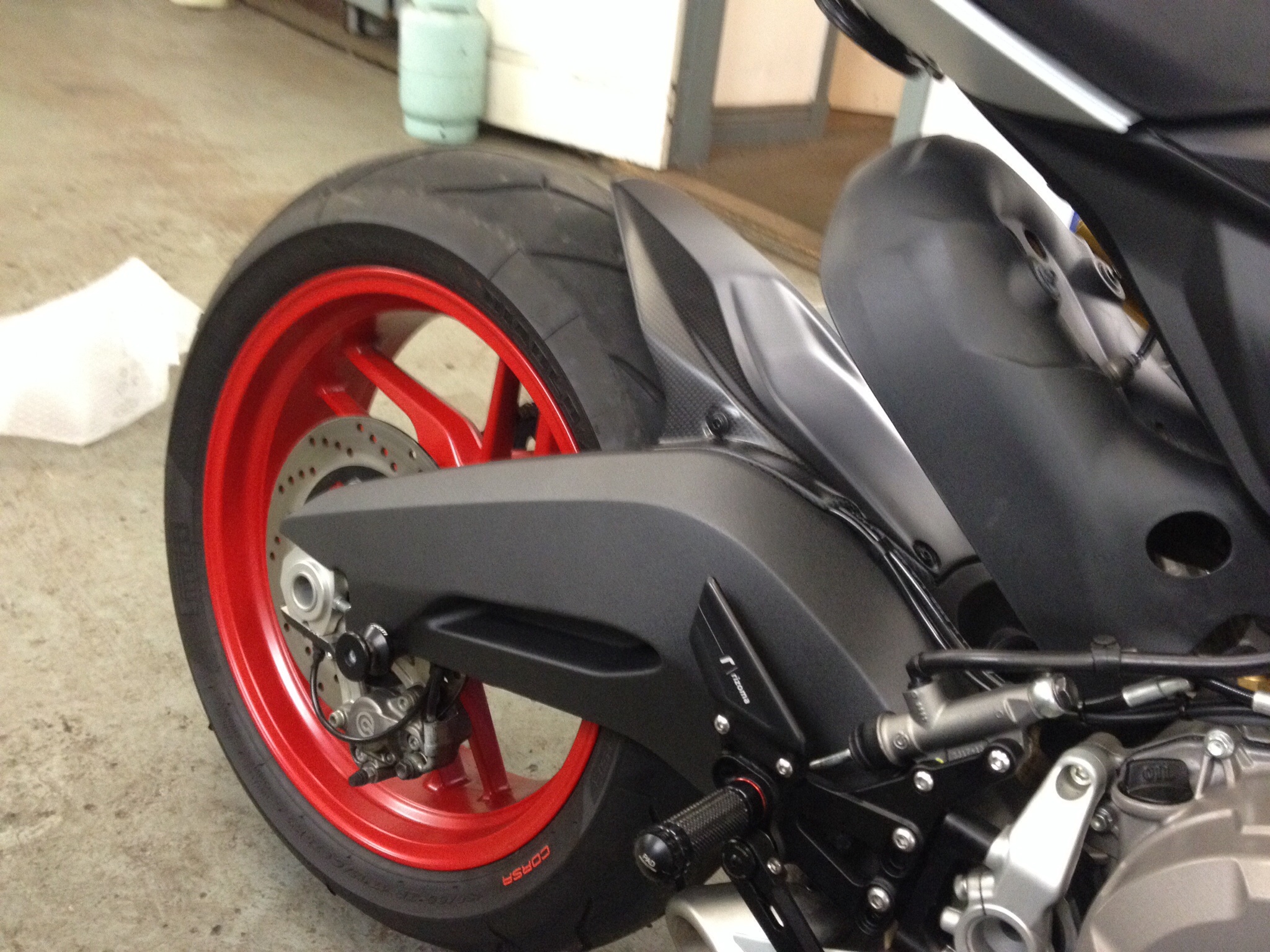

  6. image.jpg image.jpg Fitted the Rimoza rear sets to my 899, huge difference over stock, no concerns taking her out in the wet
  7. Brilliant.... right, that's my mind made up. Thanks Scooter.

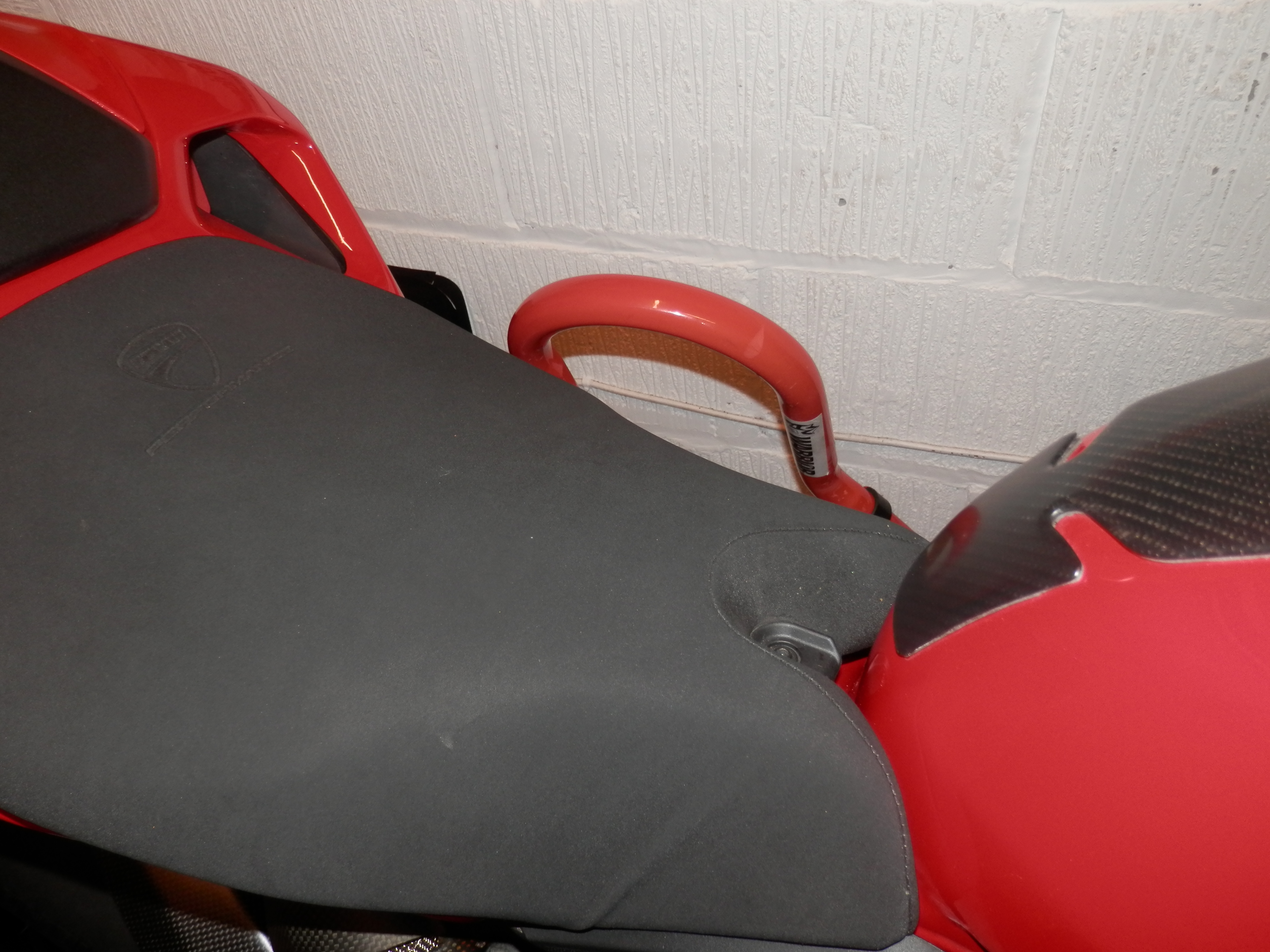

  11. Seat2.JPG I'm pretty sure the Race Seat is higher than the Comfort seat. Here's a picture of my Race Seat. Measured the height from the front mounting plate to top of seat pad and it's 30mm. The padding is also firmer than the Comfort seat and the seat is more narrow at the front. Also looks better IMHO.
    It can be a bit firm for a long ride, but I wear a pair of padded cycle shorts for a bit of comfort.

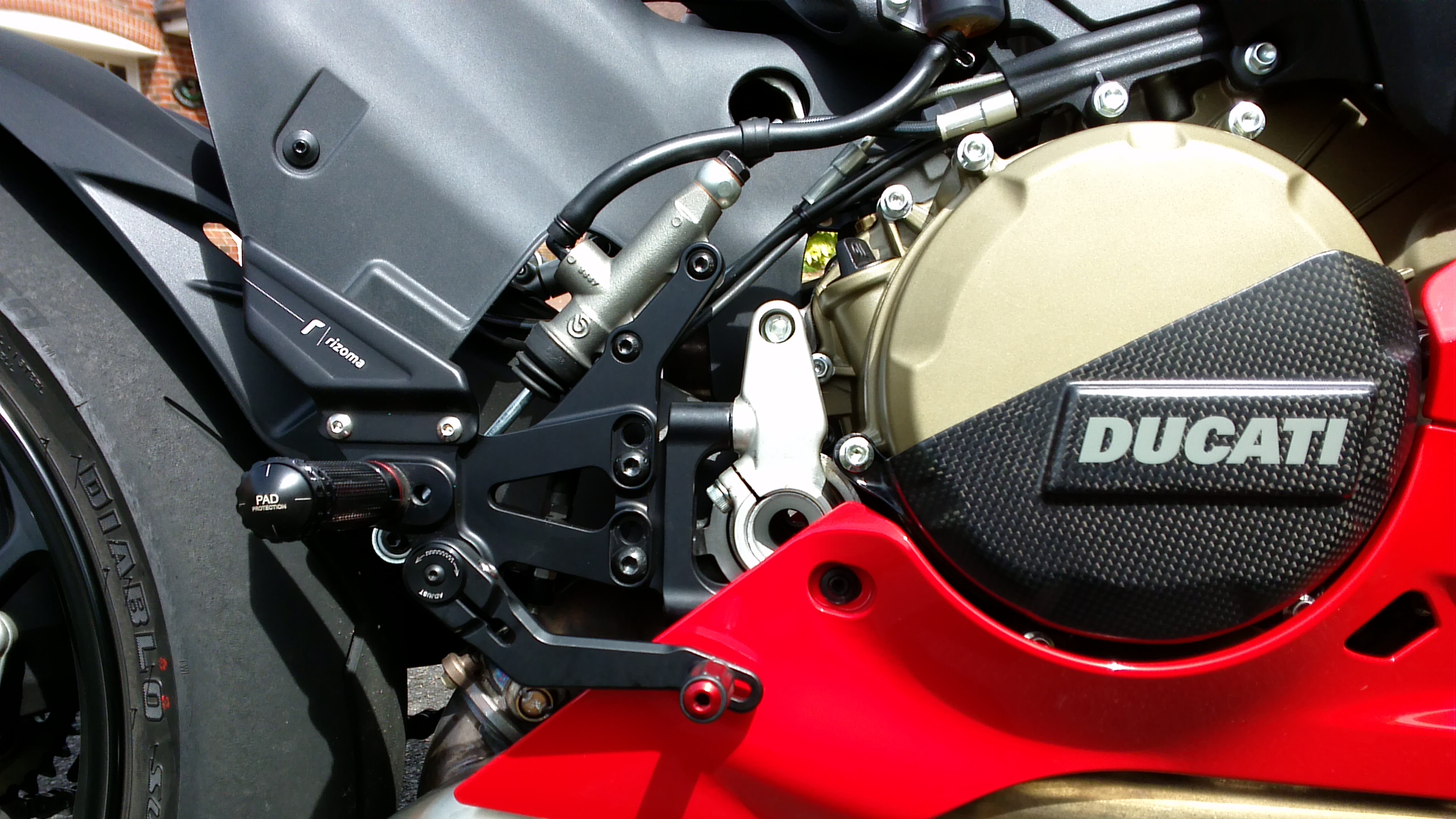

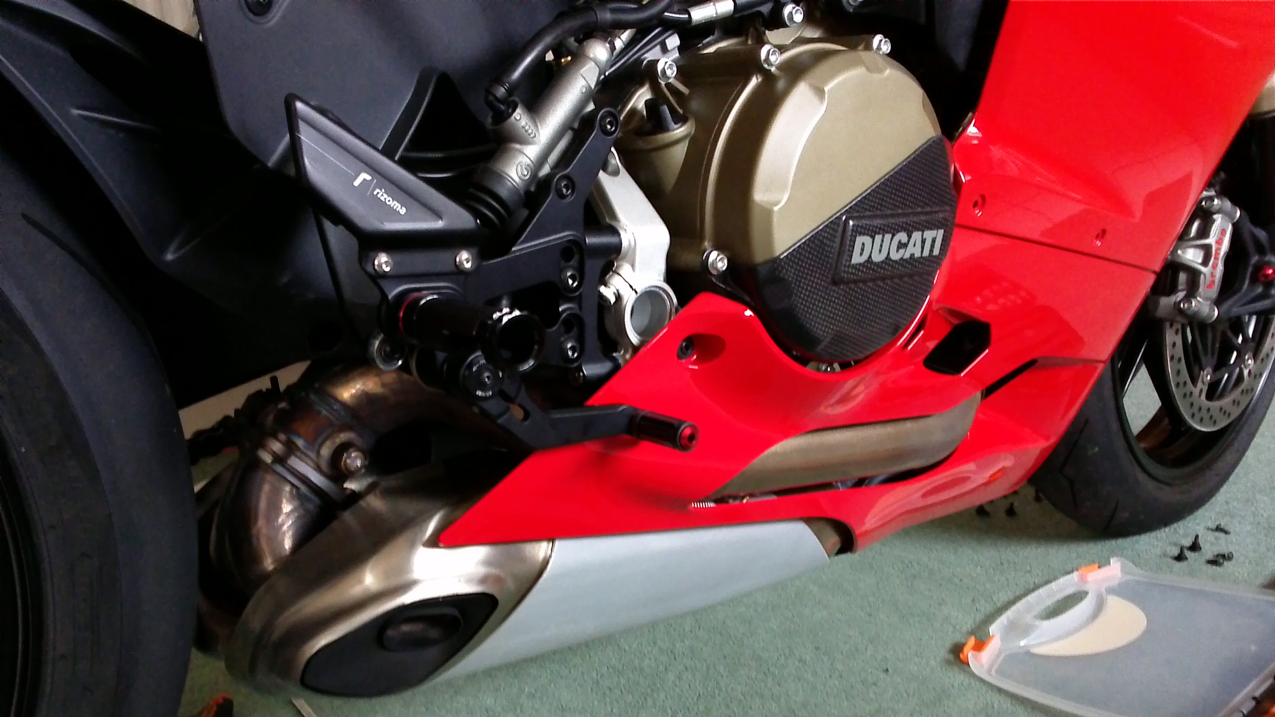

  15. Rizomas on........
  16. Look nice. Folding pegs? Ducati Bristol think you might be able to fit parts to make em flex like std pegs.
    Anybody looked at Light tech ones?
  17. Not folding and no idea whether they can be converted....I love the look of the DP rear sets, they fold, but not paying twice the money of the Rizomas.

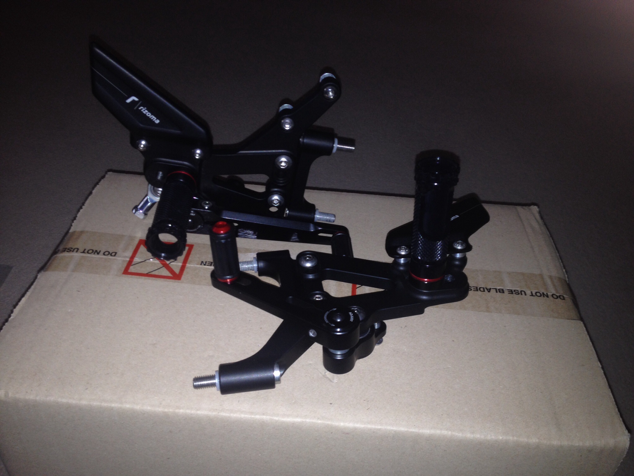

    Fitted and adjusted..... have set them so they are 75mm (ish) further back and higher than original OEM pegs. Perfect.... and so much better grip than the rubbish originals.
