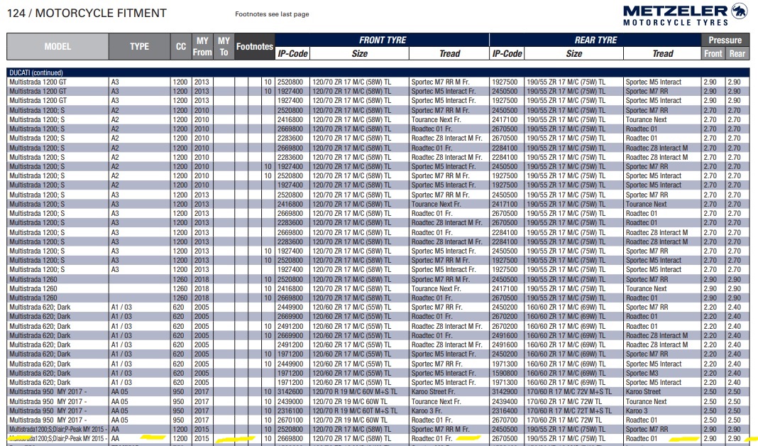

  13. Metzeler's technical data sheet says 2.9 bar (42psi) front and rear.
