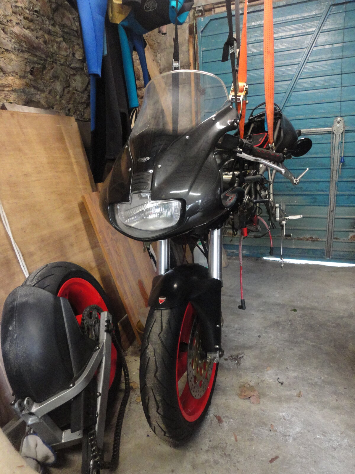

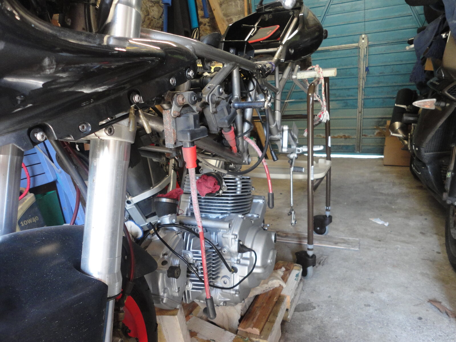

    I have plenty of garage rafters to hang straps and ratchets for lifting and support plus a couple of standard car jacks to take the weight of the engine before lifting off the frame + front end – I found my mobile workmate most useful to support the back of the frame once the swing arm/ rear wheel was removed.(see picture)

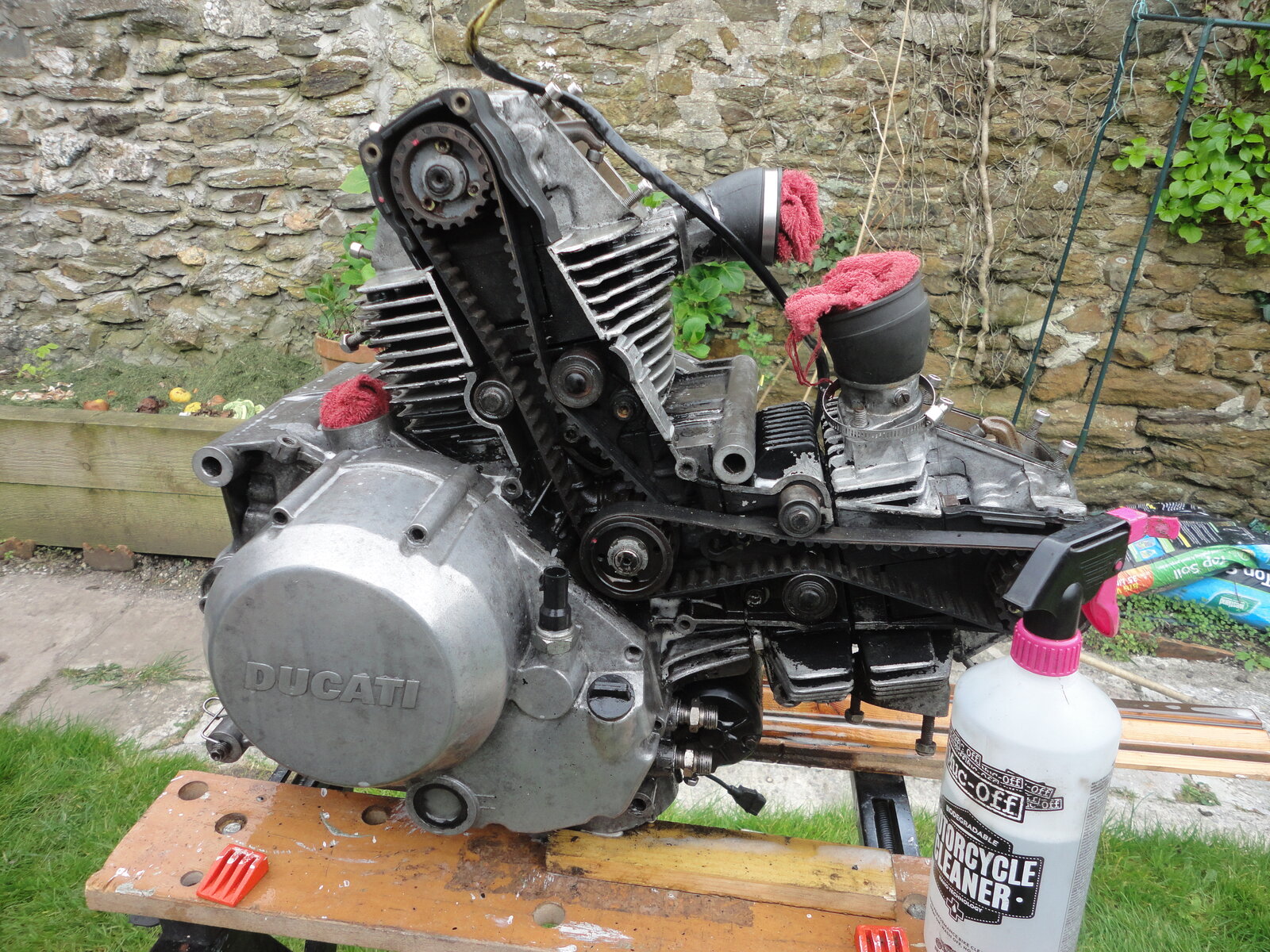

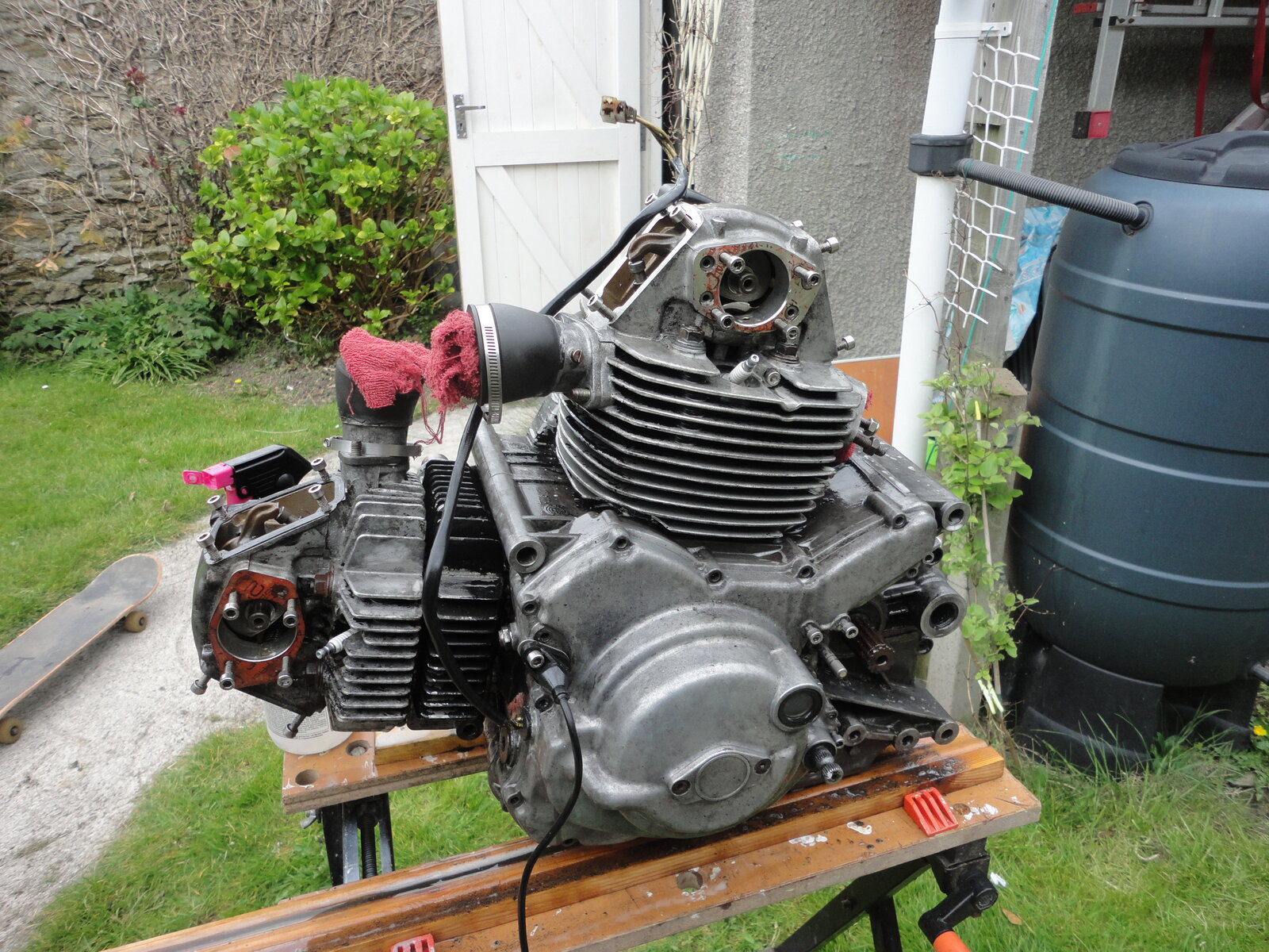

    Second mistake was leaving the engine at floor level to attack the paint removal – this screwed up my lower back after 10 days of evening and weekend very patient scrapping, wire brushing ( mechanical and manual) . Eventually I woke up and, with wife assisted muscle power, we used sons old skate board to push engine into the garden and then lifted it onto my workmate (see picture). The weather had improved immensely down here with four or five days of light winds, sunshine and no rain arriving.

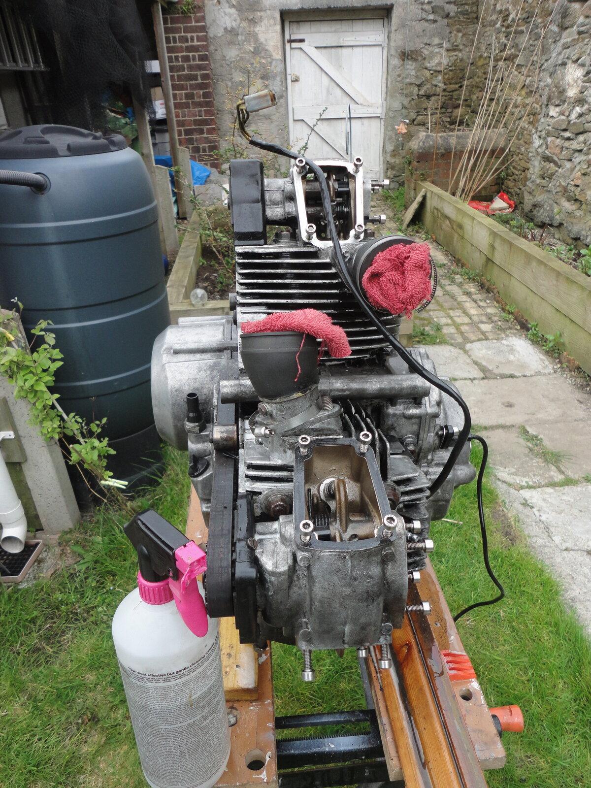

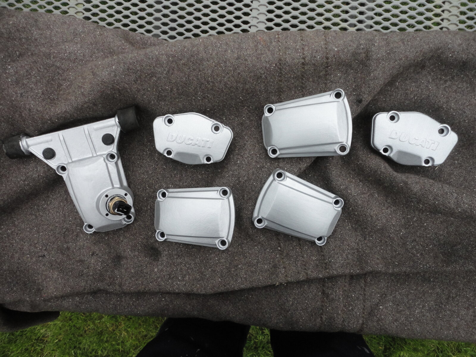

    I re-painted the covers to the valve cams to see if I could get an acceptable finish – (see picture), these looked ok.
    Another couple of days were used to get rid of the last of the black paint, degrease, wash, metal prep, wash and dry the engine unit see picture of work-in-progress) – look my mind off my screwed up lower back muscles ( DSC02787.JPG though the pills also helped) and the boring lockdown – at least I couldn’t miss riding this particular bike or any bike at present!

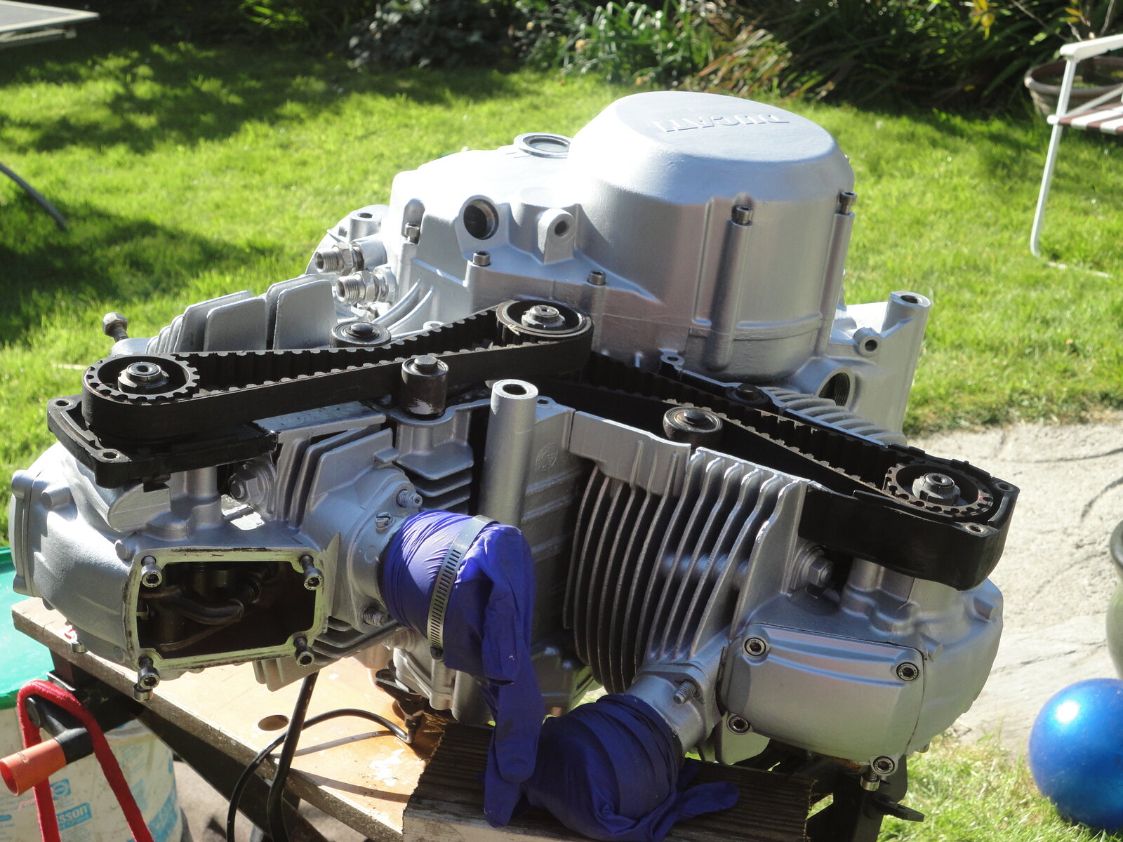

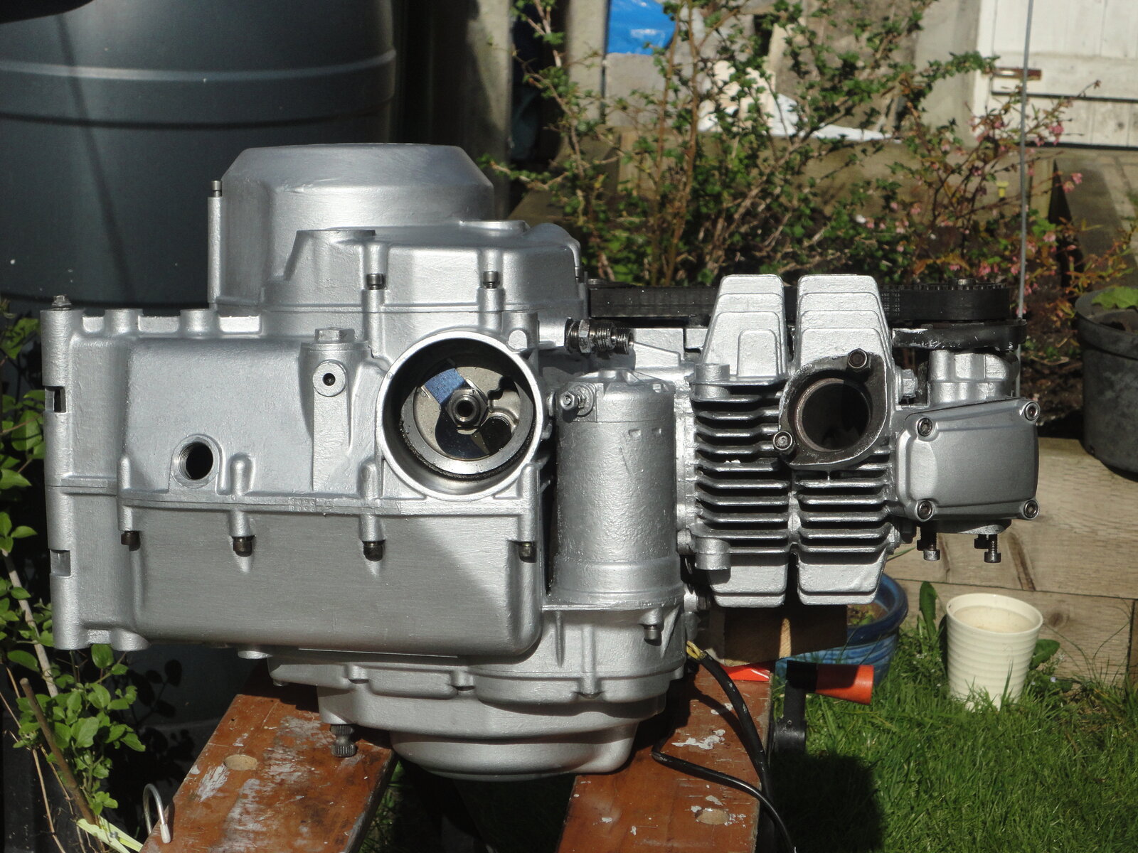

    The paint was then applied over three or four days in sections – mostly one coat per instructions on tin. A thicker consistency than normal gloss paint – not dissimilar to smooth “Hammerite” but brush cleaned off in white spirit / brush restorer unlike “Hammerite”. A spray application would have given a better finish but I could not source POR engine paint in a spray. The advantage of the brush application is a lot less mess and control. (see pictures for finished job) – the cases were not corroded except the starter motor case – in an ideal world I wanted to remove the starter motor but this requires pullers to remove the left hand engine/clutch case – to access all the fixing screws for the motor. I can revisit this at a later date if the new paint surface of the motor doesn’t last well – it does sit in line for collecting all road crud.

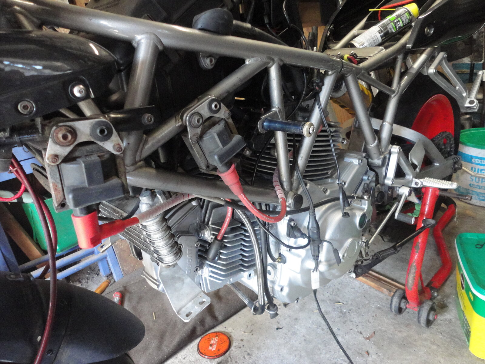

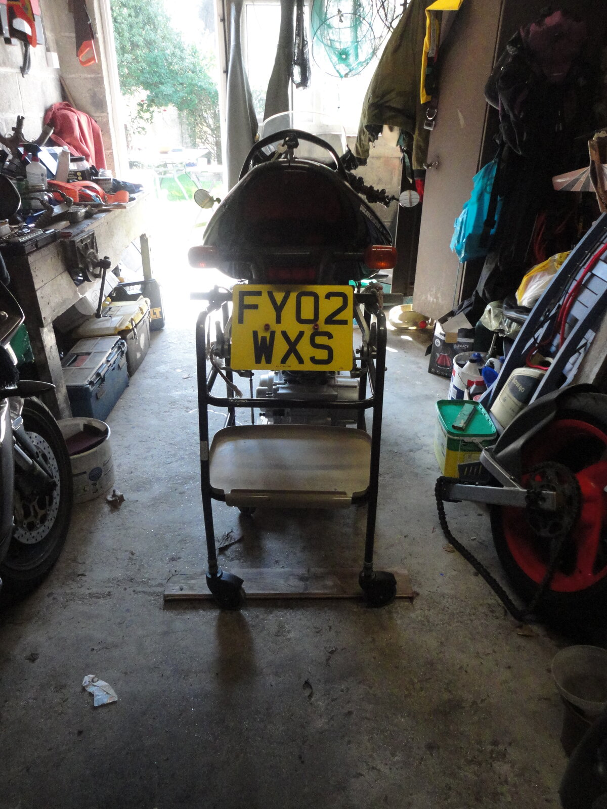

    The engine paint takes a week to harden off in ideal temperatures and seems reasonably resistant to bumps and knocks as I reassembled the bike. We lifted the engine back into the garage on the Workmate, then onto the jack, surrounded by other word blocks to keep the engine level. I found an old zimmer frame by the bins which made an ideal platform for the rear of the frame (see picture !)– allowing us to wheel the frame back around the engine – I wondered if I should leave the zimmer instead of a rear wheel but cornering might have been an issue ………..Most annoying moment so far has been the discovery of a fourth swing arm shim washer after I had reattached all the rear end …………. when I removed the spindle I carefully left the washers on the spindle shaft but this one must have dropped off the spindle in storage, then “hid” under other bits. It seems the number of shim washers varies – my bike now has two on either end of the swing arm spindle, one very slim and the other “normal” washer dimensions. Second annoying moments have been trying to remember which engine casing screws went where – some are obvious, some not so clear. I have one missing now so I will have to annoy the local bolt supplier when they re-open.

  3. The engine paint looks pretty good!
  4. Cracking job, you used POR engine paint? Their products are good. I have a 900 Senna, love this colour scheme.
