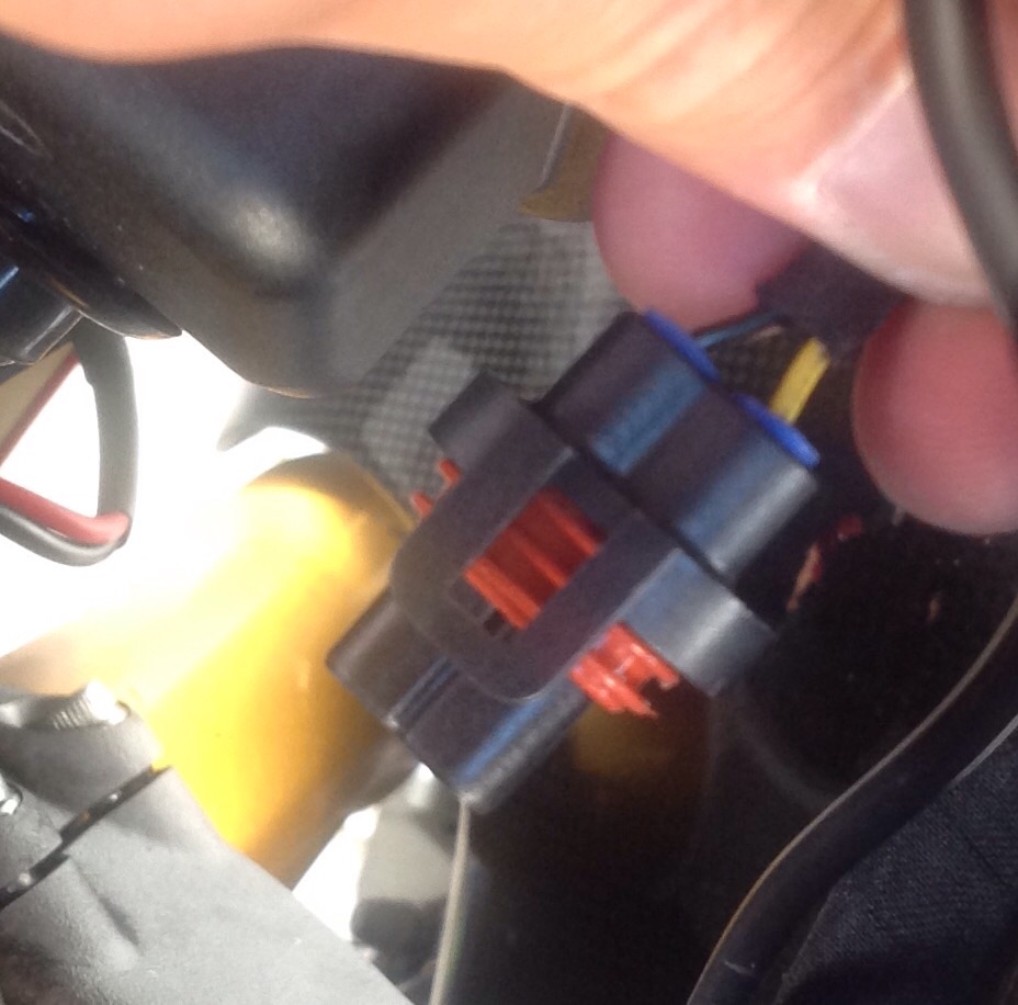

  1. When changing my working running light bulbs to LED the LED's not working. Bulbs are checked ok. Is it possible to switch the black and yellow wiring? The LED's are working ok when the socket is connected the wrong way.
  2. My right running light is ok only my left not working. Have changed to HID Xenon a week ago can I have done something wrong when installing HID? The HID's working without any issues.
  3. Problem solved. Switched place on connectors in male socket.
  4. You can push the connectors out of the male socket with a pair of long nosed pliers and reverse them for the opposite polarity. The original bulbs so not care about polarity, but LEDs do.
  5. Thank's Bob T just what I did. Works perfectly now:upyeah:
