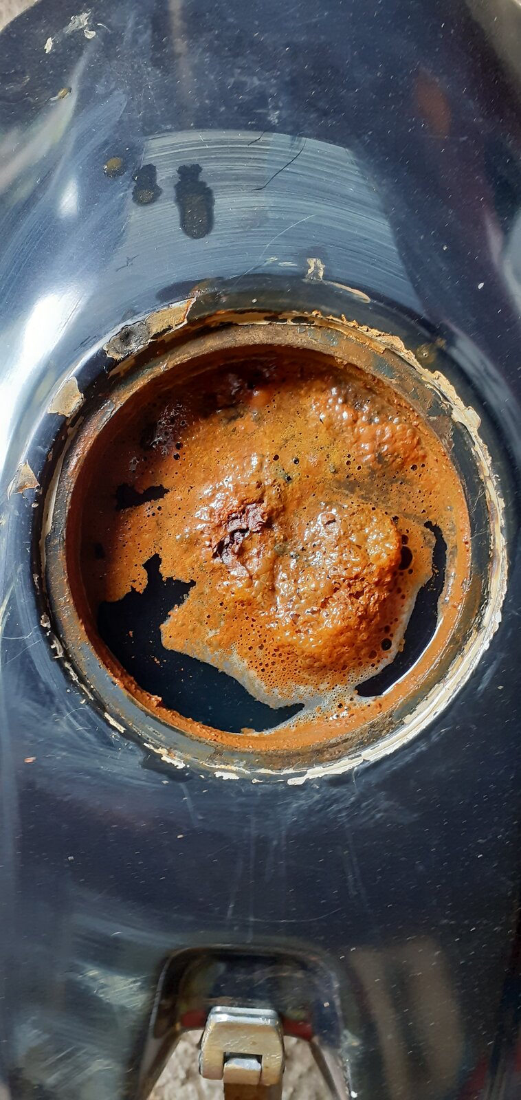

  16. Hi All well in case some have not realised I bought the 620ie and have been using electrolysis to deal with the rust and it looks like it WILL be getting the Por-15 treatment that is when the kit arrives from the UK along with some submerisble fuel hose. Can you believe that I cannot seem to get any of that here !!!!!! :astonished: In the meantime am going to buy a couple of bits or ordinary fuel hose and use them to connect up the new fuel pump and inline filter so we can see if this helps with the poor starting issue as it's been suggested that the yucky orange coloured fuel removed from the tank may have been some of the issue but untilwe get fresh fuel in the tank and try starting her we will not know for sure.
    PITA to be sure to have to take it all out again to fit the correct hose but if I wait until the hose and Por-15 kit arrives which will be in July now possible the 6th but if am lucky a bit earlier but it could possibly be even later and that means another month or thereabouts. This is some of the rust lifted off by the electrolysis :-
    Not nice at all. Will be visiting the body/paintshop to ask about the repair of the dents around the filler and the small on on the left of the tank and a strip and respray will also ask about getting the "mudguards" done as well as they have some gouges in the plastic.
