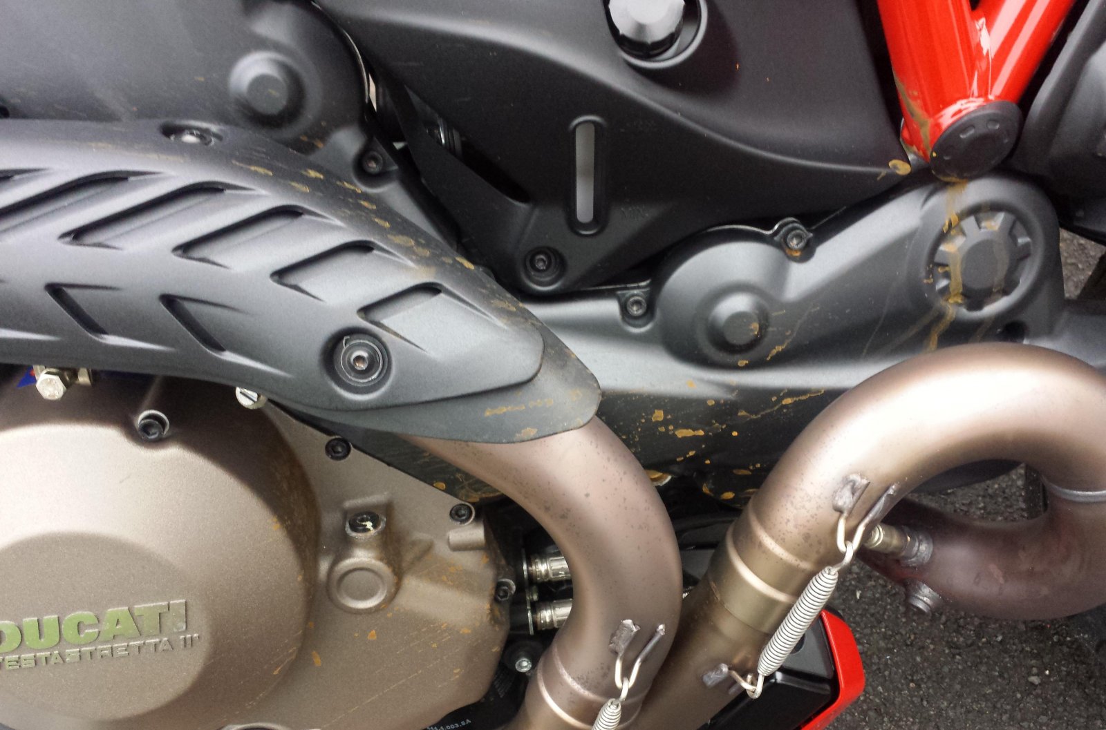

    Just came back from a quick ride and when i parked the monster i saw all this messy yellow liquid on my motorcycle. It was dry and it looks like water mixed with rust.

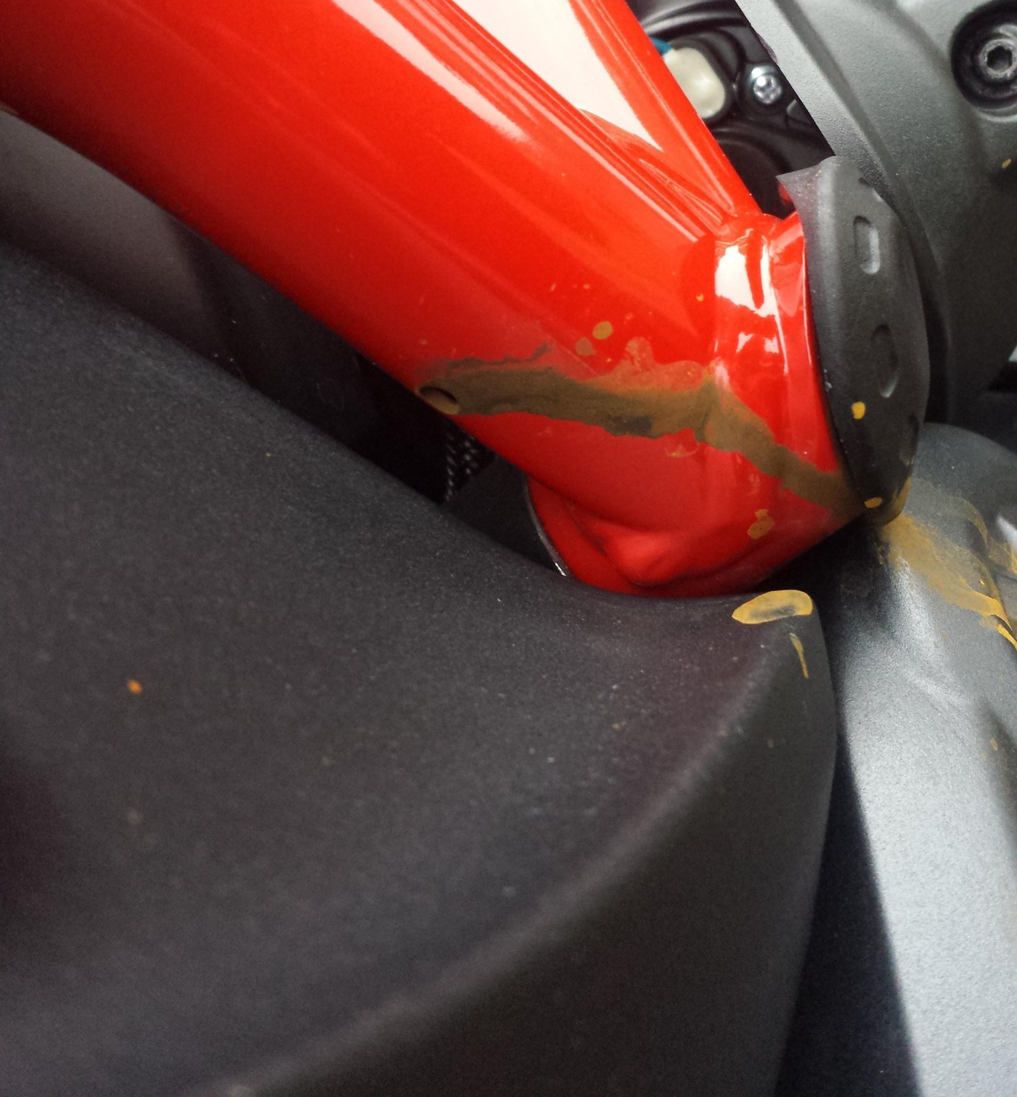

    I followed the signs of leak and it seems that it came from the small holes that are on the trellis.
    Has anyone seen anything like this before? Should i be worried?
    Regards
    Chris
  2. Could be a bit of mild inner surface rust may not even be from the trellis. Filings from bolts ir welds. Just remove a plug, dry what you can and spray some acf50 inside the pipework. You prob won't ever see any come out again.
