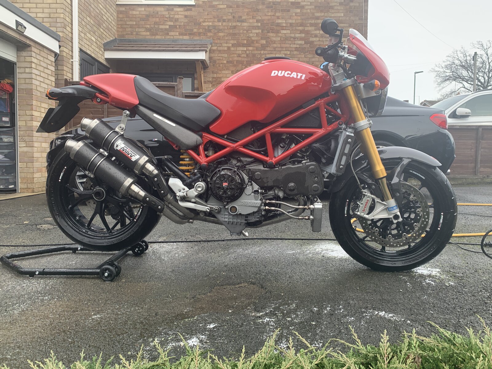

  2. Yes they will. I’ve done similar with my s4rs: spark pipes with mivv cans. And there are probe points (unhelpfully they don’t supply plugs!) and you can normally get ecu mapped. @chrisw can do most for a very small charge
  3. Thanks for the photo and the help! Do you think it's fine to run with the stock mapping for a while after installing the pipes?
  4. I am. Smells a bit rich bottom end. Soon as I can, mate is going to map it using DO flash or, if doesn’t work, I’ll be sending to Chris. Just have to ignore the yellow engine light.
