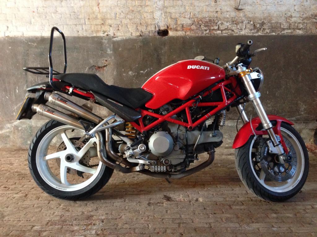

  1. Say I wanted to upgrade the front end of my s2r1000, ideally to ohlins and monoblocs, apart from trying to find an s4rs front end what are my other options?
    I don't really want to mess about with different diameter forks from later super bikes as I've got a rizoma top clamp and clip ons to go on at some point. Ideally I want to keep the wheels standard for now although I am considering carbon wheels and want to keep my options open but I may do it all in one go if necessary...
    To cut a long story short, I'm thinking of making my bike awesome and a bit more individual rather than rushing to give a dealer my bike +10k for a nice shiny lump of depreciation when the monster 1200 is available.
