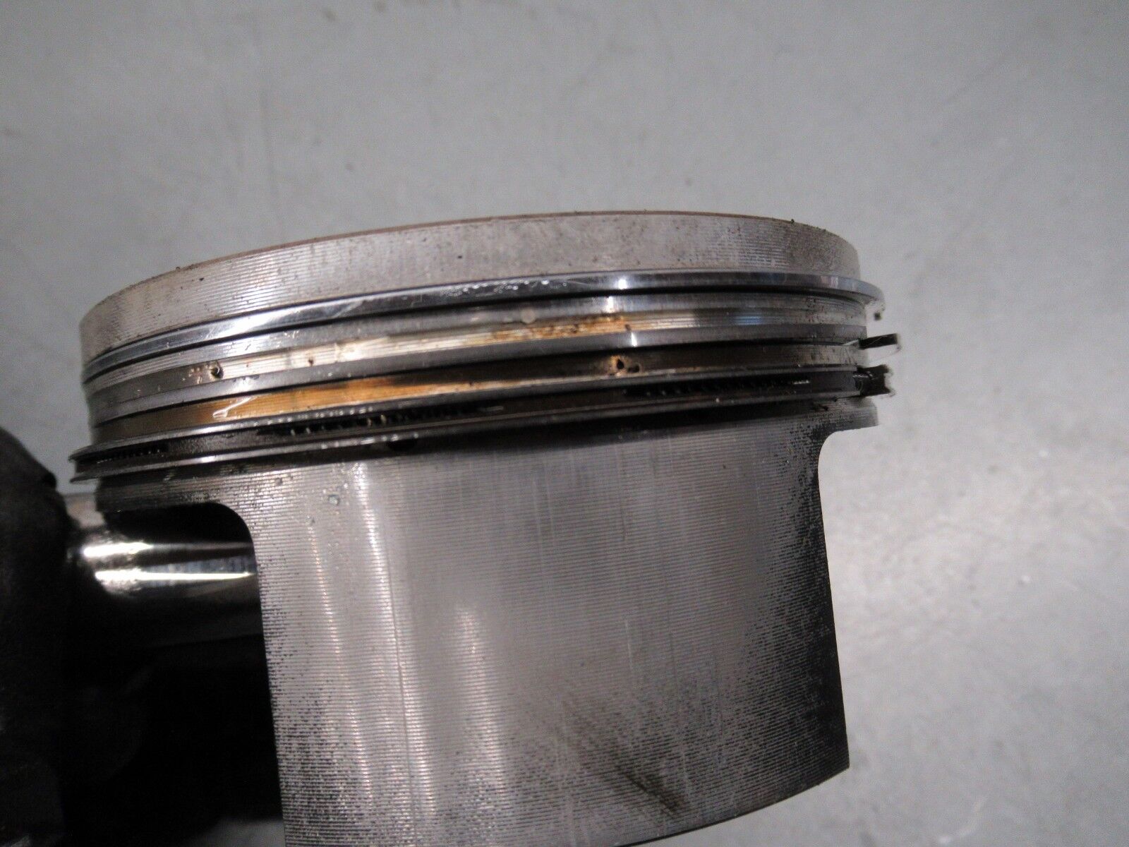

  10. I have seen them both. The second more reasonably priced, does not seem in very good condition. The rings seem to be scuffed.
    For the first one, I am not really certain, since he has not that many photos so that I can check the condition of the piston.
    But I appreciate very much your effort.
  11. re: 2nd listing - neither of us can really know without holding piston in hand and looking first hand, but poor presentation and photography are playing a part in this picture, the marks on top ring could be water droplets/oil (you could ask for more pictures) and the slight matting on rings would not stop me fitting necessarily and the main"plus" you can take from that picture is that piston skirt shows general wear is acceptable for a second-hand piston.

  13. Chris, on a second examination the info that the seller is providing is not true. The cylinder and piston comes from a 916cc engine. He states it to be from a 996 or S4r. The piston diam. of the 996 is 97.8mm and the cylinder bore is 98mm.
    I have double checked the figures.
