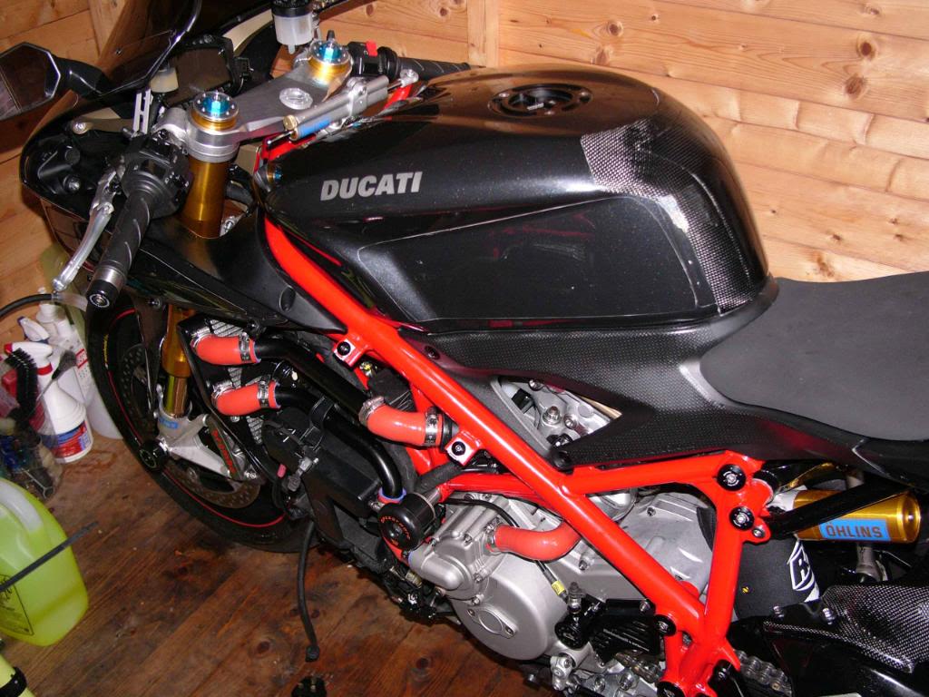

  15. Mine
    Bit like Matt's but with metal pipes on the rad runs, Venair. Absolute pig to install
    One thing that happened with mine was I couldn't be arsed getting the new hose clips I had onto the water pump inlet and used the original clips, which over time bit into the hose and tore it. I then replaced all the hoses with broad SS rolled edge type, silicone is soft and can tear if the right clips aren't used

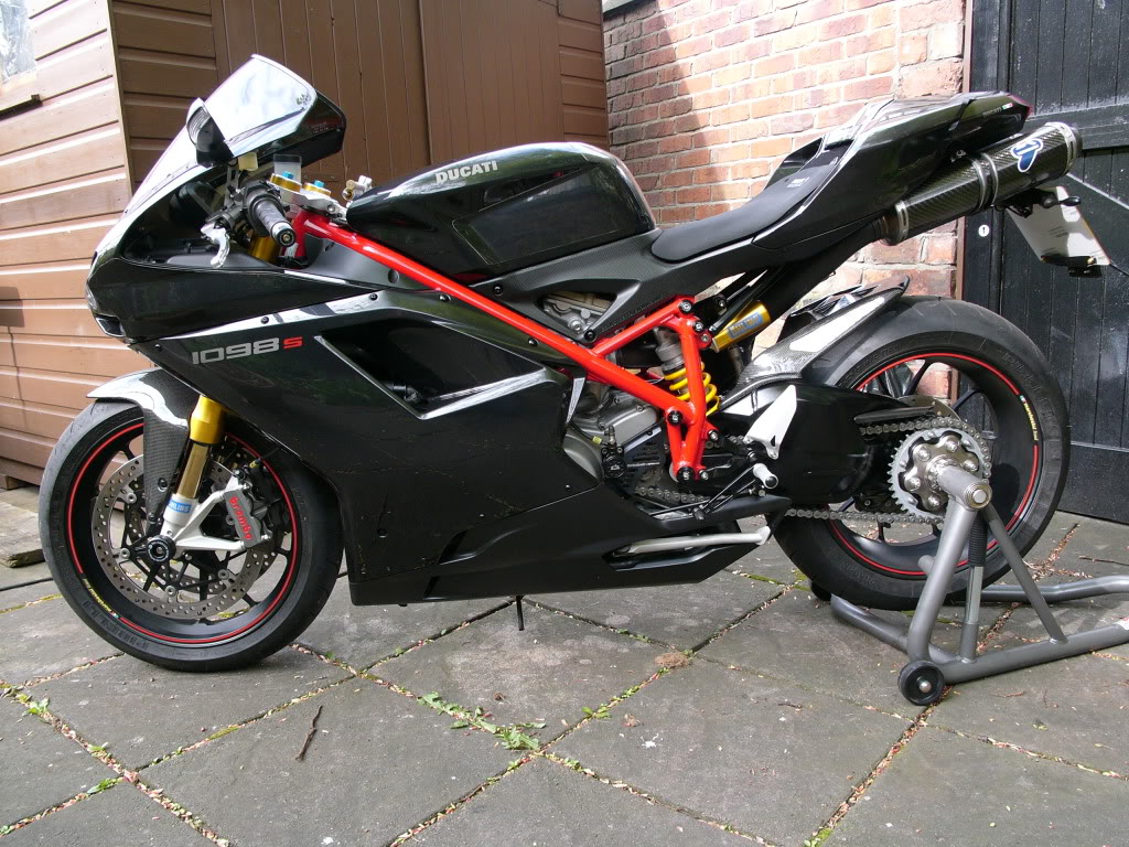

    Got no clue how to get rid of that second pic that's appeared and is entirely unrelated???

  19. OJ, Loving the look of your bike there :biggrin:
  20. Kind of you to say so Matt.
    The only thing that's different now is the thing did a suicide dive into my Guzzi earlier this year (my stupid fault). So a Termi was toast. Now replaced with Quat D end cans. I suppose that's sacrilage to the forum, but I actually prefer the look. Sound not as boomy as the Termis (a downside) but the quality is much better and a helluva site cheaper.
    I don't feel I've done so much just tried to add odds and ends and keep it clean, sometimes more successful than others
