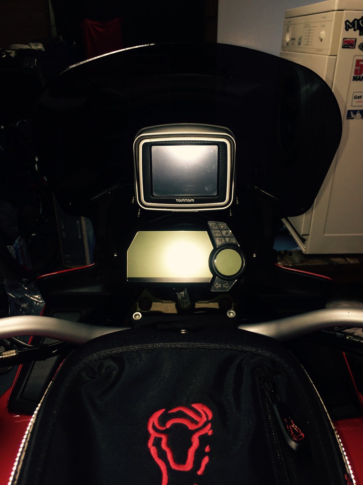

  4. I had my tomTom Rider II fitted to the Navi without any problems and its the best position for your sat nav

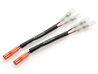

  9. Pretty sure you can plug + play with the RIZOMA connectors, someone able to confirm my suggestion? Rizoma Turn Signal Cable Connector Kit

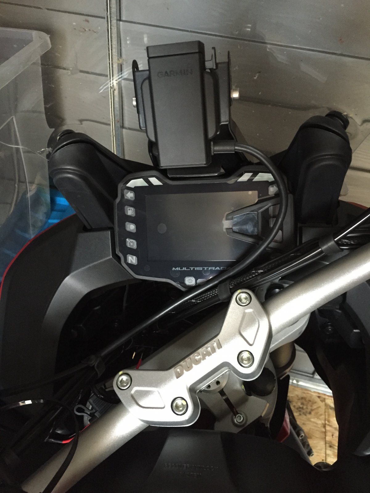

  10. don't know if this helps but that's the bracket when its fitted
  11. ps cable now runs behind the screen before any one makes any remarks.
  12. Tallboy, as if anyone would do such a thing!!!! Jon.

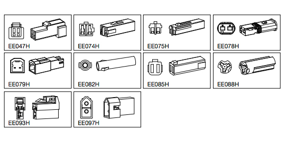

  13. But which connector is it?

  15. 99% sure used the Rizoma connector as pictured to connect the rugged GPS mount of my Garmin Montana 600 but not near my MTS in the moment to check....

  16. tallboy, to route the cable behind the dash did you have to remove any items?
    Also realised that the DVT has a 'fly-lead' that you simply cut and solder the GPS loom to (two wires)
