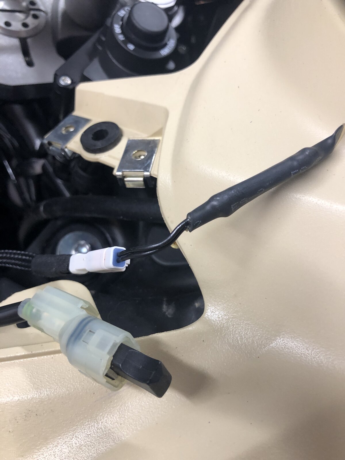

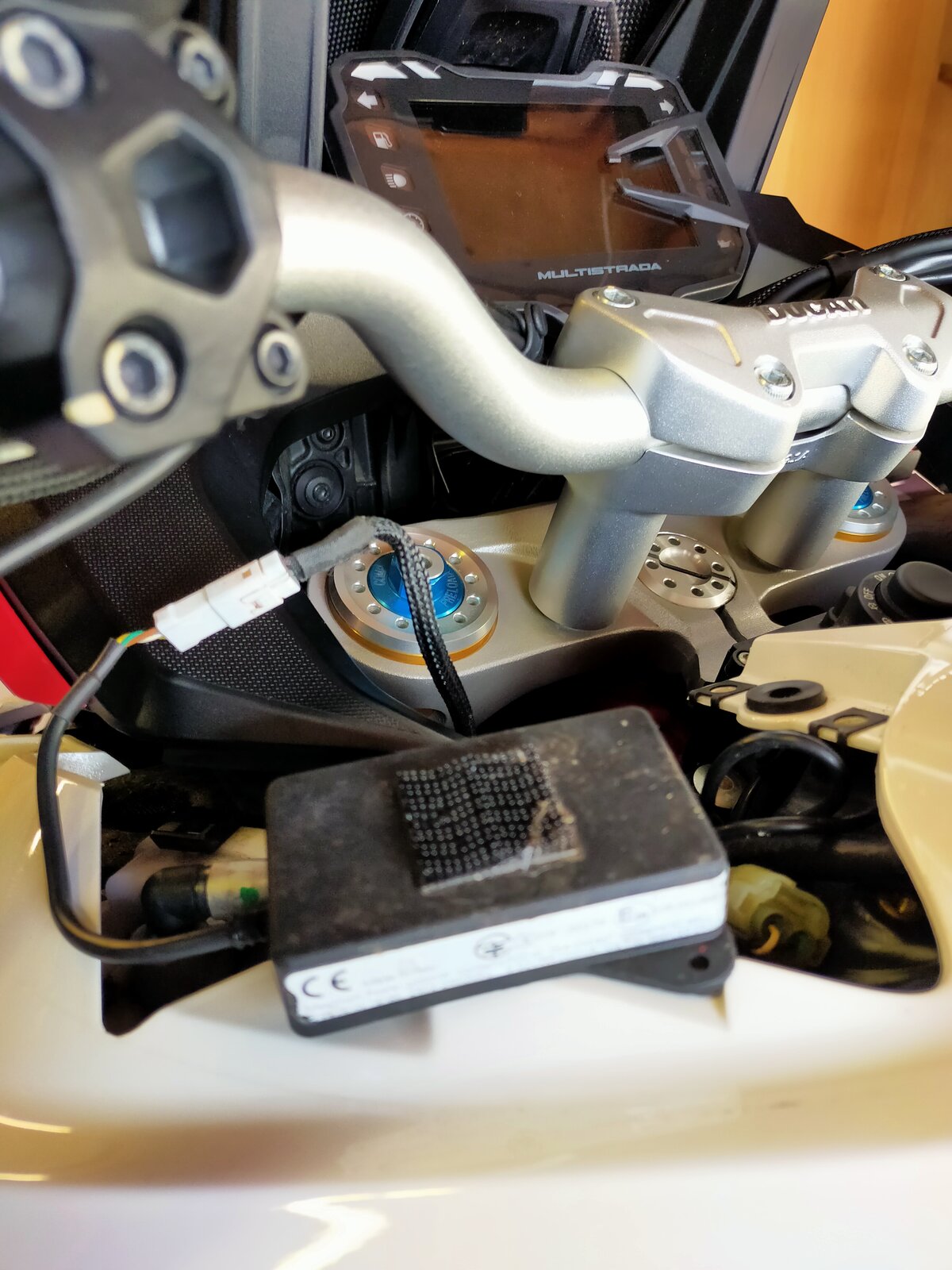

  3. the connector at that location is being used by something. i dont know what it is because i dont have a workshop manual,only an owners handbook. picture attached.
  4. That is the Bluetooth module and uses a 3 pin connector. You are looking for similar connector with 2 pins/wires which should have a short length of wire terminated in a heat shrink sheaf. There is also another connector in the same location for a keyless filler cap which is a larger type and will have a blanking plug fitted if not installed. Sometimes these connectors can be difficult to find as they are under the front edge of the tank cover. I'll see if I can find some better images for you.
  5. This what you’re looking for:

    Yeap - the small white connector and "pig tail" is for sat nav power. The other larger connector with the black blanking plug is for a keyless filler cap.
  8. FOUND IT, thanks again for your help. just need to upgrade the bracket now from a 2011 to a 2019 for a garmin ducati sat nav.
