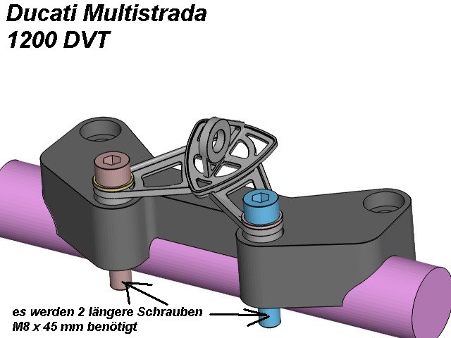

    if you need an idea how you could mount a Sat Nav on your
    Multistrada 1200 DVT, maybe this could be helpfull for you.
    At first you have to mount a steelholder on the handlebarbridge
    ( Steelholder for all following Plastic Adapter ):

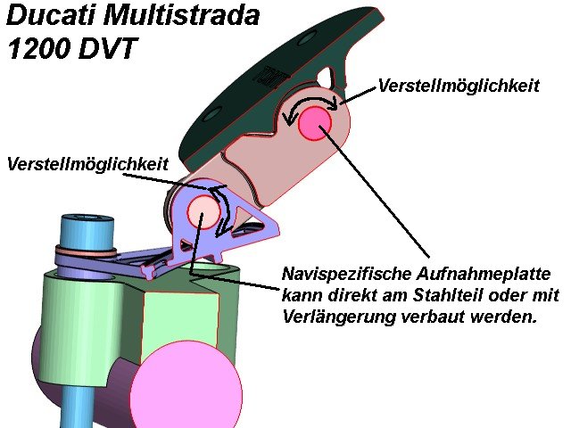

    Than you could mount different Plastic Parts ( lasersintered Polyamid / Nylon )
    for the different Sat Nav`s:

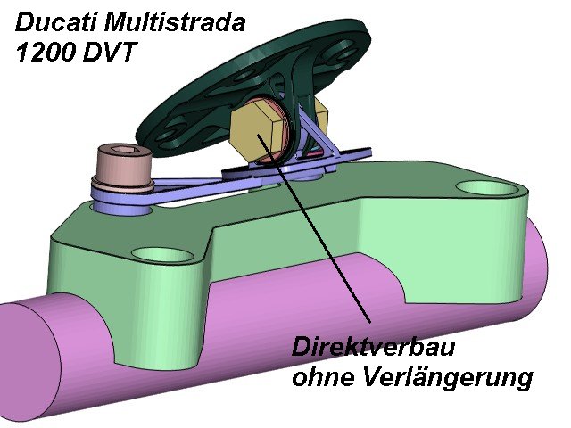

    Zumo 5XX Series, Zumo 660, TomTom Rider V4:
    Multi 1200 DVT Adapter Zumo 5XX,660,TomTom4 (L2GKES8BD) by Varadero

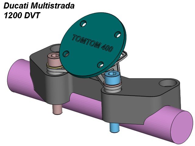

    TomTom 400:
    Multi 1200 DVT Adapter Tom Tom 400 (TSHRWWUAT) by Varadero
    Zumo 3XX Series:
    Multi 1200 DVT Adapter Zumo 3er Serie (SE9MYM3WA) by Varadero

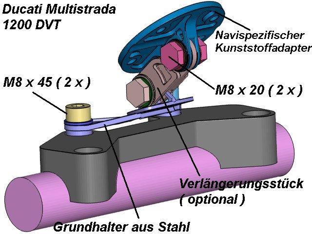

    If you want to use a tankbag you could mount an extension:
    Multi 1200 DVT - Verlaengerungsstück (NSK7WL7JL) by Varadero

    The Material of the Plastic parts is lasersintered Polyamid ( Nylon ).
    The Material of the Steelpart is Stainless Steel.
    We just upload the CAD Models to a Rapid Prototyping company who could manufacture that.

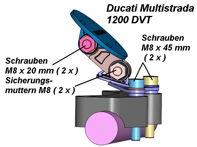

    For mounting the parts you just need longer screws for the handlebarbridge M8 x 45 mm , and screws for mounting the plastic Part ( look at the pictures )
