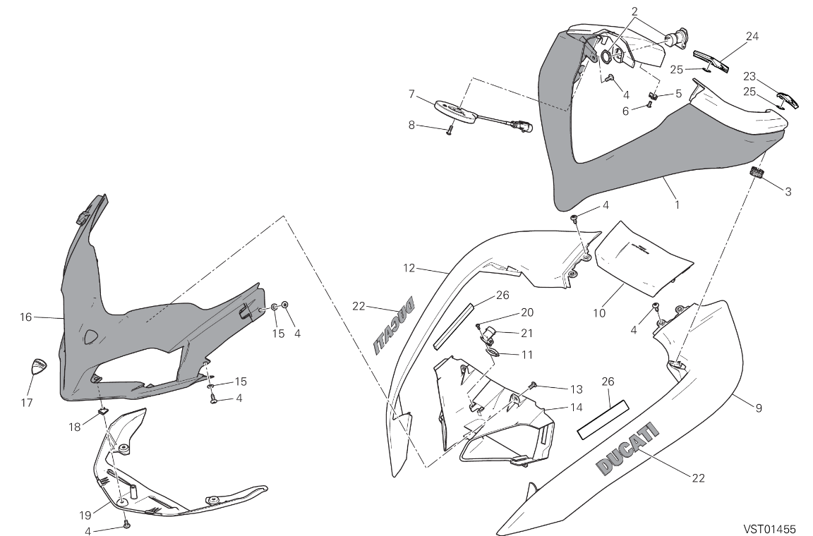

  4. You don't need to take the nose off! Just central cover at the front of the tank [item 10] and the left hand cover [item 9]:

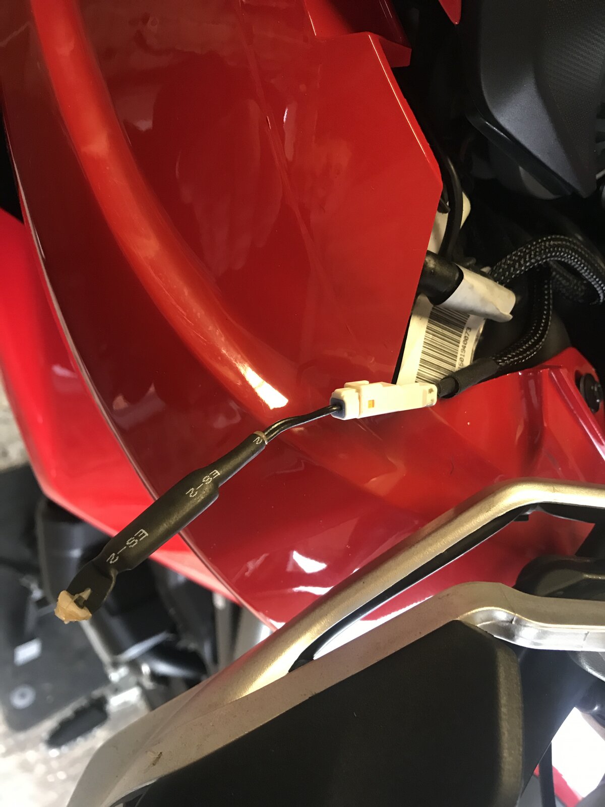

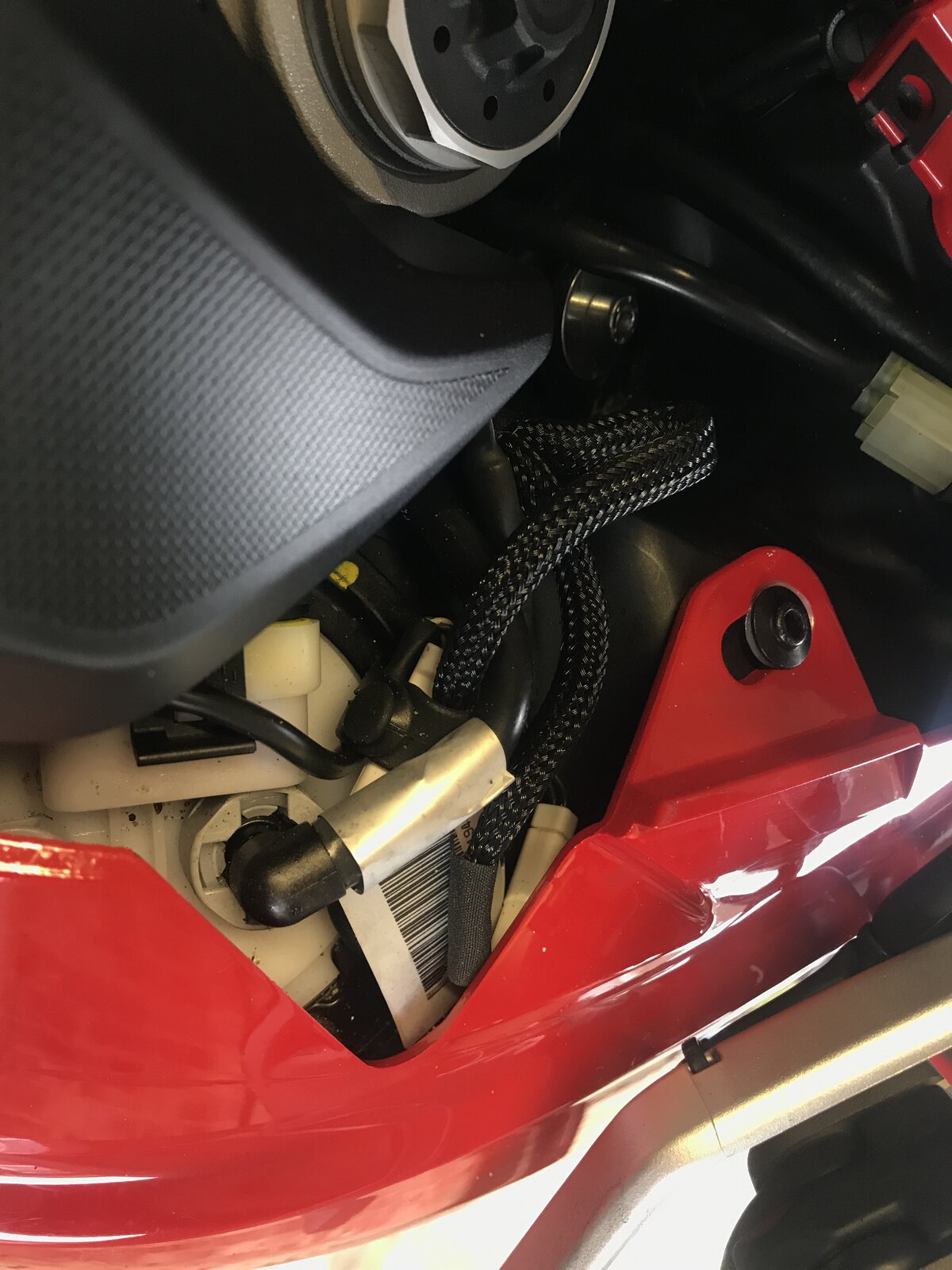

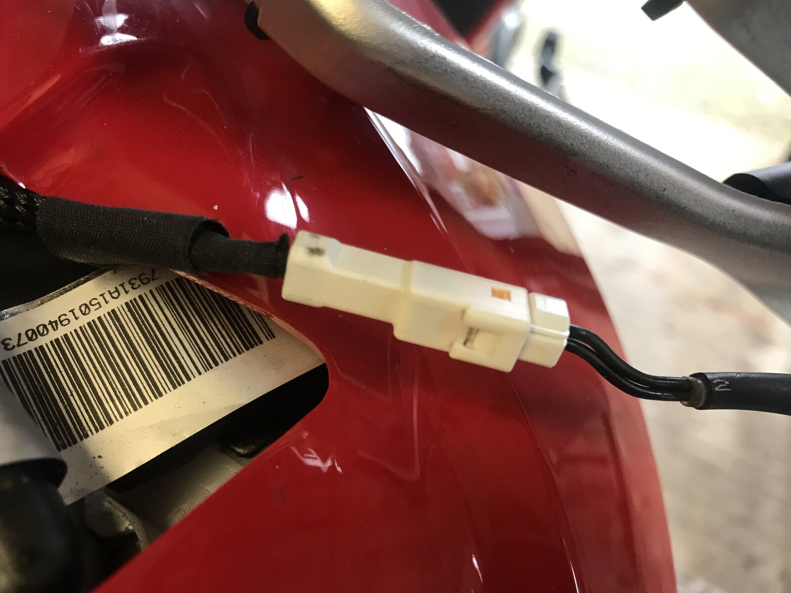

  8. Here are a couple of pics to show where mine was located.
    Hope that helps.
  9. Mr Steve 123 is totally correct. In fact it's improved even further on the newer models, in that the connector is one of the waterproof types, simply 'plug & play'.
