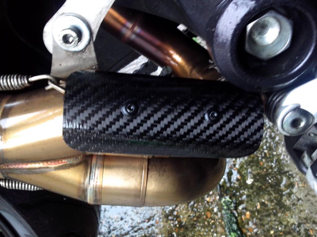

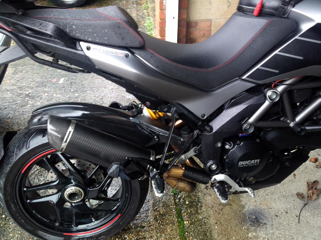

    Here are the pictures of the exhaust on the bike, I had to clean it before taking the pictures but the can is matt. The carbon cover is held on by a jubilee clip and the d-cat comes in 3 parts, the Y piece pictured here and two joining pipes to the headers. A number of springs then hold together the Y-piece to the can and joining pipes. I believe that the race can is slightly shorter.
  10. I'm liking that.
    i take it you don't need the passenger pegs installed for the exhaust as it looks like its secured further over?
  11. Correct, it uses the previous exhaust mount off the frame with a joining dog bone. As SC don't provide a work around for the exhaust valve I used the Mivv method by fitting two springs between the end of the wire and the mount it runs through. Cheap and effective as the springs provide enough resistance to fool the ECU.
  12. Looks good. Does it work OK with the panniers fitted?
  13. I haven't tried, I rarely ride with full panniers. I can't see why it wouldn't it's smaller than a full termi.
  14. Is that a standard seat? Want to get mine done and it's pretty much the kinda thing I'm after
  15. That's the stock seat on the GT.
  16. Cheers
    That's two things I need to buy this next few days then :)

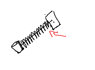

  17. Messes, i am trying to copy your SC Project setup on my 2012 MTS1200s and wondering what the MIVV method you mentioned above? Any additional info will be greatly appreciated. Thanks
  18. Hi,
    I got some springs from Halfords and slipped them on the wire so that they would provide resistance when the bike tries to activate the value. I had to use a couple to get the right amount of tension but I've been running this for a couple of years now. I've drawn a picture of where you place the spring. Untitled.png
