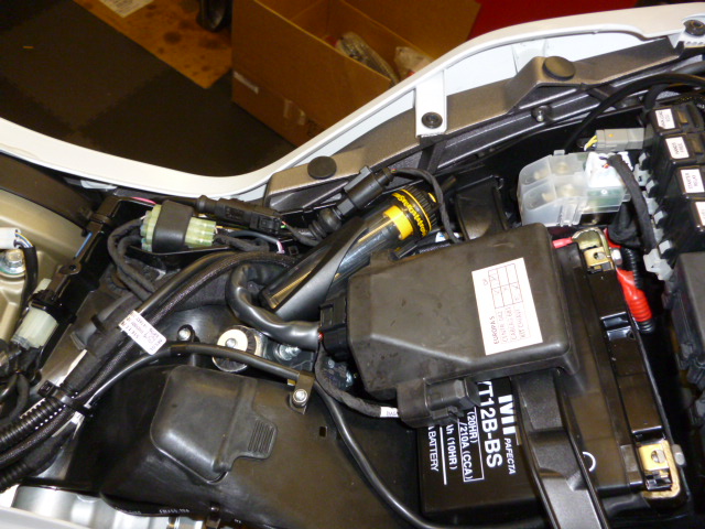

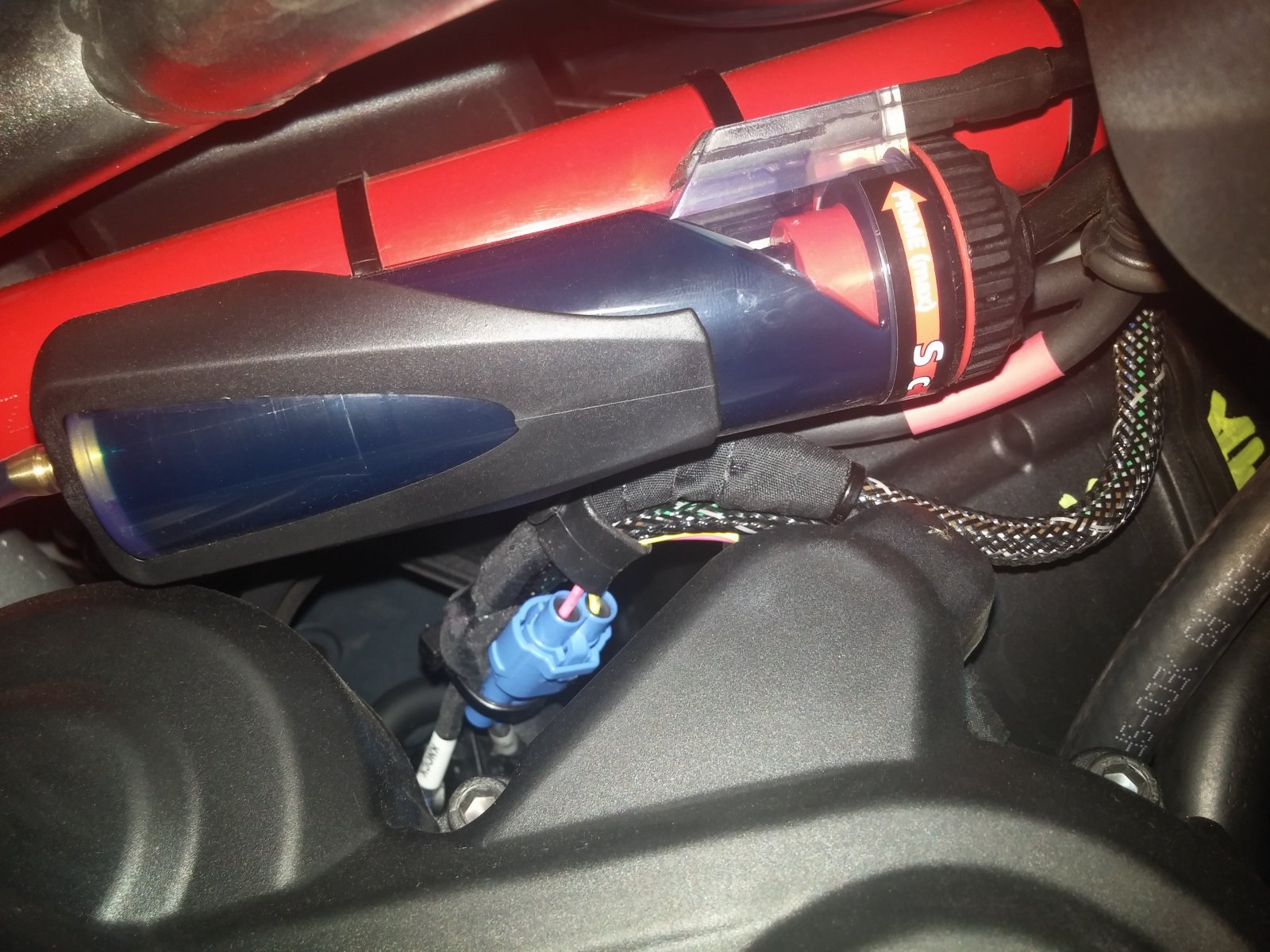

  9. Some pics of the Scott Oiler fitted to my 1200 DVT.
  10. Any chance of a pic or two showing where the vacuum tube is plugged into?
  11. Havn't got a clue but I will ask the dealer on Monday as it has first service.

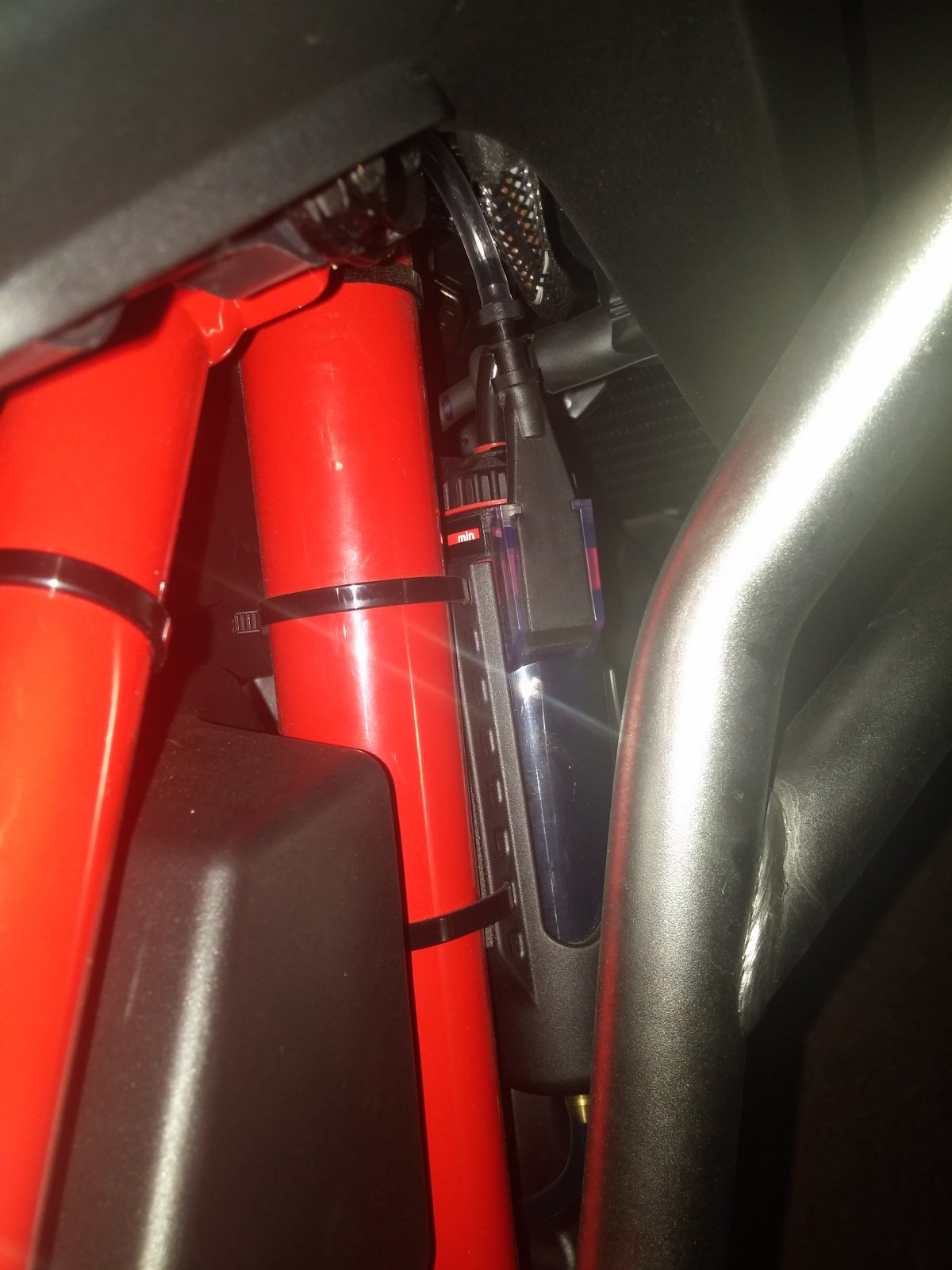

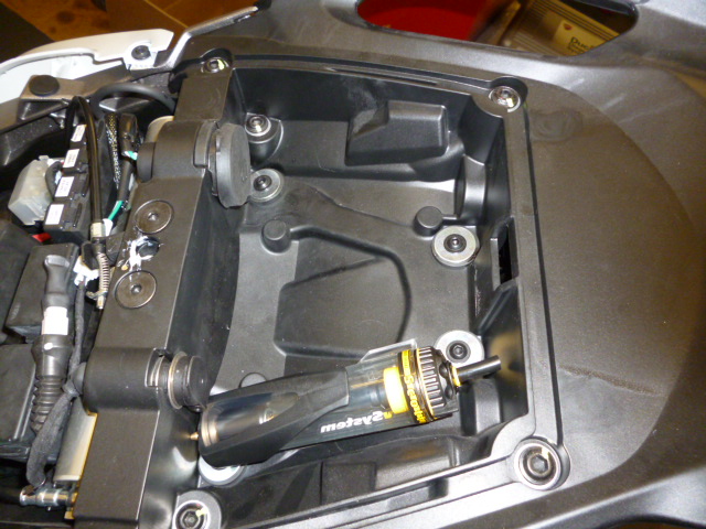

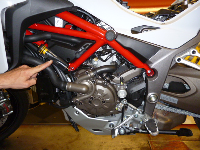

    Had my Scottoiler fitted by my dealer M & S Motorcycles in Newcastle and it works a treat. The three pics attached are the options they provided me for locating the reservoir. I went for the one under the riders seat.
