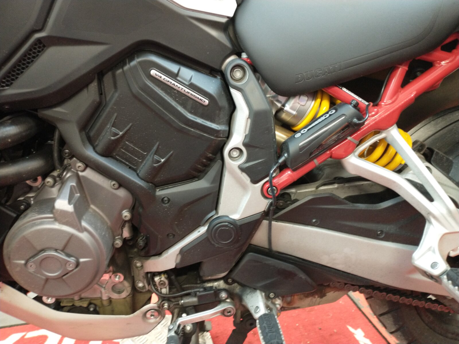

  4. I've installed a Scottoiler xSystem. I didn't have a lot of time to search for all possible locations and settled on:
    I removed an eSystem from my previous bike but couldn't be faffed to remove enough bits to run the cable up to the bars for the display. The xSystem just needs a 12V supply, either switched or "always on". Mounting on the left hand side made the oil feed pipe run relatively straightforward.
  5. I have fitted mine in the same location. Aesthetically not pleasing but easy access to top up reservoir. xSystem works faultlessly.
