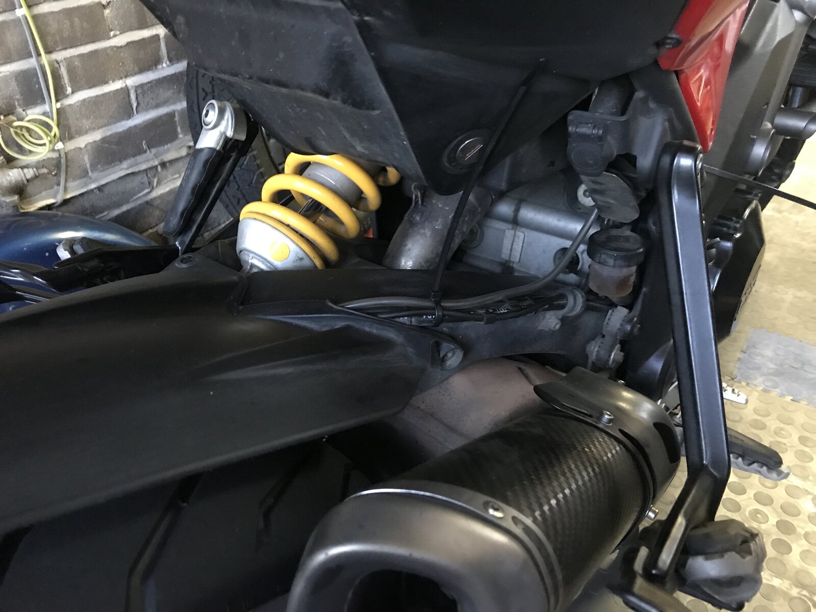

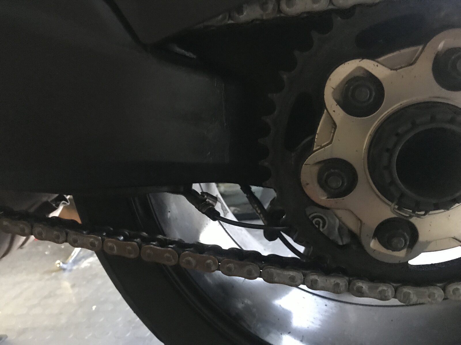

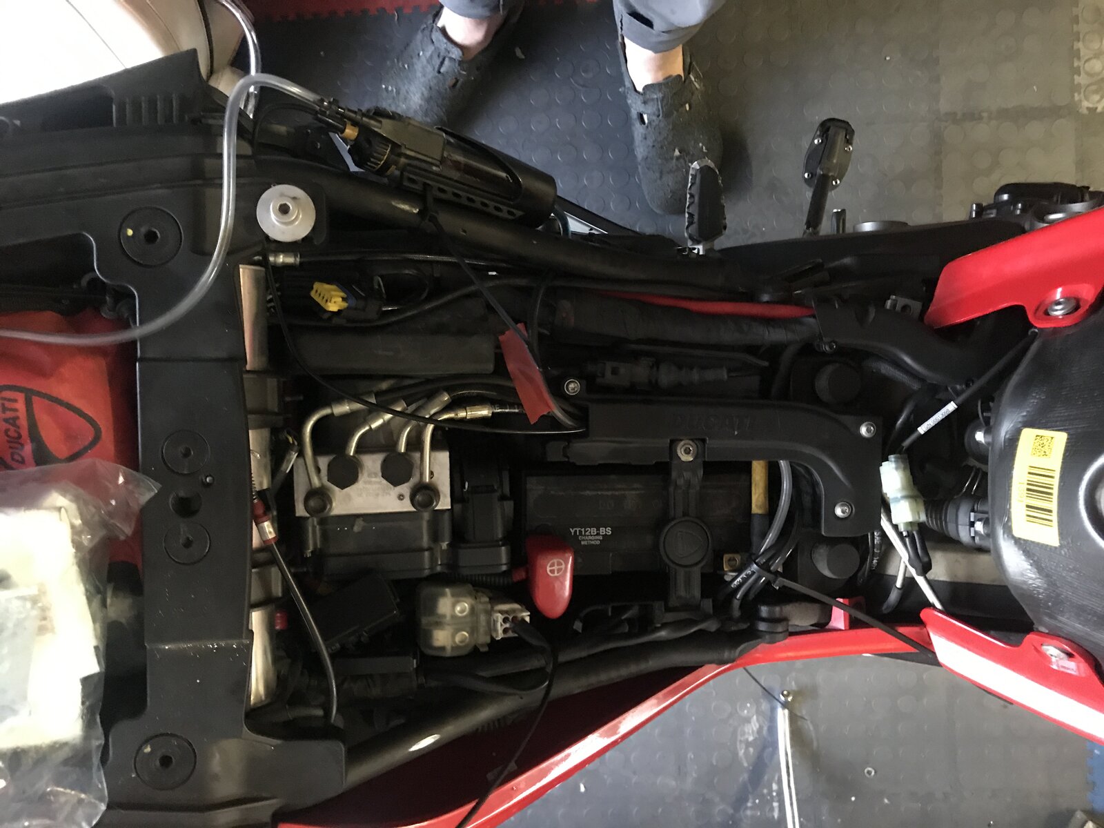

    I have fitted a scottoiler to my MTS, but wanted to sanity check the routing. I’m concerned that the routing might be too long as the flow rate is very slow, even when the SO is set to ‘prime’.
    How have other users set up SO on their 1200 MTS?
  2. Why not route it above the front sprocket? Take a read of the Cobrra Nemo thread and see where the dude there routed his. I copied him.
  3. I did a similar routing on mine and it was fine
  4. SImilar to which routing?
  5. To the routing you took with yours...
  6. I stuck with my original plan, but routed the SO oil line so it had a constant downhill.
