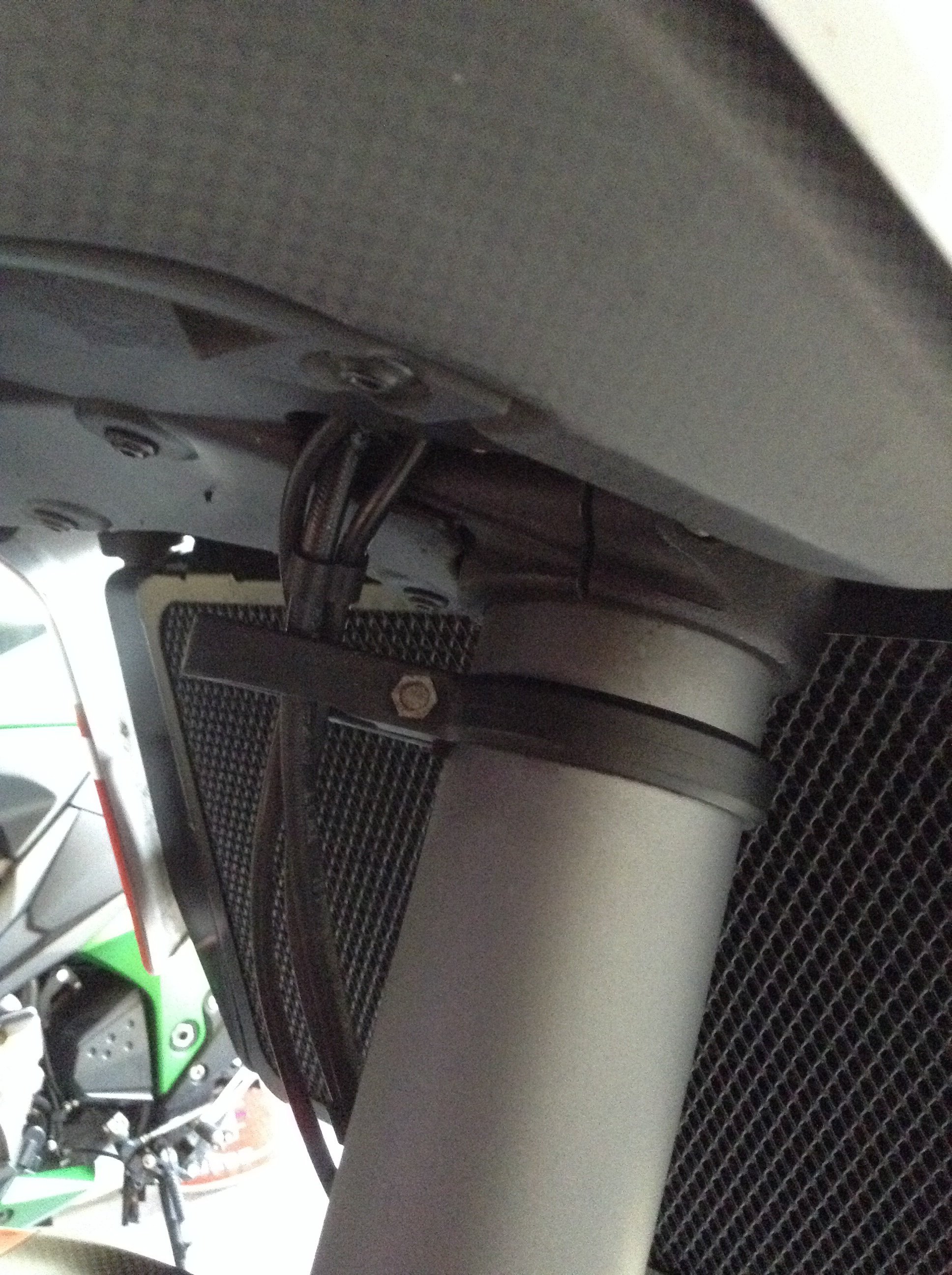

  8. Mine rubbed on my pp after a month dealer changed fork leg under warranty and put a black plastic stay on leg to keep cables off it all good now:)

  14. Hi Melvin
    I have the same problem
    Can I ak what kind of plastic stay they fitted ...could you possibly post a picture please :)
  16. Hope it helps chvcky
  17. I used a pair of 'cable ties' at the base just above the front hugger. Pulled the cables away nicely, then got Ducati to replace the leg under warranty
  18. thanks for the pic, got a parts number by any chance?
    don't have any marks on my 2012 MTS-PP fork leg yet after 2+ years hard riding but would be interesting to find out about fitment of the pictured black cable stay onto the Ohlins MTS forks to prevent any rubbing.

  19. Hi Melvin
    Thanks for picture and reply
    Are these a Ducati part do you know where we could all get one please ?
    Thanks in advance :)
    These look just the job so perhaps if youre not sure could you let me have your dealer and contact and I could phone them ?
