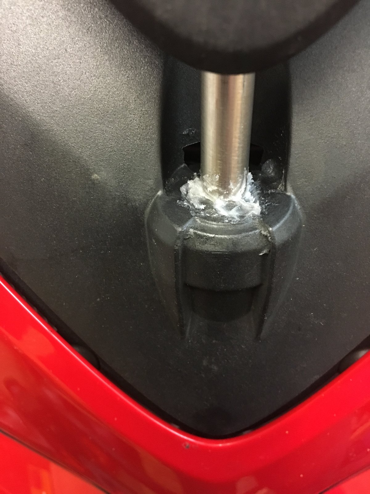

  10. DVT Screen.jpg Last year I worked a little Vaseline into the top of the bearing where the rod passes and it seemed to work the rattling stopped. I've only ridden once this year and the rattle has come back so I've just repeated the process - only takes a few minutes. No guarantees but could be worth a try. I should also say I have the small racing screen so this may make a difference to those running the bigger touring versions. It doesn't feel right to pay >15K and then have to solve these issues ourselves but the answer from my dealer was 'they all do that'.
