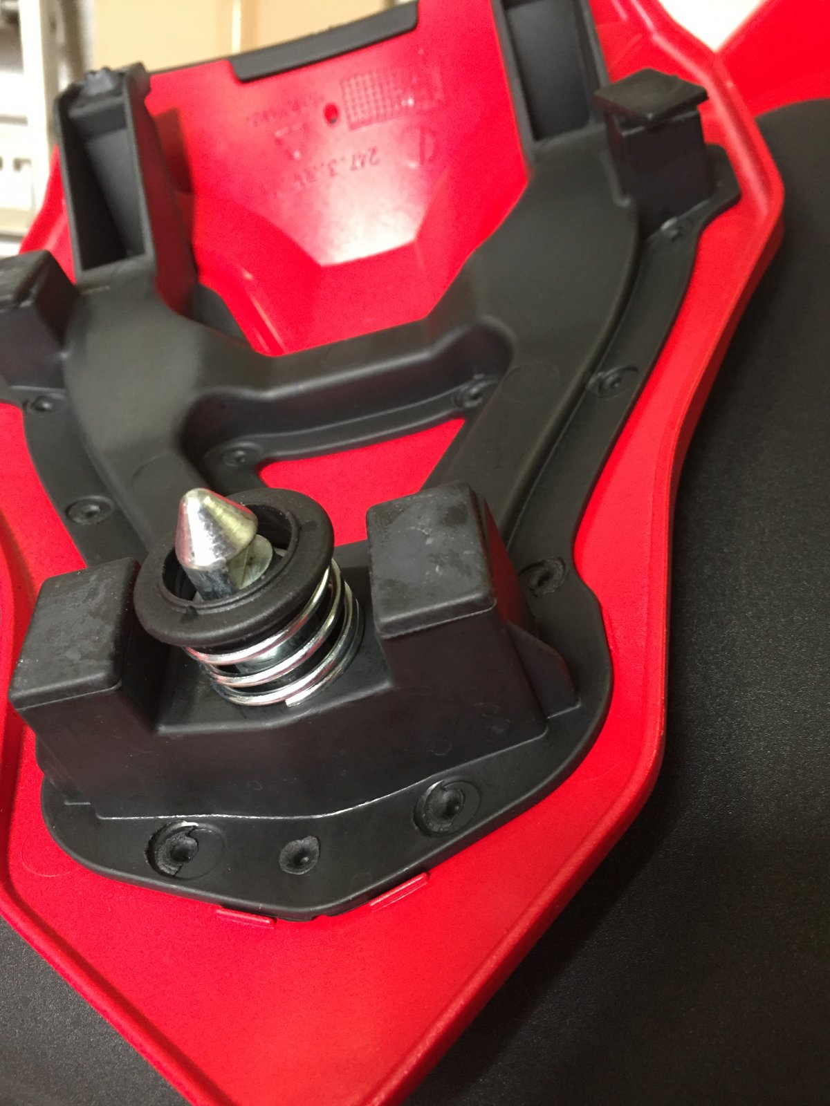

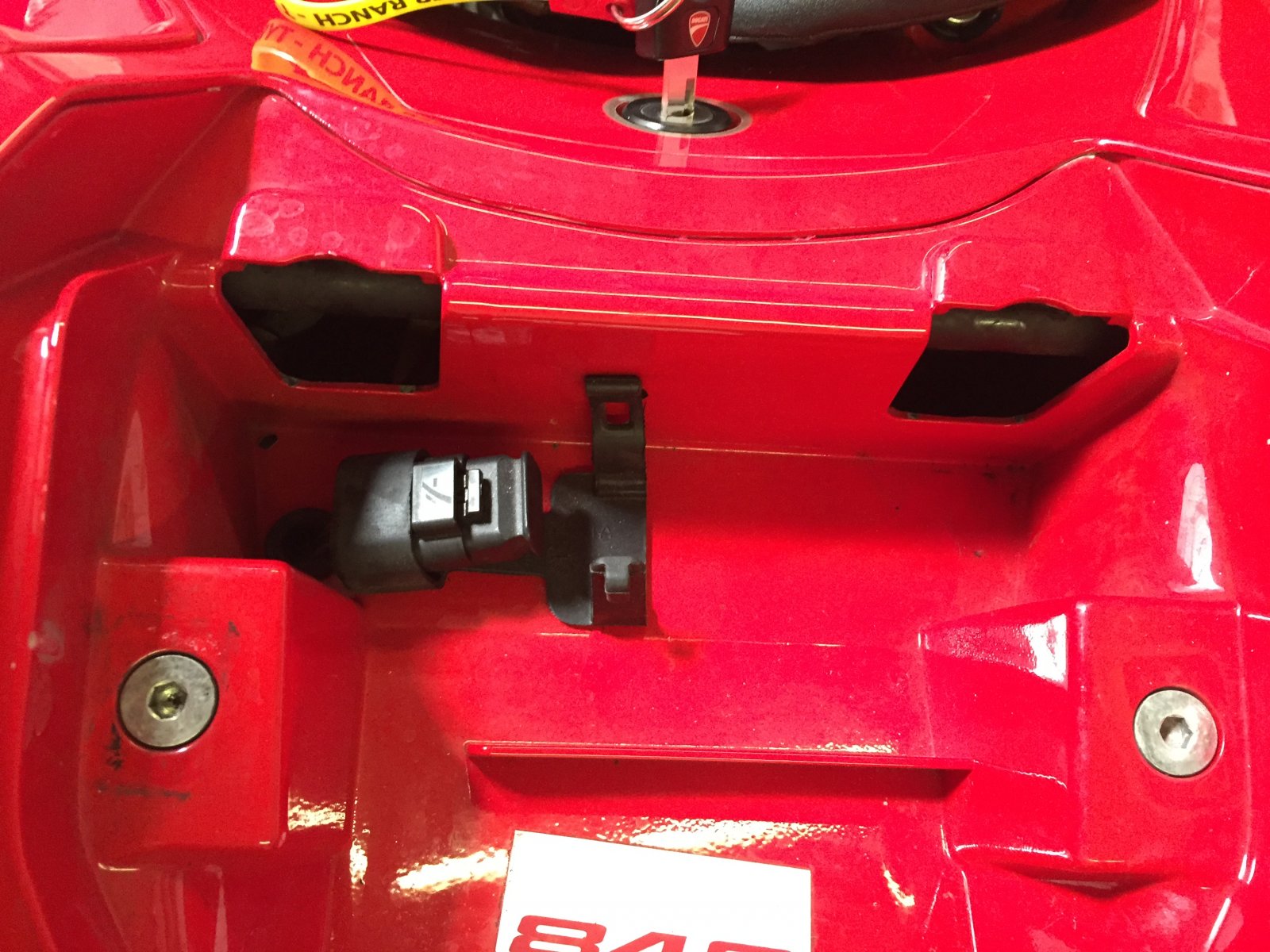

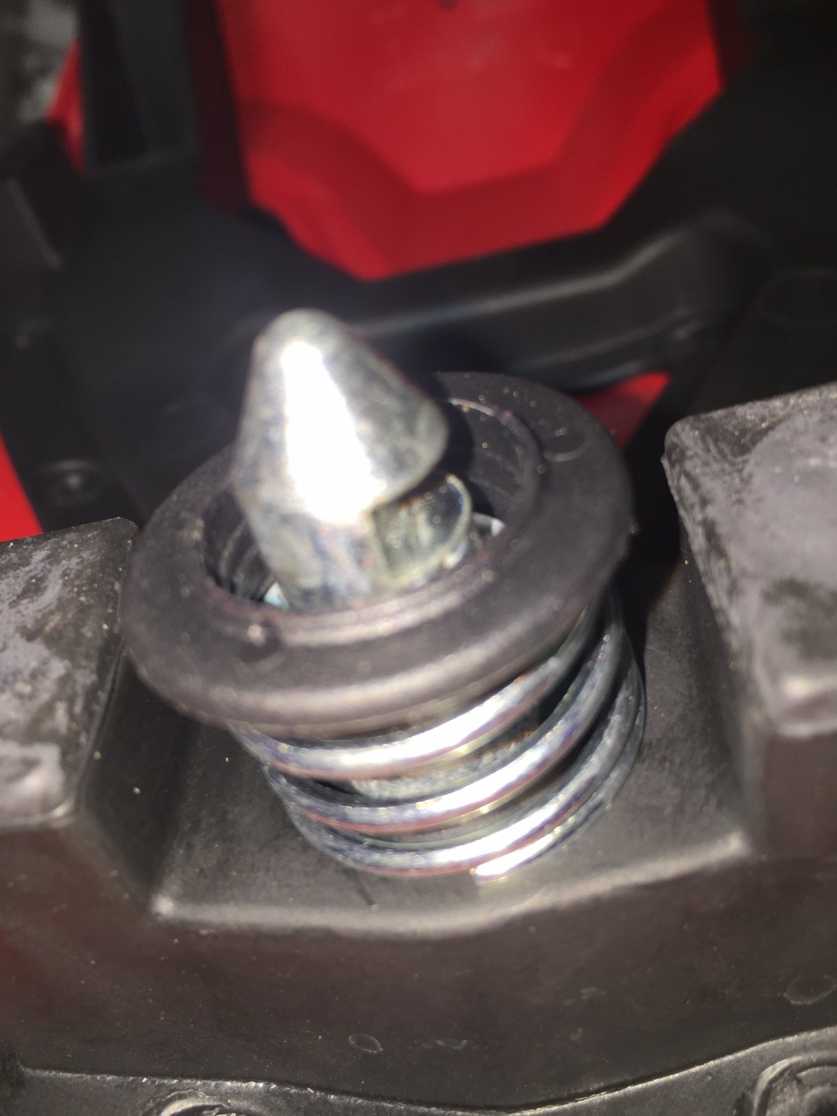

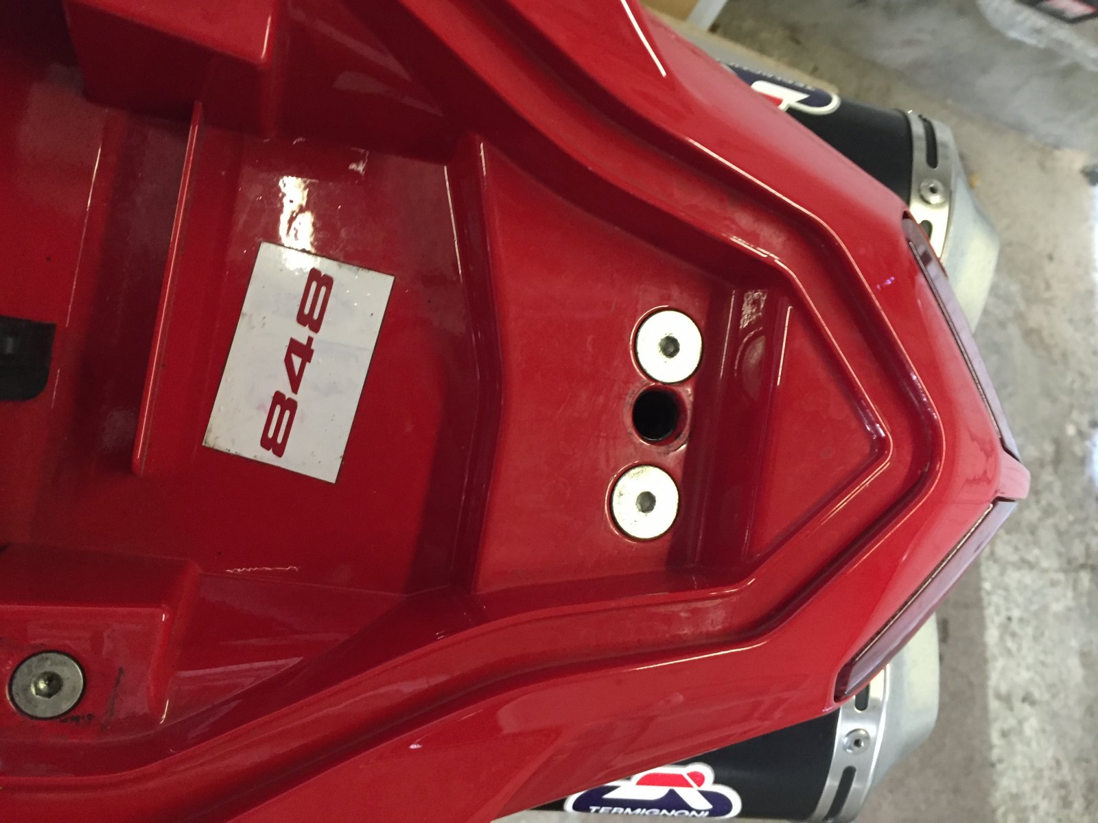

  4. I'll take some pics of the inside and the mechanism from my Evo. At least you'll know what you're dealing with rather than figuring it out blindly.
  5. That is really good of you, Jim. Very appreciated.
  6. Worse than I thought mate, can't even see the mechanism. Best bet would be to to remove the tail if you can - unless someone else has a better idea. Can't see how else you'll get in.

  10. Thanks for the images Jim... it looks very sealed.... :/
