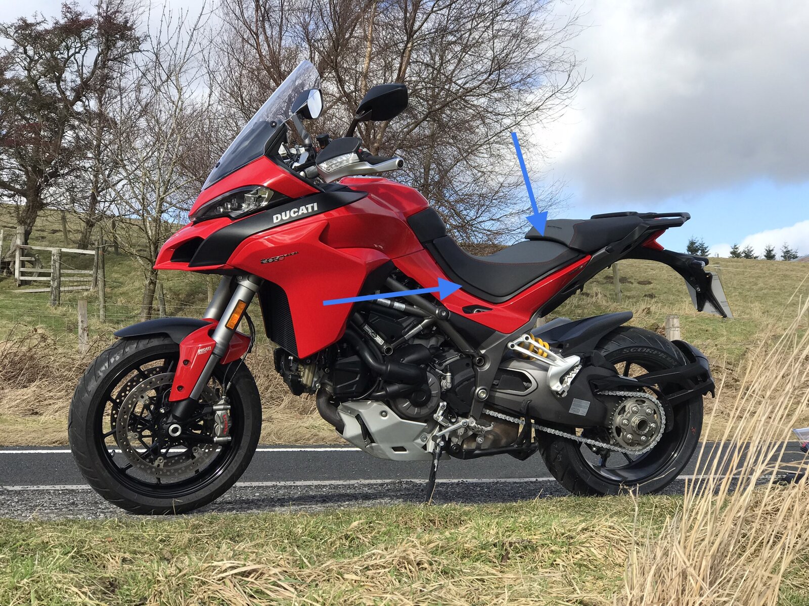

  1. Loving the new 1260......6 years of progress between this and my previous 1200S is very noticeable.
    Anyway, seat adjustment, if I want to lower the seat so I unbolt the two side strips on the rider seat? Should there be a spacer to fill the gap between rider and passenger seat? Anything else?
  2. You should have an infill piece that fills the gap between the rider and pillion seat. If you haven’t then the dealer may still have it somewhere or you will have buy it. £7 so not to bad!
