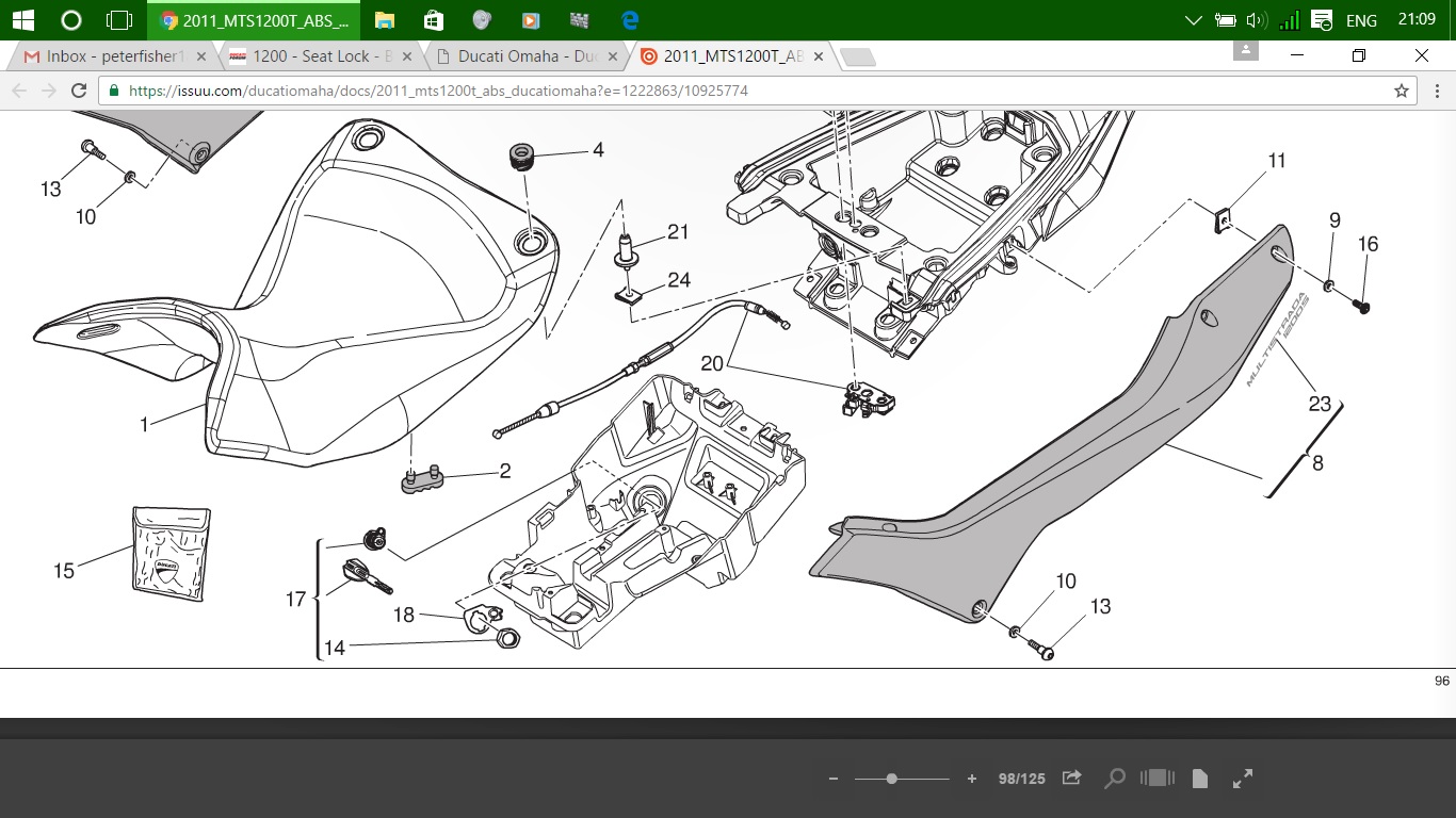

Sorry about that. Ive had a look at a workshop manual and it doesnt say anything about the seat lock removal or fitting. However, if you look at the lock mechanism, there should be a nut (number 14) at the rear of the lock which while looking at the parts manual it should just unscrew? I have tried to upload the picture from the parts manual but can't. If you log onto Ducati UK and you can have a look at it, link below. Ducati
Looking at the parts diagram (thanks @Pete1950 and @JimVee ) and at the bike it looks like the battery and some relay/wiring is on top of the lock - it cannot be accessed without removing them (definitely there is no access from below ) . Can I remove the battery without causing any ECU / memory problems or shall I connect another battery using jumper leads before disconnecting. Or to invest on a memory saver that connects via the auxiliary socket?

Job done! Quite fiddly and a bit time consuming as access is restricted unless the ABS control unit is removed, which I didn't want to do. I have attached a few pics just for reference for the next guy. You can see on the first one the cable disconnected. Easy to put back when the lock is removed but not when the lock is fitted and it has to be fitted before the cable is put back :disappointed:. @JimVee Thanks, had to reset the clock and set it back to mph. Trip meters went to zero but the LAP counter kept the timings from the last track day. All is back and all running OK. I cannot see how the cable came off but more than likely it will happen again :smiley:
