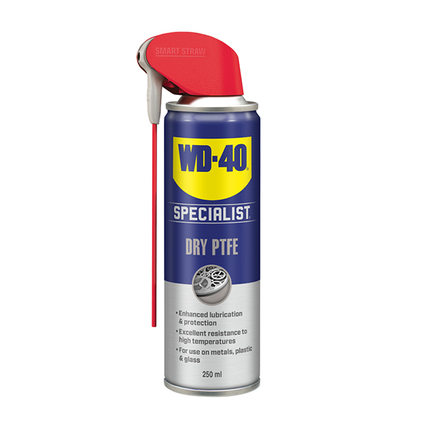

  5. I use a 'dry'ptfe spray (carrier liquid evaporates off almost immediately). Works for me.

  6. You need graphite lubricant for locks.

  10. Have the same problem on the ZSX. Besides using Graphite spray, I also place a small piece of insulating tape over the hole, to further protect it. It has not yet, blown off, whilst riding.
  11. As the one and only key supplied (excluding the red key which should always be kept safely at home) is very fragile I got another key made up which won’t break like the OEM one can and which I use solely on the luggage and seat locks as, yes, extraction of the key from the seat lock can be fiddly at times.
    Also, WD40 make a graphite spray specifically for locks.
