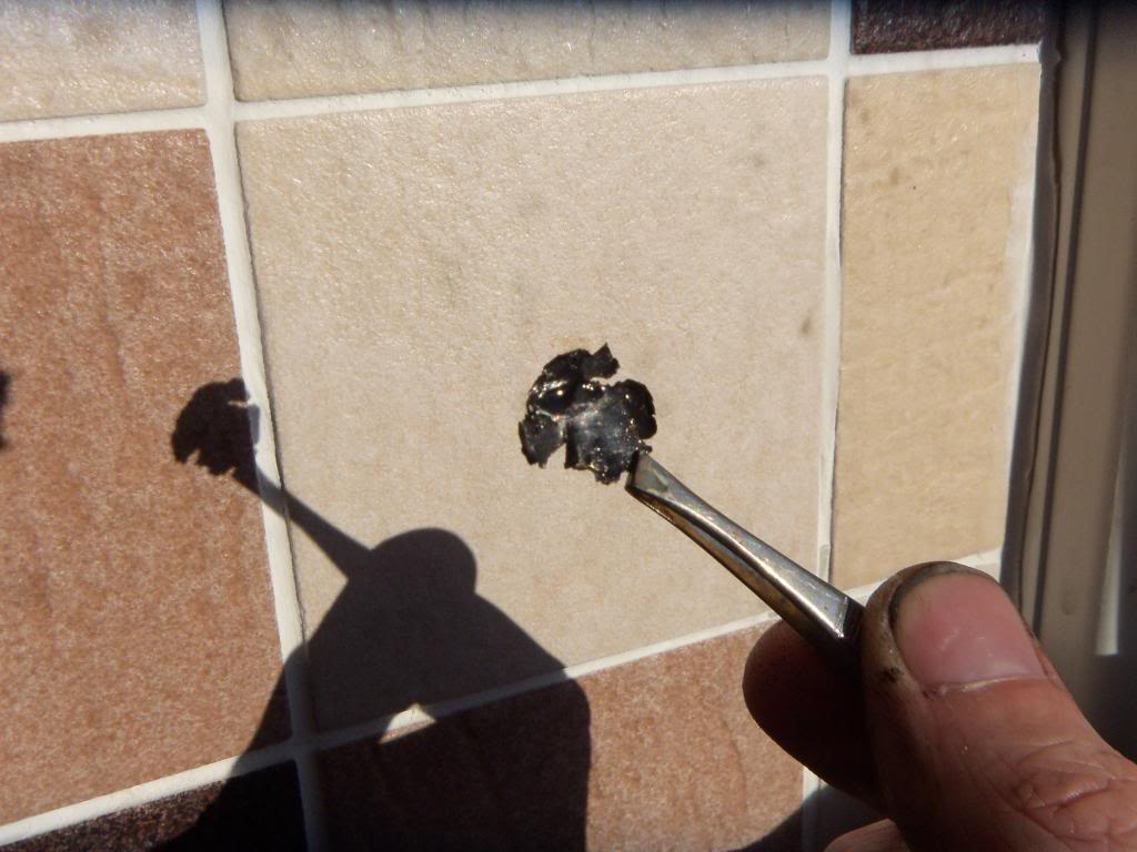

Clutch rod is out... eventually. Both O rings are there but crumbled straight away, mid shaft there's quite a bit of scoring. Dropped the oil, sump plug has caught quite a few metal flakes, one very big, 1p size. The rest just tiny. Striped the rotor/generator side down in order to knock the clutch rod a bit further out, involved taking the gear changer off so will just carry on with the strip-down.

What is the 1p size piece of metal made of ? Big end is my guess followed by one of the main bearings. With the bike in neutral does the gearbox output shaft turn when you turn the back wheel ?
Gearbox output shaft, the shaft the clutch assy is fixed onto? then yes it does. As soon as any gear is selected however the back wheel locks up. Have removed the spark plugs to see if that would help but no. Looks like bearing shell surface to me. Makes me feel ill...
