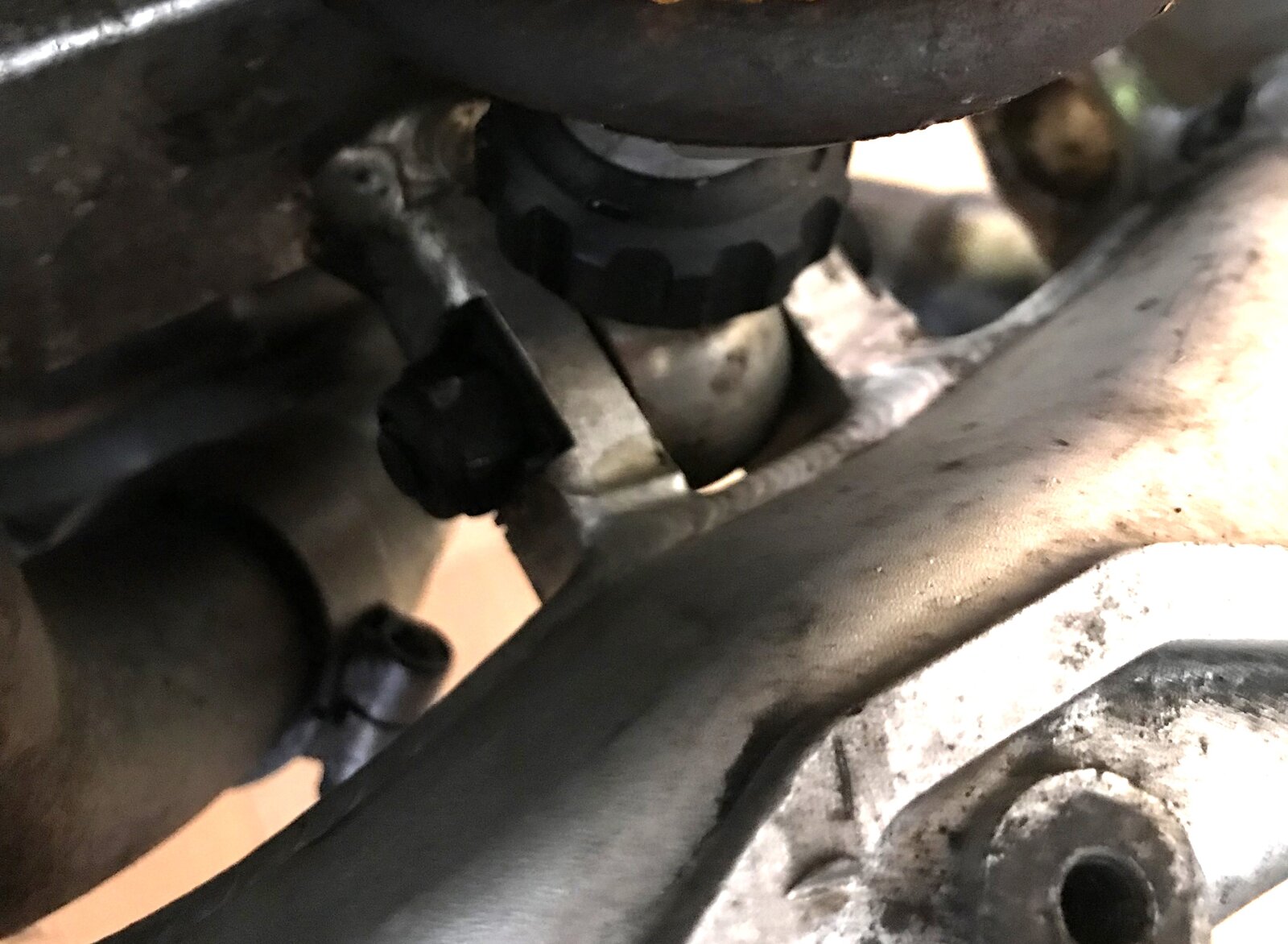

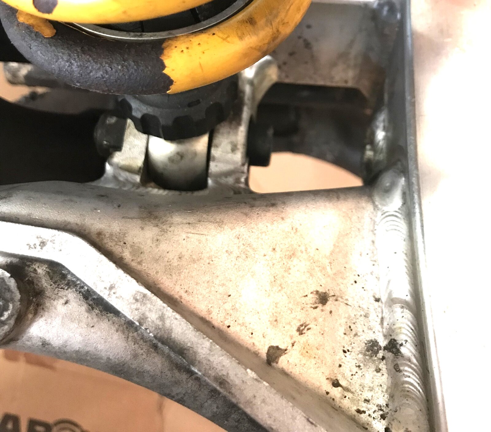

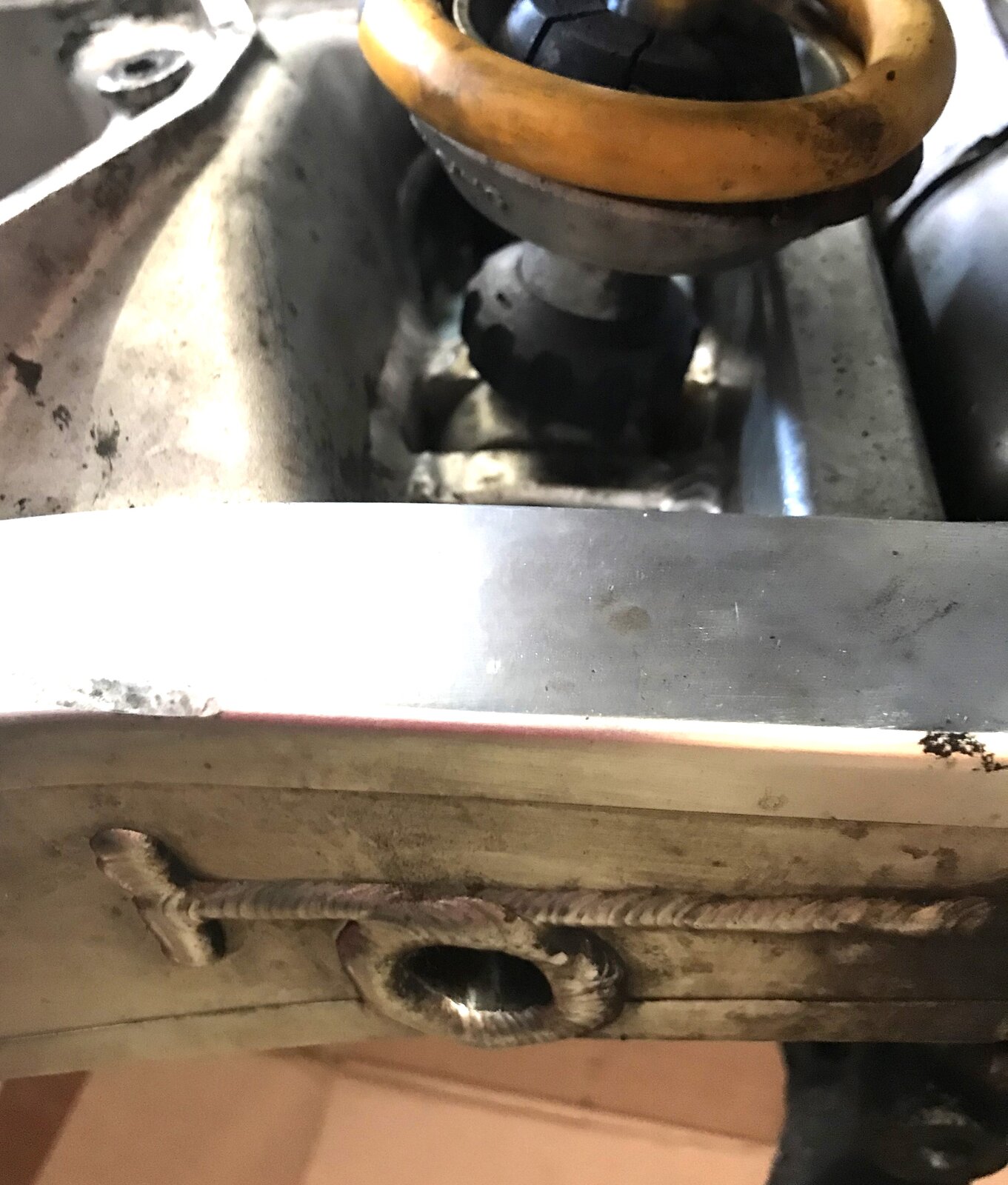

    Monster 900sie resurrection is underway, poor old thing is in a bit of a state, started taking bits off to clean / lube etc. The rear shock being very poor but has proved most unwilling to be removed, specifically the lower 10mm mounting bolt passing through the alloy swingarm and the lock nut sits in a very handy saddle washer that prevents proper attention.
    Suspect galvanic corrosion maybe an issue so I had to go all out medieval with heat, cocktail of penetrating fluids, impact gun (240v 450nm) breaker bar with scaffold tube attachment and still no joy to be found. It’s the old issue of trying to decorate the hallway through the letterbox.
    Before I dive into yet another rabbit hole and attempt to remove swingarm (those exhaust studs don’t look healthy!) with shock still attached, just wondered if anyone here had suffered a similar fate and successfully resolved issue.

    images added, bolt is 10mm socket head cap (allen)

  2. Is the problem the bolt in the ali hole or the bolt to the nut? Can you get the nut and bolt to spin in the swingarm hole? If you chuck up a photo it might help a bit?

  3. nut is held firm by saddle washer, zero movement on both nut and bolt.

  13. Could you get a Dremel in there to grind off part of the nut on two sides to split it? Drastic, I know....
  14. Another interesting thought, but not sure you would get the coils into such a tight space. Slitting the nut with a dermal worth a go if access ok. Once you make one slit through the nut you can usually unwind them.
  15. Looks like you could just about get in there with a hacksaw blade and cut the nut.

  17. hold the bolt and attempt to release the nut, this should minimise the deformation of the Allen head.
    all good points above, I would now obtain a new bolt /washers, and see if you can get a nut splitter on the nut.
    even one side of the nut split will enable you to attack it from one side with a chisel and open the nut.
    this should then reduce the stiction on on the bolt.. best of luck
  18. Plusgas and time is your friend, also consider splitting the nut with a long skinny cold chisel, common practice in industries where you can't use power tools or a gas axe (if it's liquid it's not tight) sometimes the impacts can rattle things loose, I had a similar problem with the bottom shock bolt on my s4rt, the allen bolt (in a blind hole - thanks ducati) was loose fast - it was fully unscrewed but binding on the bottom shock bush and try as I might I could not remove it, a couple of times I had to walk away from it for fear of completely losing my sh*t, it really tested me and I questioned my sanity, so I feel your pain, I ended up welding an easy out (screw extractor) to a slide hammer and managed to remove it, quite brutal but got the job done, good luck.
  19. If you’re taking the shock out, maybe take out the swingarm and bring the shock with it? It’ll be much easier to sort on a bench. It’s an easy one to remove.
    Be careful of putting too much heat in the area. Localised heat on the nut if possible will help, broader heat in a bigger area will damage the shockinternals and or the swingarm as it’s alloy.
