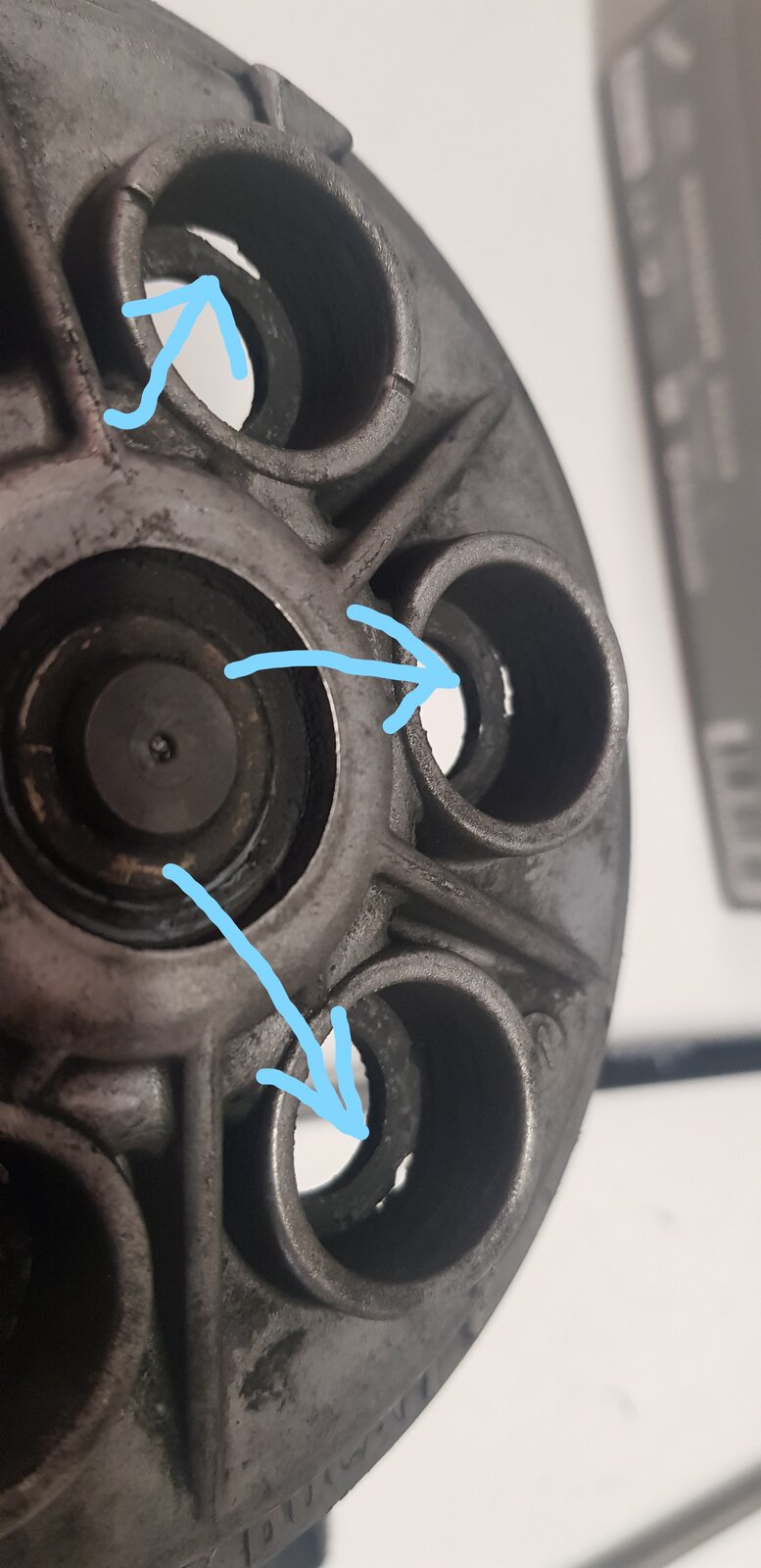

At this stage not well. I fitted an MPL (Germany) many times without issue. I can't get the Oberon to work. It could be coincidence with something else not working. I found my pressure plate near warn through so that did not help (attached) Oberon technical help have been very good calling me on 3 occasions. But I have to return everything back to stock and eliminate each link in the chain one by one. Time is limited so this may not be for 3 months yet

Thanks Sev, All checked. System bled around 12 times - no air seen. Now i am looking to the master as a possible source for the issue. I adjust the lever screw unitl there is no more movement but still no luck.
Thanks again Sev, spacer fitted at one stage in a "try anything and everything" mode. But the slave would not go on then. EOM and MPL did not need spacer and measurement confirms this.
Thanks Sev, I shall add that to the list! I am annoyed at myself because this is normally a 30 min job, but I forgot most 30 min jobs can be 30 Hours if something goes wrong. Unfortunately with limited time this adds up to the bike being off the road most of the summer. THIS is why I have two bikes!
