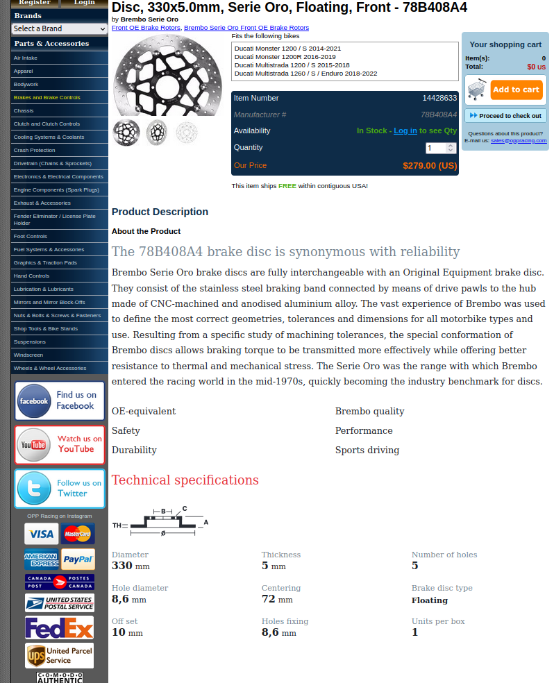

  8. The 78B408A4 brembo number isn't a 330mm Serie Oro disk?
  9. Definately available as a 330mm pair for the DVT. I put them on mine and massively better
  10. Yea, I fudged up, but so far, these are hugely better than standard, so they will stay for now.

  17. Yes they are 330mm
