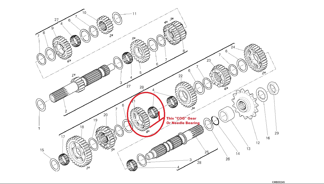

  10. Sorry to say, from an engineer, I think your missing a tooth or two somewhere in the 4th gear train, or the roller cage has collapsed and it spinning your cog off centre.
    I honestly cant see how it would only affect 4th if it was the chain.
    sorry to scare monger but that's my thoughts.

  16. Not the box as it's just 4th?
  17. What an annoying twat, Gears are what a group of "cogs" make. i.e if you have 2 or more "cogs" then it becomes a gear or gear train. As I was talking about single "cog" on the lay-shaft then I chose "cog" so not to confuse people into thinking I meant the whole gear train.
