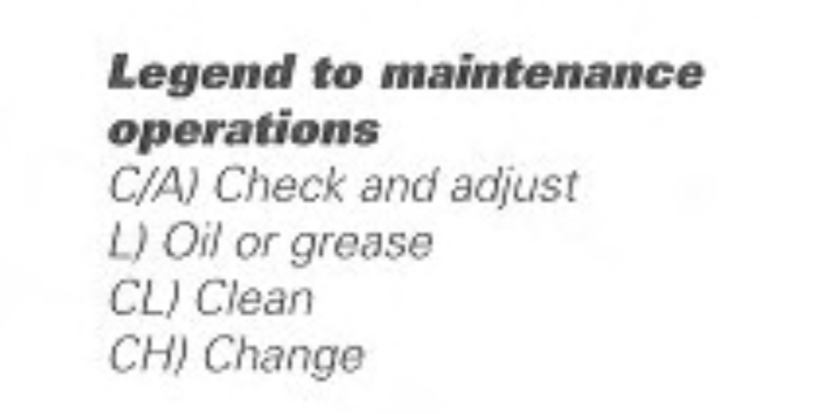

  4. Here you go:
    - 916 workshop manual, 1994 edition:
    - 1997-1998 Update:
    6095C24E-FC4B-4A7F-93CF-155AB6851AEE.jpeg D234CC39-8121-499A-9768-6302C094A4B2.jpeg
