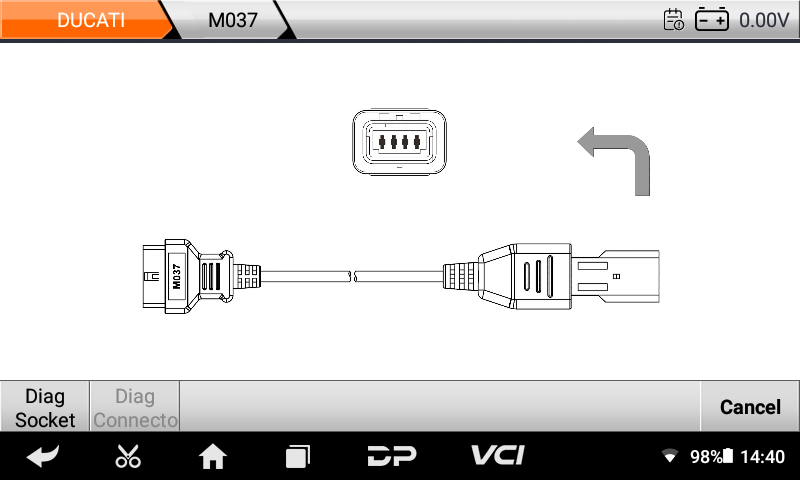

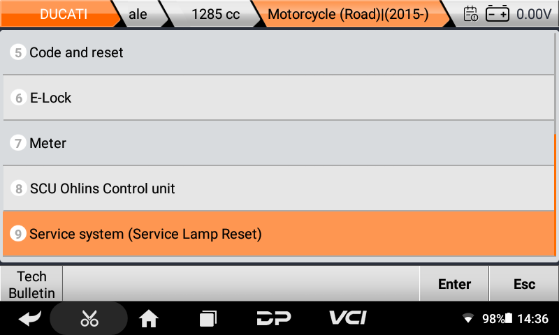

Adam, I'm in Cheltenham and have an OBDStar diagnostic unit, not a million miles away from Oxford. Have used it to reset the service indicator on my 2018 1260 Multistrada after I had a trusted independent do the Desmo service. Let me know the exact model and year of your 1299, pretty sure its on the list. Can check in the morning.
Hi Adam, yes, can confirm that the MY2015 1299s is listed as compatible and uses (like all modern Ducatis) the M037 connector which I have. I've just updated the firmware on my OBDStar so it has the latest features and models. Just send me a PM to arrange to come over and have it reset. Obvs you absolve me of all risk/culpability in plugging this device into your bike and carrying out the reset. Need to do a service reset on my Multi, now that it's due an oil service on time since the last reset for this by a franchised Ducati dealer over a year ago. The indi that did my Desmo service late last year also did full fluids and filters at the same time (wanted all this done ahead of a trip to Corsica) so in reality I'm not due another oil service until this September. Please note that service indictors cannot be reset ahead of them coming up on the dash and the required mileage or time being reached. My Desmo service was done a couple of hundred miles ahead of time so I had to tolerate the indicator for this being on for most of the duration of the trip despite the actual work having been done. Pretty sure that when resetting the oil service you can set the date that the next one is due on time. So you can reset the indicator after the event. As my bike has been in the garage over the winter the time expired a couple of months ago on this. Will check that as correct, or myth, once I get around to doing it... Using the OBDStar diagnostics tablet I obviously can't apply any firmware updates from Ducati, you need a franchised dealer with their proprietary connection to the factory to do that. I figure with my bike coming on for 5 years old that's not really necessary as it's running sweet/the way that I want it. For example; there was an update a couple of years ago for the Multi extending the hill hold time from 10 seconds to 30 seconds, I wouldn't be able to enable that as it's change of firmware. However, the tablet does make it possible to enable factory accessories, that require it, such as heated grips, spotlights etc. for models where the people responsible for the OBDStar have incorporated this. These are 'switches' incorporated into the existing firmware. Not all features are available on all bikes though. IIRC the 2015 Multis couldn't have spotlights, or was it heated grips, enabled but the 1260 could. They do release software updates adding such things over time though.
