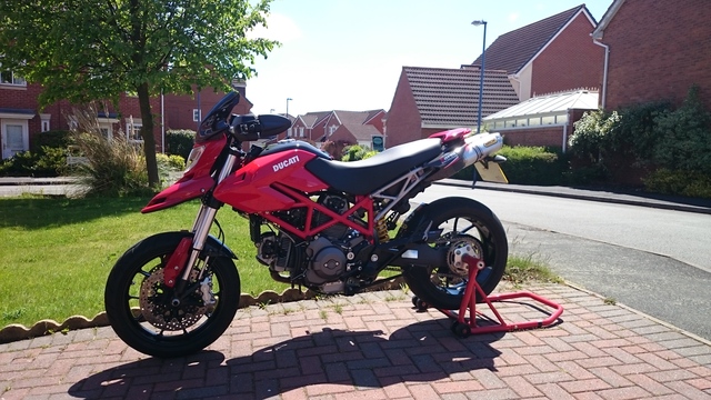

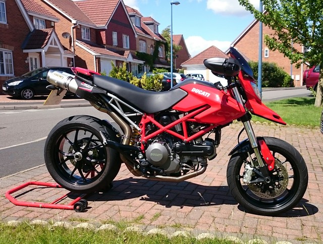

  18. Well I may as well put some pics of the bike up:
    I use it as my daily commuter, however the Arrow system was just too noisy and as the bike did not have the correct map ran a little too lean at low RPM so throttle response was not great.
    I am selling the Arrow system so PM if you are interested.
    I am also going to sell the carbon bits which include:
    Carbon Hugger
    Carbon Front Mud Guard
    Carbon Exhaust Covers
    Carbon tank Cover
    Carbon Chain Guards - Mid and Rear
    The parts are nice but I don’t really need them as the bike is a workhorse.
