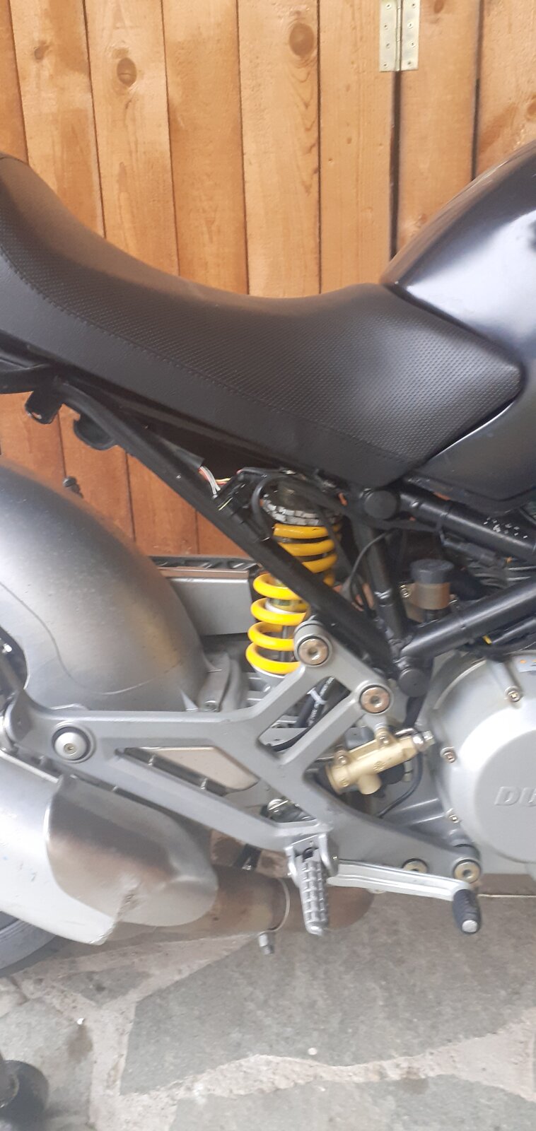

  17. Well finally took a look at that rear shock and it's not a happy tale as someone had brutalised the castle nuts. I had to use the same method to try and unlock the top nut and did eventually get it to move slightly but it was taking the bottom nut wiht it. Then I tried a scissor type oil filter wrench and managed to unscrew them slightly and eventually they did seperate.
    Had to use penetrating fluid on the shock body threads and scrub with a toothbrush then when they were seperated got a file and filed off all the burrs that I could. The tension on the spring was quite wound up as when you lifted the bike upright off it's side stand it did not sag at all and if you tried to lift the back of the bike there was no movement is was already right at the top. So had to back off the pressure so we now do have a bit of movement when the rear is lifted and sag with me sat on it is between 25-30mm.
    Another oddity is that I cleaned the screw first again the screwed in the damping adjuster to see where we are set at and it took 16 clicks to reach fully in I then unscewed it and got quite worried as it went past the 22 clicks that everyoone says this shock has and it just kept going it finally stopped at 35 clicks :scream: have wound it back in and counted again and yep this shock has 35 clicks of adjustment o_O . So have set it to 17 clicks which is about where it was before and we will see how it feels when we can eventually ride it on the road,

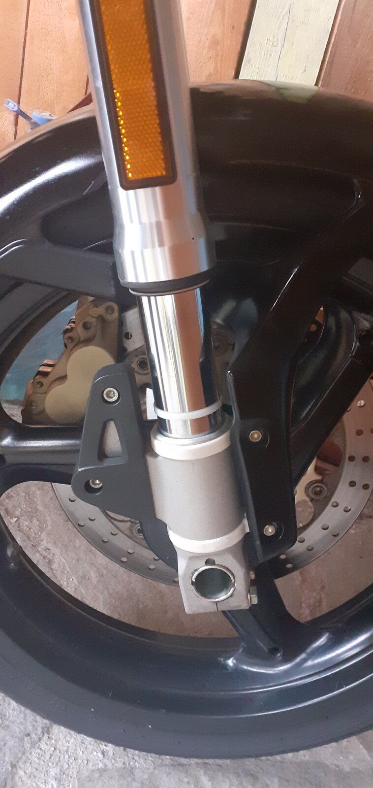

    The front forks had a lot of sticktion so lifted the fork seal with a small screw driver and shot a bit of aerosol grease under them the dust seal really could do with renewing however there is click or slight knock on the front that have not been able to track down. First thought was head stock bearing dry/rusted but you can usually feel that in turning the forks left-right and rocking the bike on the front brake there is not knock felt on the top yoke (Triple clamp) going to have to ask ML Racing to have a looksee if I can get it booked in with them after we get it re-registered.
