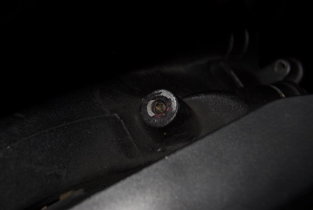

    Anyhow, whilst washing the beastie I noticed the guard was loose.
    A closer look revealed that it was only being held in by one bolt where there should be three. Two on top as below.

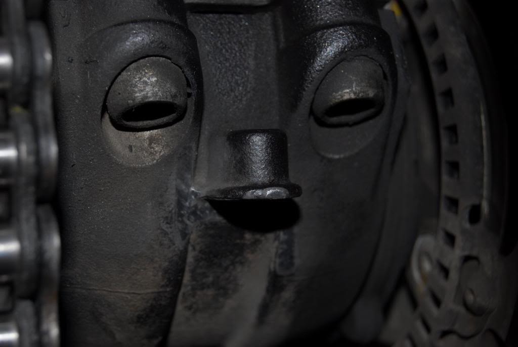

    and one underneath
    Underneath bolt was missing and the left hand top one had sheared!
    Feeling is that bottom one has come adrift allowing the guard to flap which has subsequently sheared the top bolt.
    Im pissed as this guard has not been off the bike since Iv'e had it and I'm due to go to Germany in two weeks and wont have time to faff drilling the old stud out so ill have to go with two. I might even leave it off for the trip.
    I would have thought they would have been loctited in? All i'm saying is check em when you clean the bugger!
