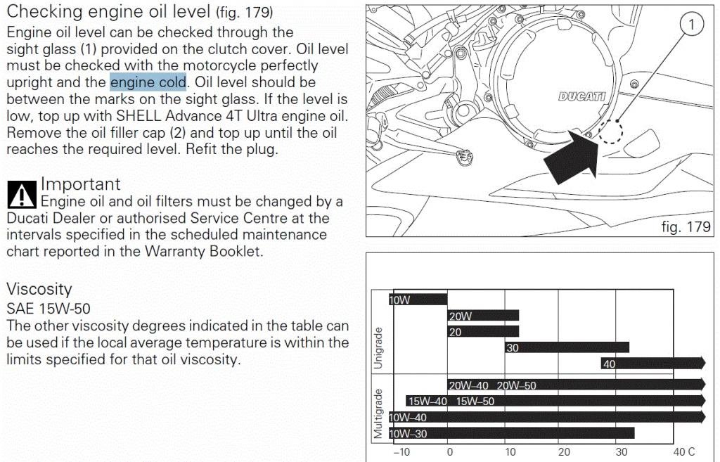

  7. Spoke to the dealer who said I should be checking oil when the engine is warm. I'm sure the manual says to check it when it's cold.
    I always thought oil got thinner when warm. The dealer says oil expands when it's warm.
    Better read the manual again I guess.
  8. Hot engine or cold when the level was taken?
  9. It was cold. Ill run it tonight hopefully, let it settle for 5 mins then read it again.

  10. I'd speak to your dealer, but some oil usage during running is to be expected I'd say. I do remember the first panis did use a bit and smoke too during running in.
  11. Yeah the dealer did say that it's possible that some oil would be used during run-in. Just checked the manual and it says to check whilst cold. Irritates me that the dealer said to check it when warm. So who's right, dealer or the Manufacturer?
  12. Very interesting,sorry to go a bit off thread but I recently changed from rock oil to silkolene,when using rock oil I never used a drop between oil changes ,now on silkolene I am using about 300 mls per 800-1000 miles,but has just gone past 40000 miles so I was getting worried,seems that it could just be the brand of oil?Hope so,time for another oil change so will go back to rock oil and see.
  13. Well checked the level again tonight after a short run. Oh look the level is lower. Manual 1 dealer 0. :frown:
  14. Quite honestly,the oil level will reasonably accurate after say 5 mins at rest after a ride.
