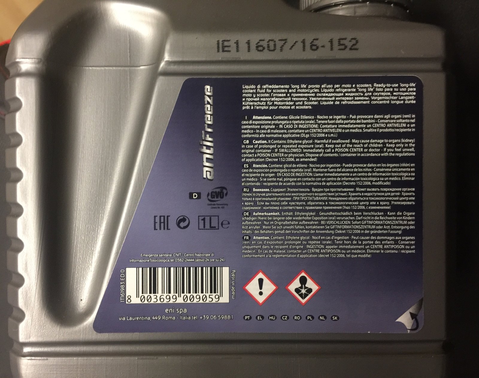

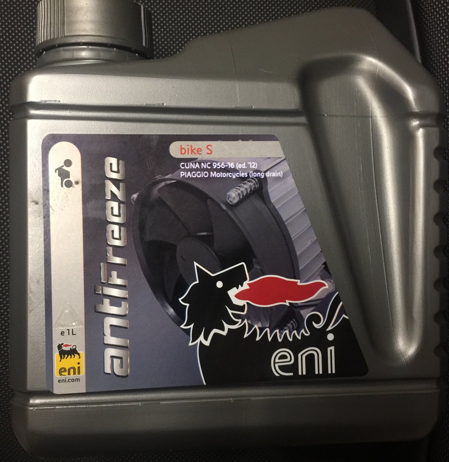

  4. I can’t see it, people seem to be using

  6. Blue is the old spec coolant. The new OAT spec is pink/red. They don't mix, or at least shouldn't be. The OAT has a longer life span of 4 years vs. the old 2 year schedule.

  8. The ENI Agip Spezial Permanent coolant that Ducati are currently recommending is almost impossible to obtain in the UK. Looking up the ENI spec says it is a pre-mix "Ready-to-use ‘long-life’ coolant fluid for scooters and motorcycles" and is OAT based. So the Motul or any other similarly spec'd OAT based antifreeze should be OK.
