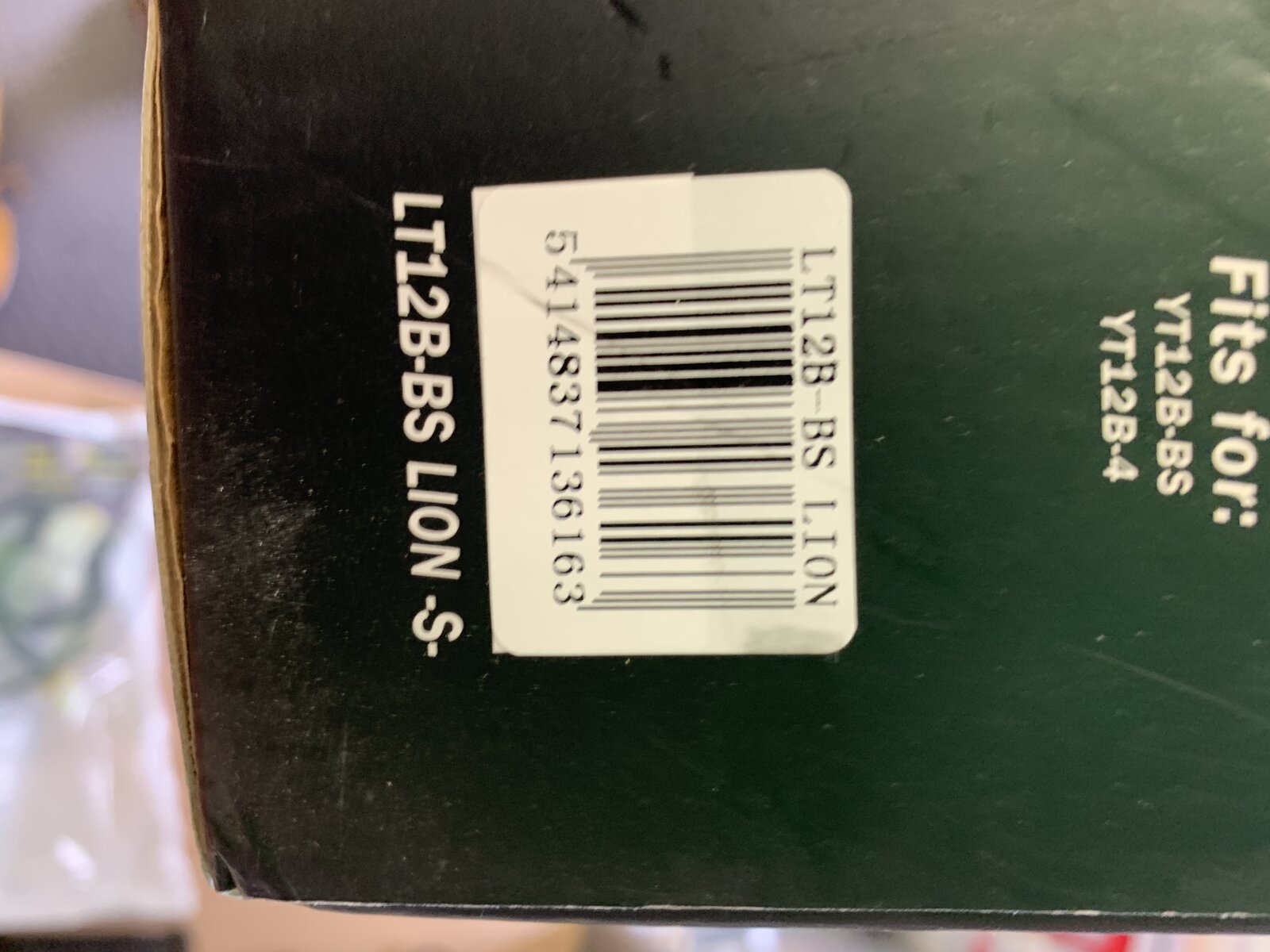

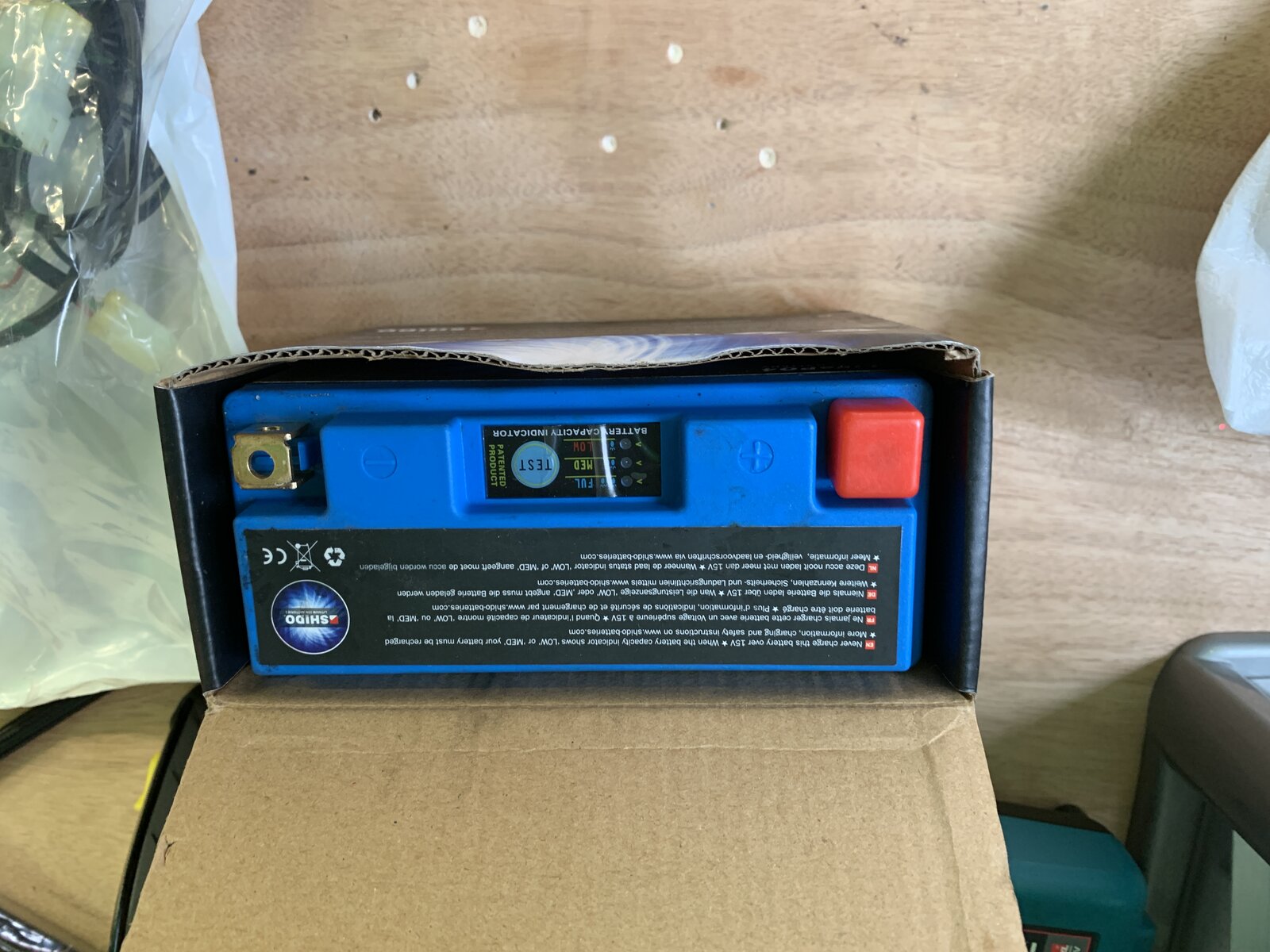

  1. very good condition
    Amazing weight saving
    Fits monsters, multistrada, superbikes pre panigale
    Check number please
    £70
    AEA0A0DC-514B-49F5-806A-DF4FC2D6234A.jpeg F88C4AFA-22FD-479E-87A7-1DBF776AAA65.jpeg
  2. Still for sale
    Massive improvement over standard
    Fits lots of Ducati’s

    The SHIDO Lithium battery is equipped with a LED indicator that checks the voltage of your battery. When pressing the “test” button it will show you the status of the battery. With three illuminated LEDS or ‘Full’ everything is OK, with two lit LEDs or “Med” is preferably to charge and one lit LED or ‘Low’ you have to recharge the battery.
