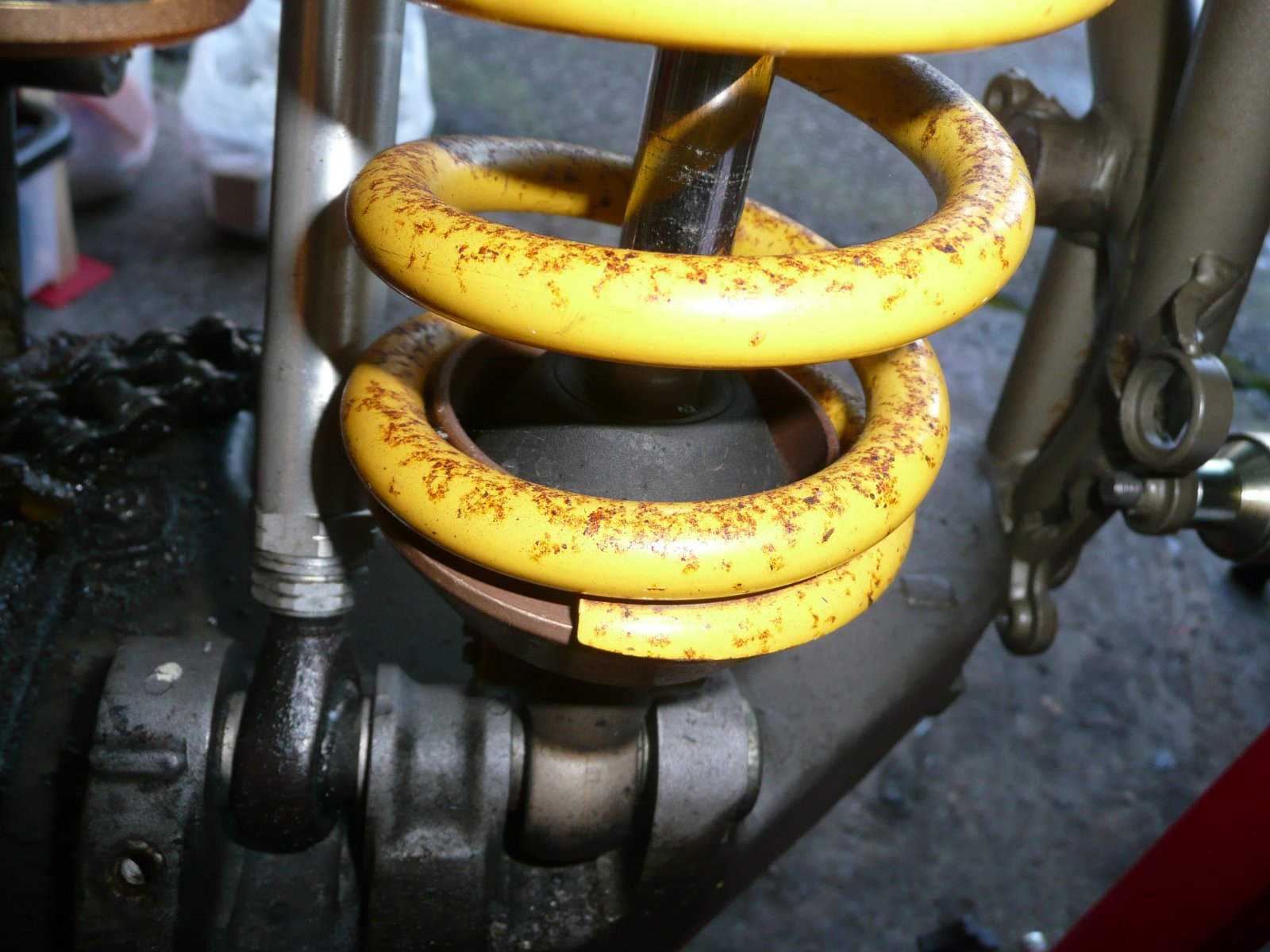

My rear shock spring (standard OEM Showa) has a frosting of rust so needs a little bit of TLC. But because it's going to be flexing in normal use, is paint OK, or do I powder coat, or something else? Your thoughts appreciated.
Thanks Ricky. Was worried that paint+flexing=flaking but if you've tried it and it works I might try it myself:thumbsup:

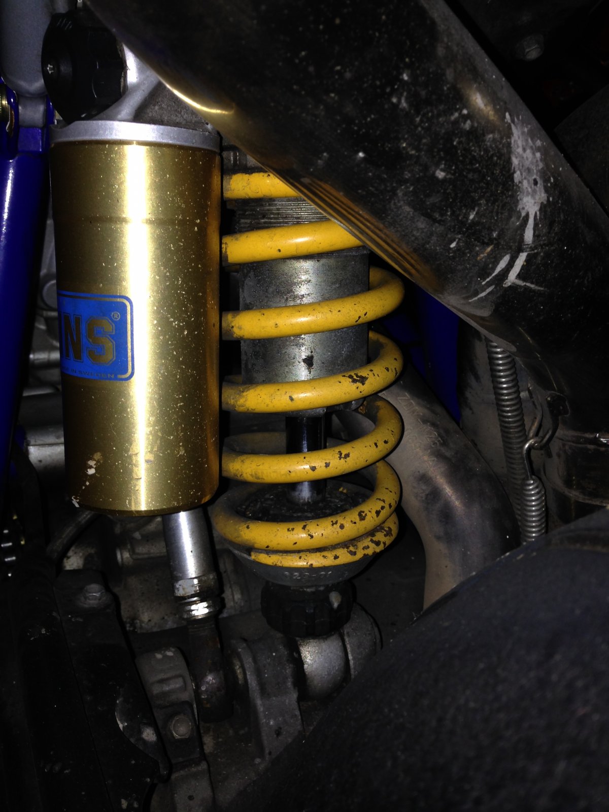

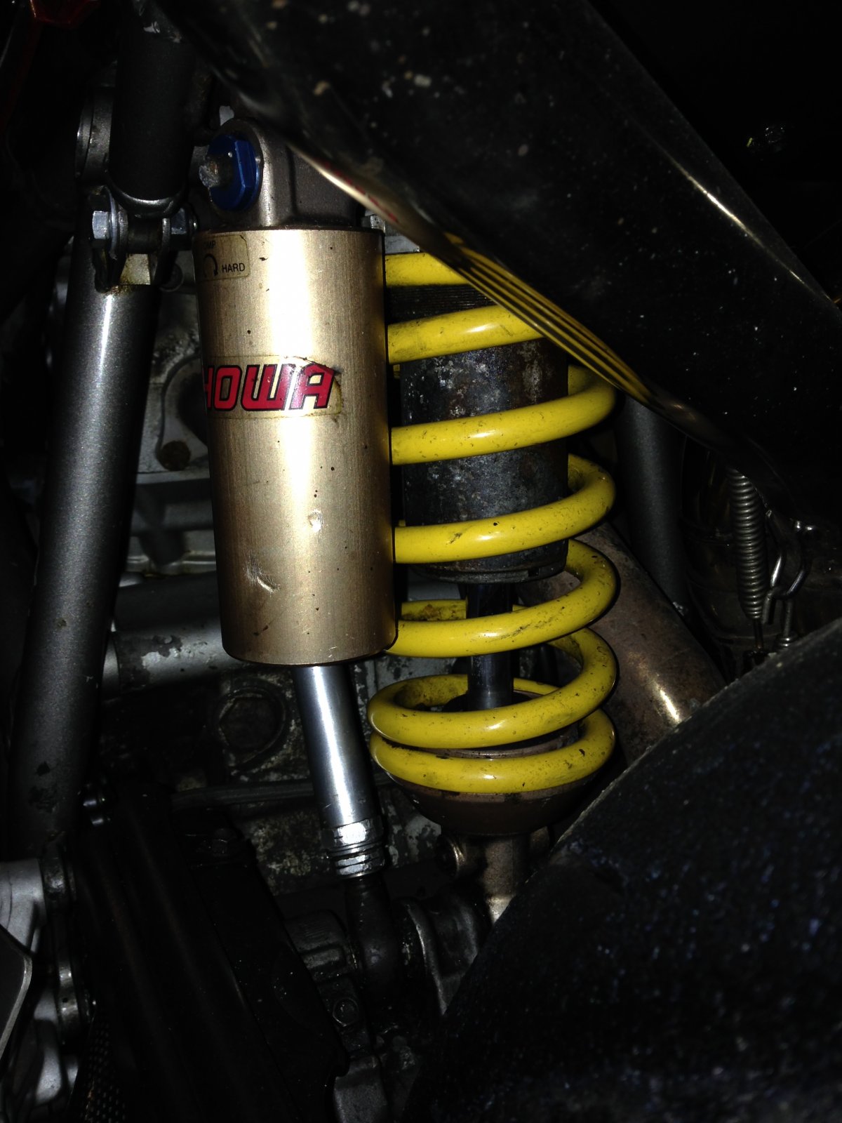

The Showa on my 748 was far worse than that, got it blasted & powdered, it's stood up to the elements better than the ohlins on the 998
Thanks Toby. Paint worked for Ricky, powder worked for you, so maybe I'm over analysing. Thought I'd have to do something fancy/smancy like shrink wrapping but I'll sleep easy tonight :handfist:

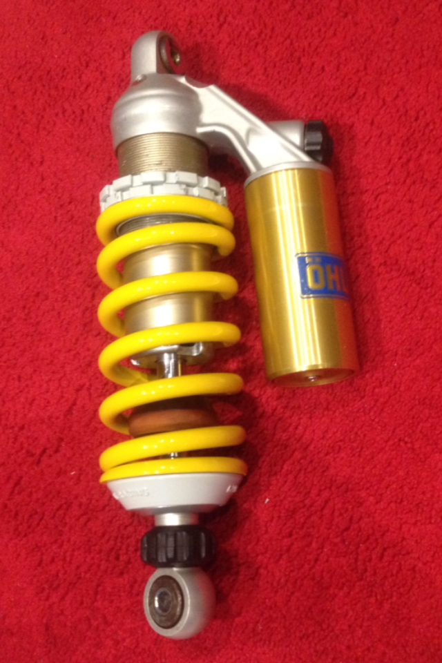

^ that's where I am with mine at the moment. Did you take the shock in for service then when they had it dismantled, you painted the spring and shock body? Just trying to work out which is the best way of doing this... Looks like yours came out mint, BTW, @VtwinDave Cheers, Ian
