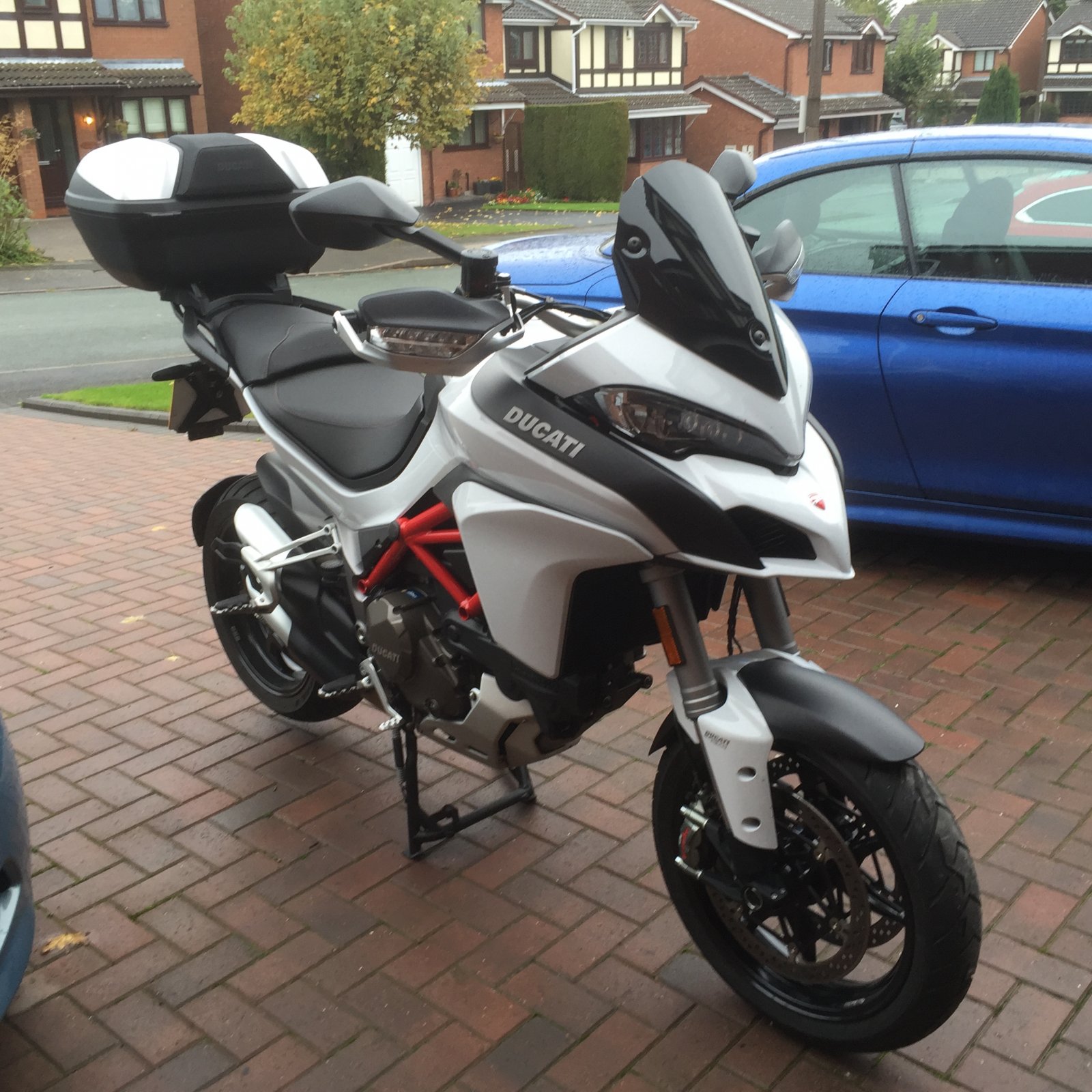

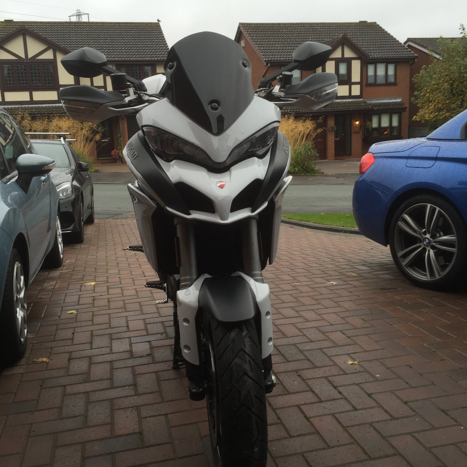

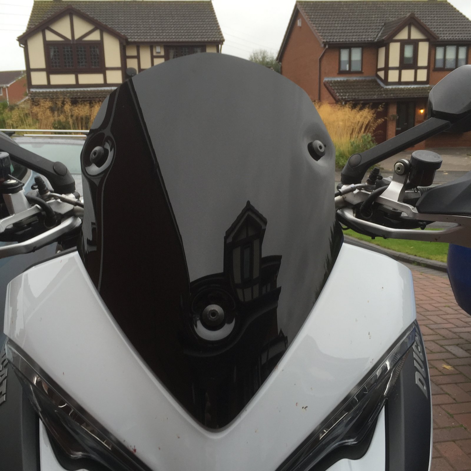

  1. The close up photo looks like a sheeps head... The wife has now called my Mutly... Dolly BTW it's a massive improvement, love it !!!
  2. Have you rattle canned the inside of the screen !
    Looks ace job [emoji106]
  3. Sprayed with satin black enamel paint. Looks as good as any bought screen

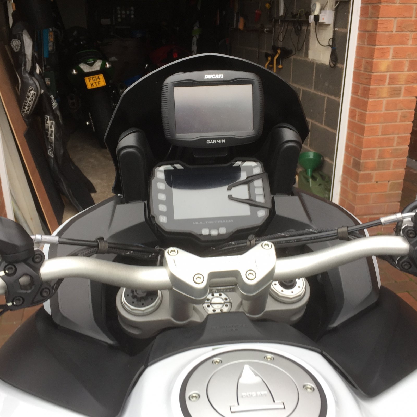

  4. I like the Screen..very smart, how did you fit your SatNav? I am just researching now
  5. Hi Bashafoc... The sat-nav is fitted onto a Navihalter bracket. There are other threads on this subject on the forum or just google Navihalter. I had my sat-nav originally on the Ducati handlebar fitment but didn't like where it was.
  6. Thanks for the advice.....I had seen the other threads. I thought how tidy it was!
  7. Navara01 - can you adjust the screen easily with the SATNAV in position?
    Ta
  8. Hi Bandit,
    The adjustment is more fiddly but it's not a problem.

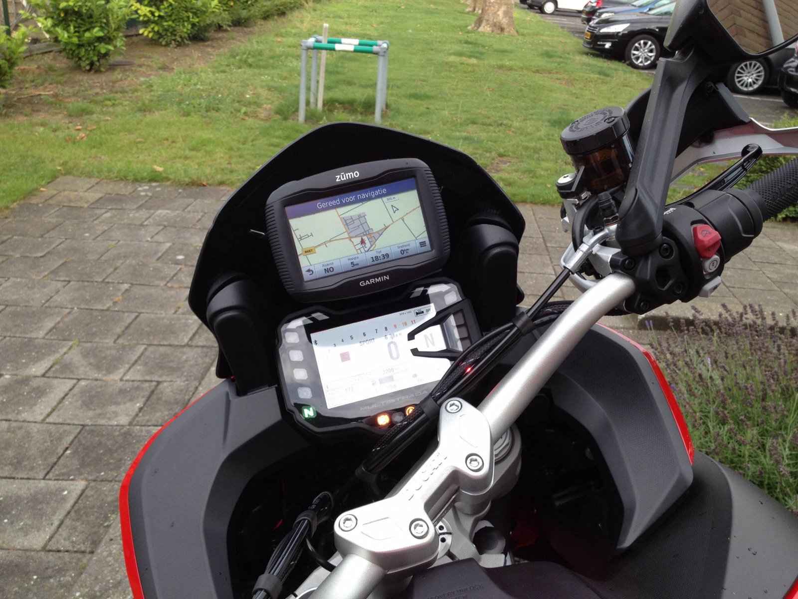

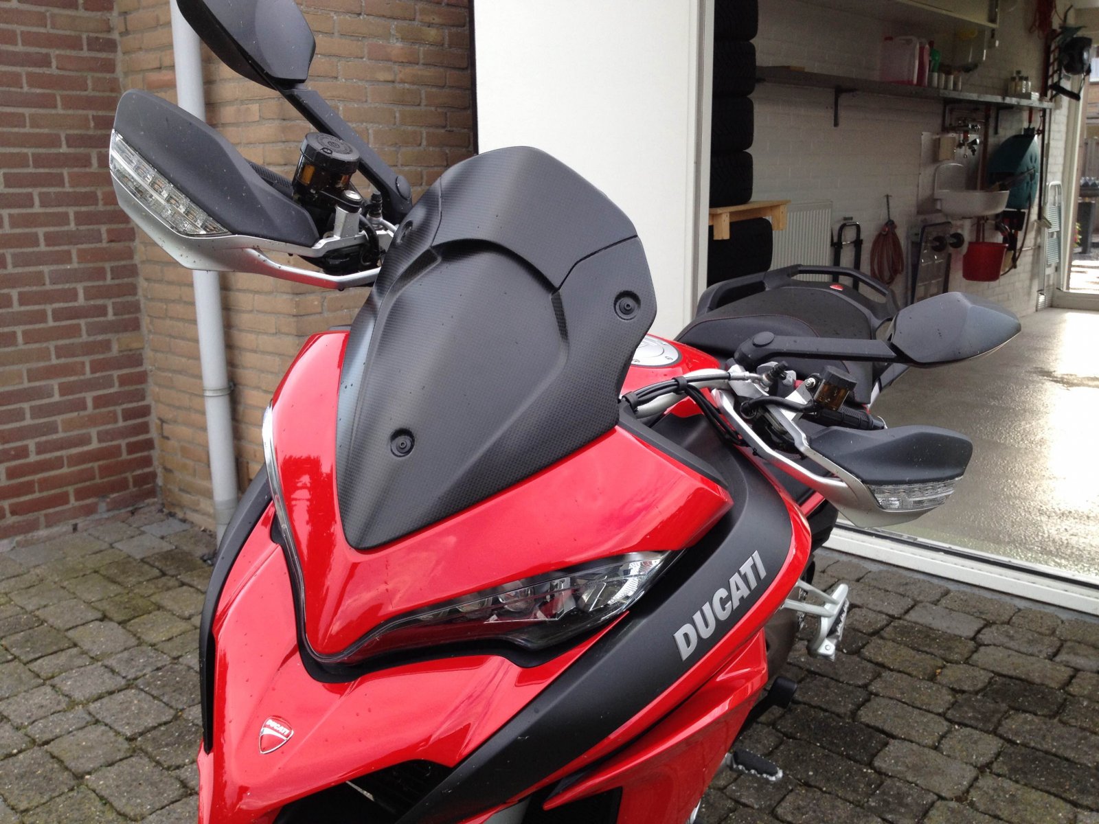

  9. It looks good, I mounted the original carbon wind shield which is also very short and also the nav holder with Zumo which is just behind the screen so protected for rain and wind.
    I think the advantage of this screen is the special shape with some kind of spoiler build in.
    Safe Miles

  10. Looks very good Jabberjaw... I was waiting for the DVT Pikes Peak to come out as I had a PP screen on my Multi GT which looked really good... But I couldn't wait so cut down the standard original screen, which I like a lot!
  11. My be it's me but I can't see or understand the IMPROVEMENT ?
  12. The cut down screen changes the airflow - so that the air hits you at the top of the chest - leaving your head in clean air - so it does not get the turbulance and buffeting and noise that you get with the standard - or touring screen.
    I previously cut down the touring screen after spending £150 to find it made the noise no better / worse.
