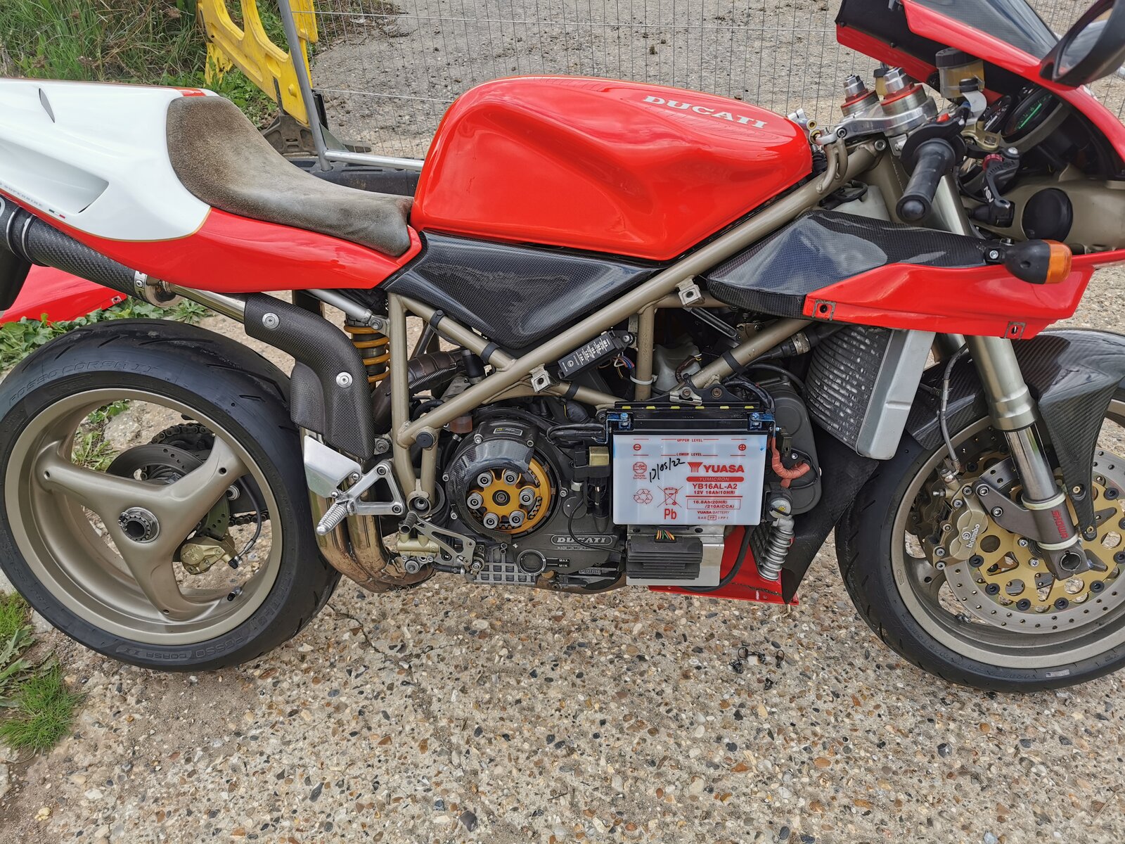

  1. 3 yrs waiting to ride. Quite a few quid spent and it breaks down after 24km on way for first MOT since 2016.... Guessing recrifier

  2. Fairings are nice and easy to remove, battery is very warm to touch?
  3. tbh the battery is always going to get warm on the bike, especially with it's location. Does the bike still run? easiest way to check is to disconnect the stator plug into teh back of the reg rec and measure the AC current (somewhere on here someone will have posted the figures you are looking for) on a 2 wire stator.
    If the stator is outputting enough, then measure the reg rec output to the battery, should be 13.7-14.5 Volt I believe at idle, rising slightly when revving but only slightly, I had a 748 where we were seeing nearly 19v when the bike was revving, and while the reg rec was definately fried, it was fried because the stator had burnt out also, hence why you need to test both.

  4. Could even be the battery itself (that's buggering up the reg/rec)
  5. Because bike on Sorn RAC won't recover, but recovery guy a absolute star & collected 2 x batteries from local bike merchanic and using both (got about 10 miles off each) limped it back to there yard.
