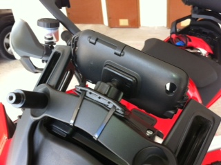

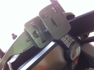

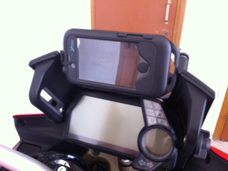

  2. You can try something like this. Have in mind that i' m using Andys wind screen spacers so there is some space between the windscreen and the attachment.
    Make sure that your case fits horizontally between the two wind screeen path bars. (pic - iphone 4 case)
    Flatten the base of the attachment.
    Drill or grind 4 paths for the two cable ties.
    Use the rubber included in the attachment for it to rest on.
    Tie with cable ties.

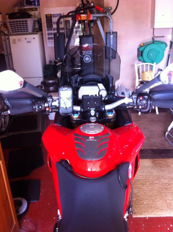

  5. I have the Ducati (Garmin) satnav, but also that iPhone 4 cover, which does keep all but the worst weather out. I personally would struggle to see the iPhone well enough on the bike as a satnav though?
    View attachment 16392 Unfortunately, my iPhone 4 had a recent, terminal interface with a beer in Brussels and my old iPhone 3 doesn't fit in the case!
