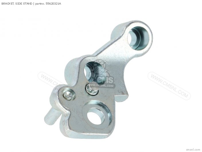

    Hi.
    The 999 one has the pin for the switch at the rear of the bracket as per your pic above, whereas the ST one more commonly has the Pin at the front.
    Stein Dinse have the 999 Bracket 55620321, and the ST3 one 55620201.
    I'm sure there must be another bike that uses the 749/999 one, but the part number may be different if it's painted a different shade of Silver.
  12. yes, the plot thickens as it was Ducati Coventry that suggested an alternative part number (55620201b)* and listed ST3 as an alternative - and not the same as ST2 orST4 - it's a case of trawling through the lot plus going without a sidestand switch isn't world-ending stuff.
